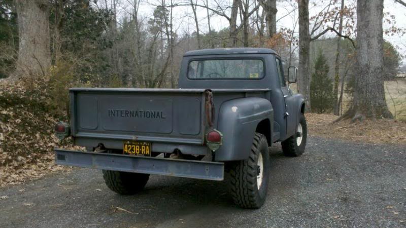

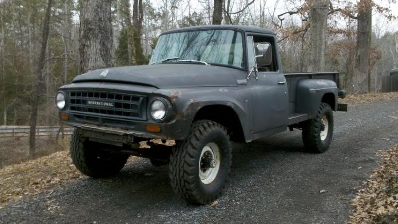

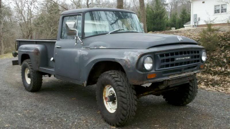

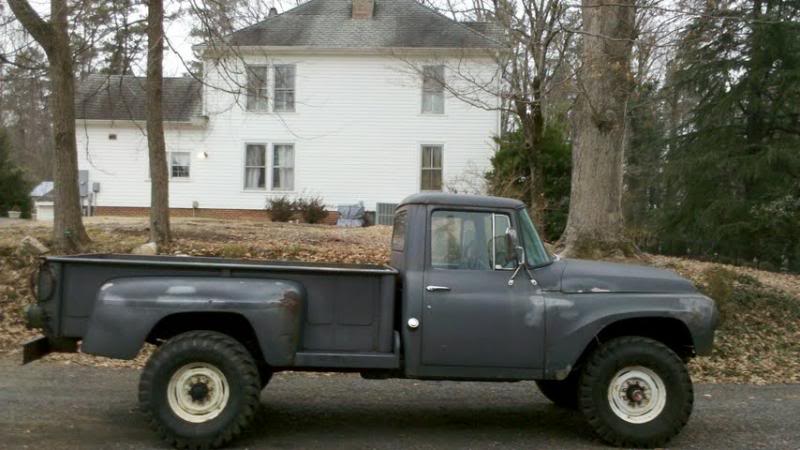

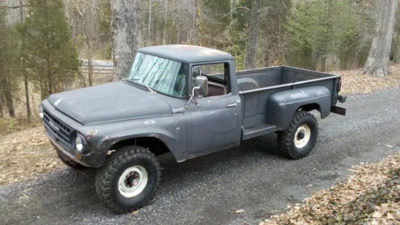

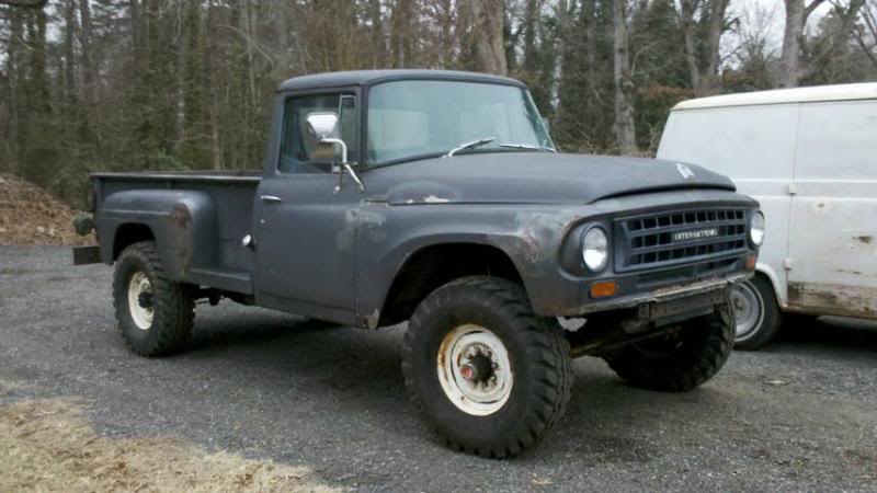

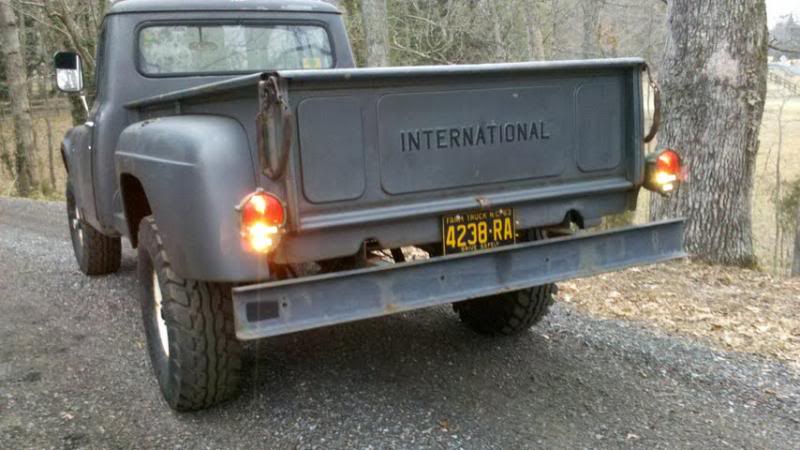

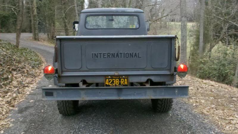

I'm finally driving it!
It tracks great, rides not as rough as you would think, it has low compression in the #1 cylinder but all in all I am very pleased with the mechanicals.
Few pics;
Sorry for all the pics but I'm pretty excited.
Thanks guys.

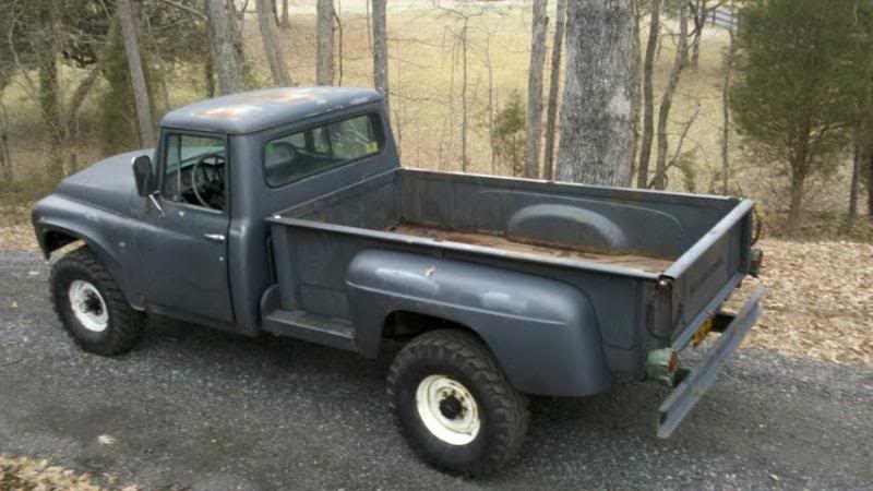

I'm struggling with the condition of the body. It has such little rust but every panel has a dent. The crazy thing is the bed and tailgate are single walled and there are no dents. Crazy!!
I will have this in nice paint soon I hope. Got a lot of work ahead of me.

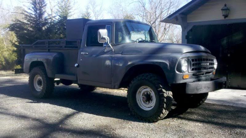

The last 2 days have been consumed by building the front winch bumper. This bumper will not be a high clearance style but a more utilitarian style. I have 2 of those "cow catcher" front end guards. With 2 I am making one. I recessed the winch down inside the bumper and it will have an old square tread plate lid. Both sides below the lights will also be storage areas. I have the bumper and winch plate completed now the guard and storage compartments.
Maybe some pics tomorrow.
Dude, love the truck. My dads first truck was an International. But I gotta bring up one point, I have the same c-channel style bumper, but does anyone else think it would look way cleaner flipped the other way? C facing inwards? Feel free to ignore me if thats how you wanted it.
I agree 100% but that was the way the original owner installed it. So out of respect of a different time and need I'm going to leave it that way but it will be added to. They built things out of necessity not for looks. That's for sure.

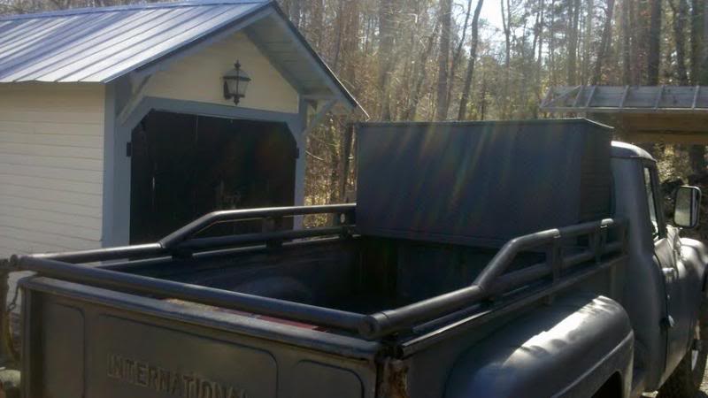

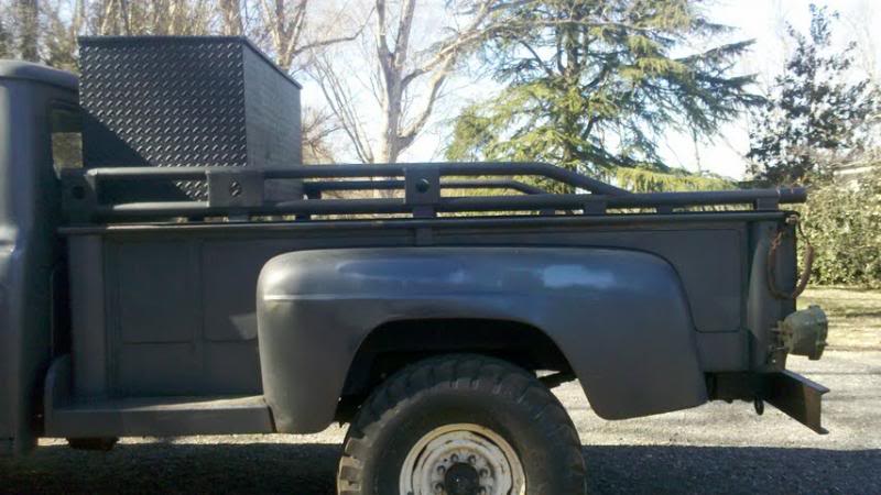

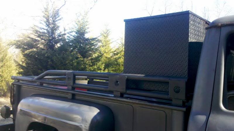

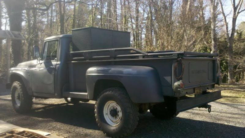

I built side rails and they slip into the side pockets. I also needed a job box of some sort so I found a 6' long X 2' high X 2' deep. I sliced it to 50" long. I attached it to rails that connect to the side rails. It is removable and will not always be on there.
I also fabricated a hitch receiver for the rear bumper and am in the process of building the front winch bumper. I have a few things to complete on the bumper.
