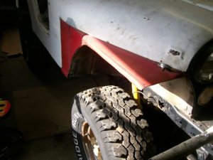

This fender is kinda rough it will need some patch work later.

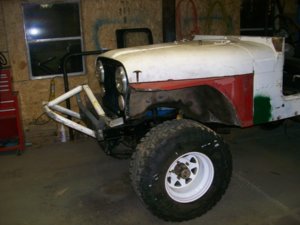

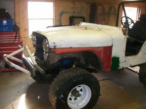

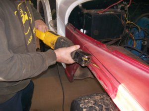

My saw made quick work of these fenders. I like the way it looks with the fenders cut back. We put the hood back on it to see how its going to look. It will look better when I get the pipe work done. I may have to change my bumper now. I'm glad all that pipe was gave to me.
Driver side

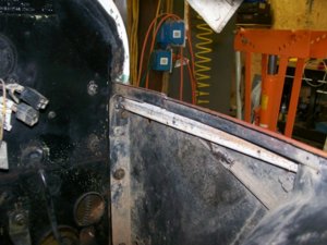

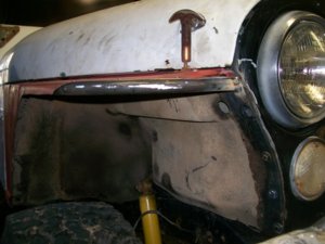

Here is the removable tube I fabricated. It bolts to the radiator support and the cj tub.

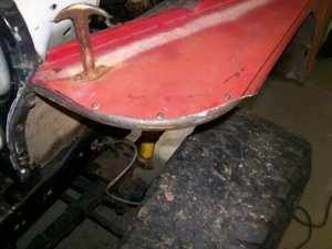

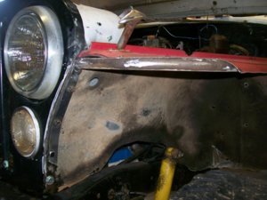

I decided to pop rivet the fender down instead of welding it. so they could be seperated if needed.
passenger side

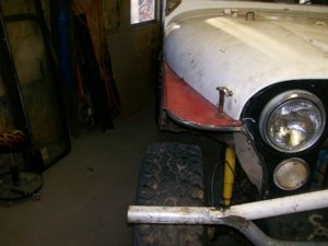

Well I'm done with the fenders I did cut the bumper down and turned the ends up a little. I will sand blast the bars and bumper after I paint the rest of the jeep. I guess I will start under the dash next and finish bolting the rest of the jeep together.
