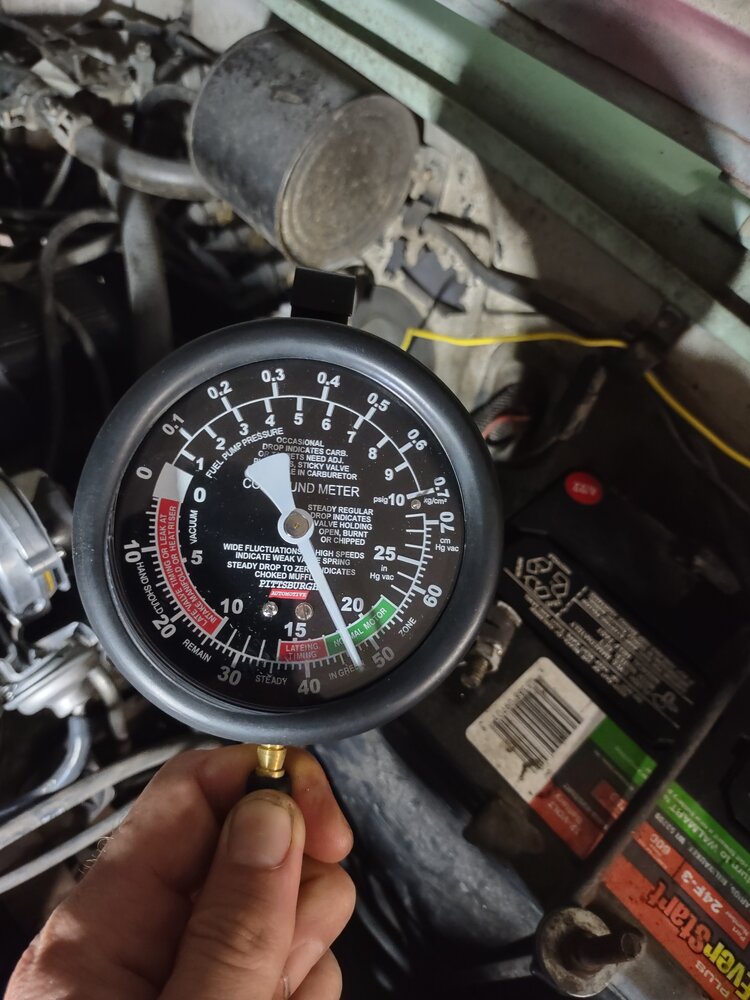

18" of Hg

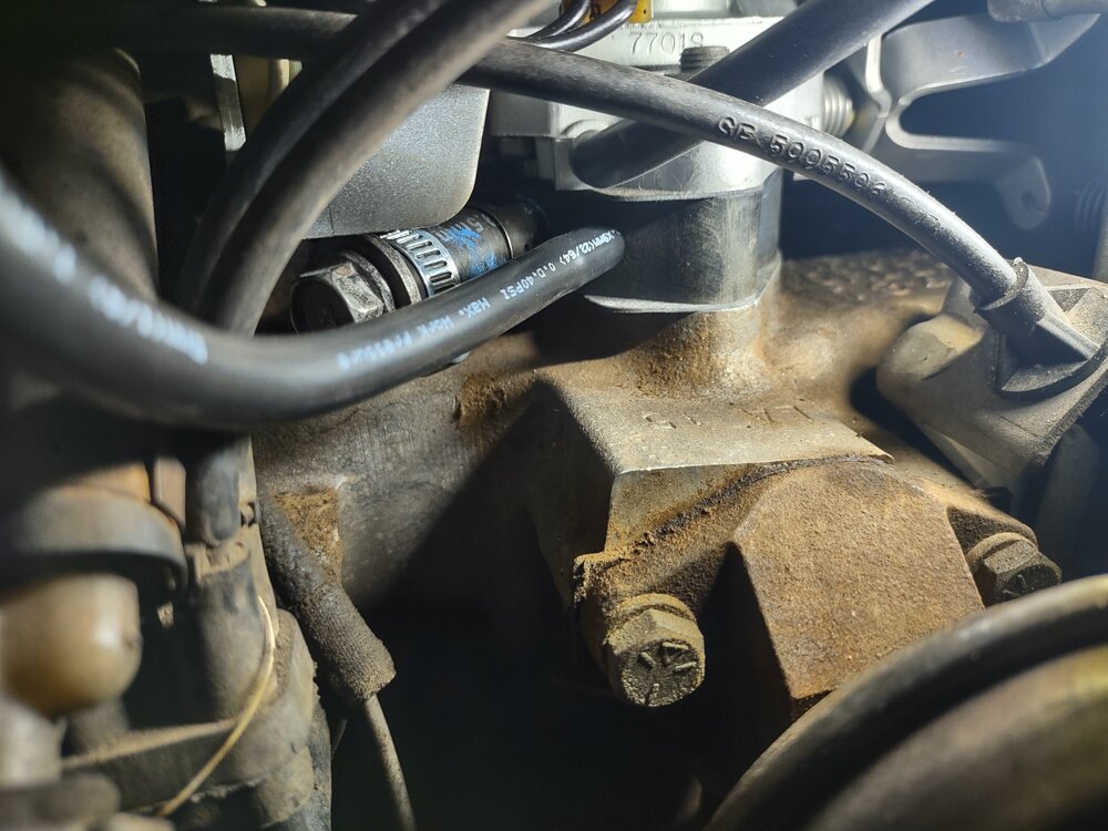

One vacuum line to dizzy, tuned the timing by ear (no stumbles at idle and no knocking under accel)
