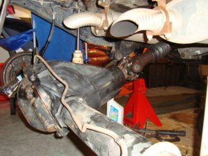

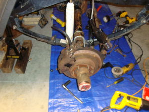

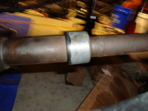

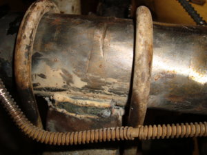

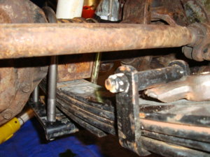

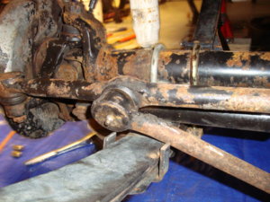

Well I have the rusty, dirty Waggy 44s under the heep... I set my rear pinion pointing directly at my SYE output and I hope it will be ok. I cut the cast perches off the rear and reused them. I heated the axle tubes and the welded them on. This is my first attempt at welding and my welds look like shit but I got good penetration as far as I can tell. I had to buy a conversion u joint for the rear. I have 1/2 inch of travel left in my rear driveshaft at full droop I hope thats enough. I cut the front perch of of the passenger side front and welded it 1/2 inch inward. I filled the spring pin hole on the drivers side and then drilled it 1/2 inch inward. My front driveshaft has about 3/8 left to compress at full droop. I had to cut one of the spring pack clamps to clear the TRE.
