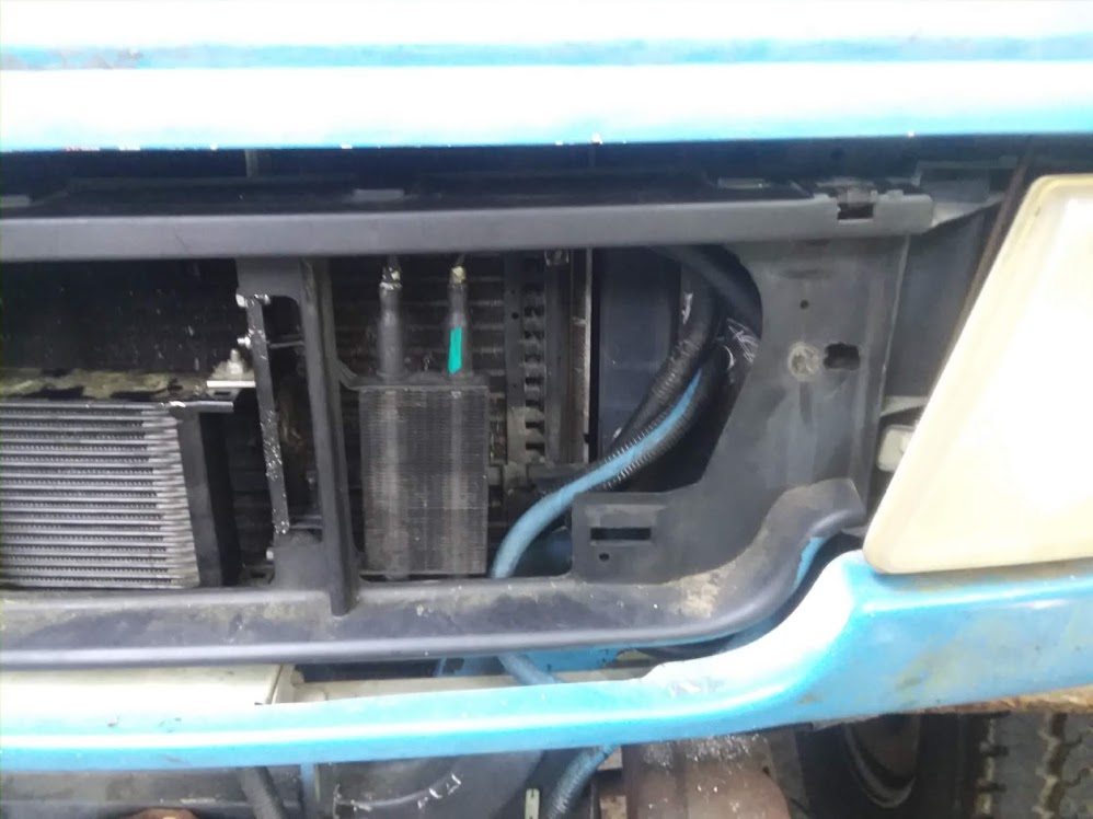

I needed to move the power steering cooler up to the grill,
I had to drill a cople of holes for the lines to run.
And i had a Jic/AN to Inverted flare, it the small one, for the cooler line, (input line)
Then a need some hose the cooler i get at LKQ for like $20, it is aluminum.
done

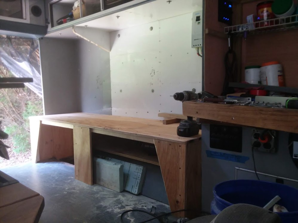

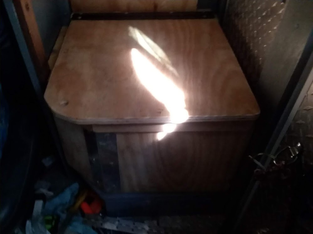

And we have a box surrounding the port-a-lo
AND
Made a bed a wee bit higher that before,
put some storage down below (over the top of the wheel well )

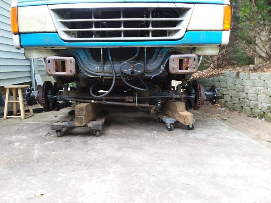

Front Axle - High Pinon Dana 60, 4.10
Still in progress, but I am documenting my work, as i go....
So that people know anyone can do it.

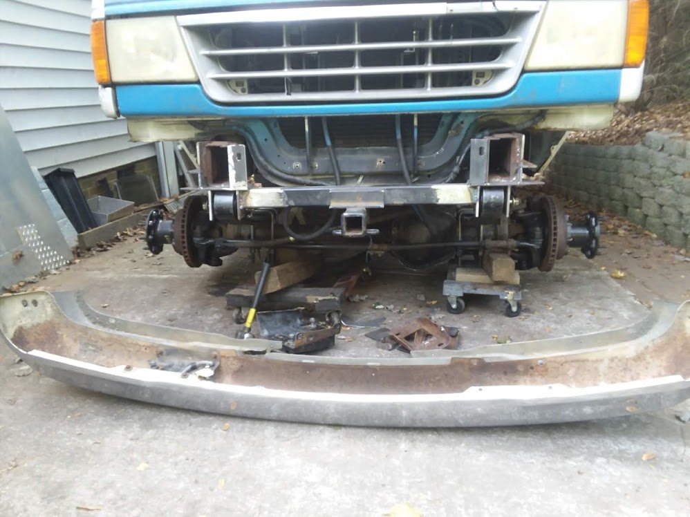

The first step is the front axle and steering.
As i hinted above i removed the odds and ends from down there,
a month ago, getting prepared for this. So...
I have doctor pre-operation appointments spread out, for about 3 weeks,
and then, hip surgery (replacement), so.....the last 'rush' (ha ha) for me to get all these things done.
Today damn Dr. appointment at 2:00 pm, just about ruin the whole day.....
And that means, no go, on the CTB or the SHOP activity, :(

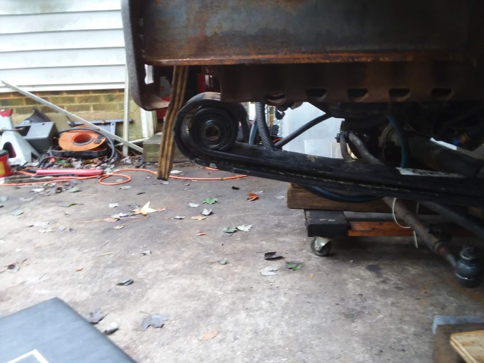

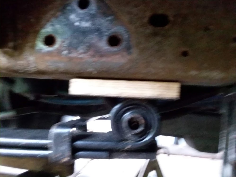

All the weight is off the jack stand, and i have a spacer (wood) in there too...
The leaf is flat !!!! Told you......
The last one is my carving out for the leaf spring bushing,
Next step is the front....
Its been resting on another piece of wood...
Need to wait until my u-bolt show up before i make the next decision,
how far up i can move the front of the leafs.....
:flipoff2:

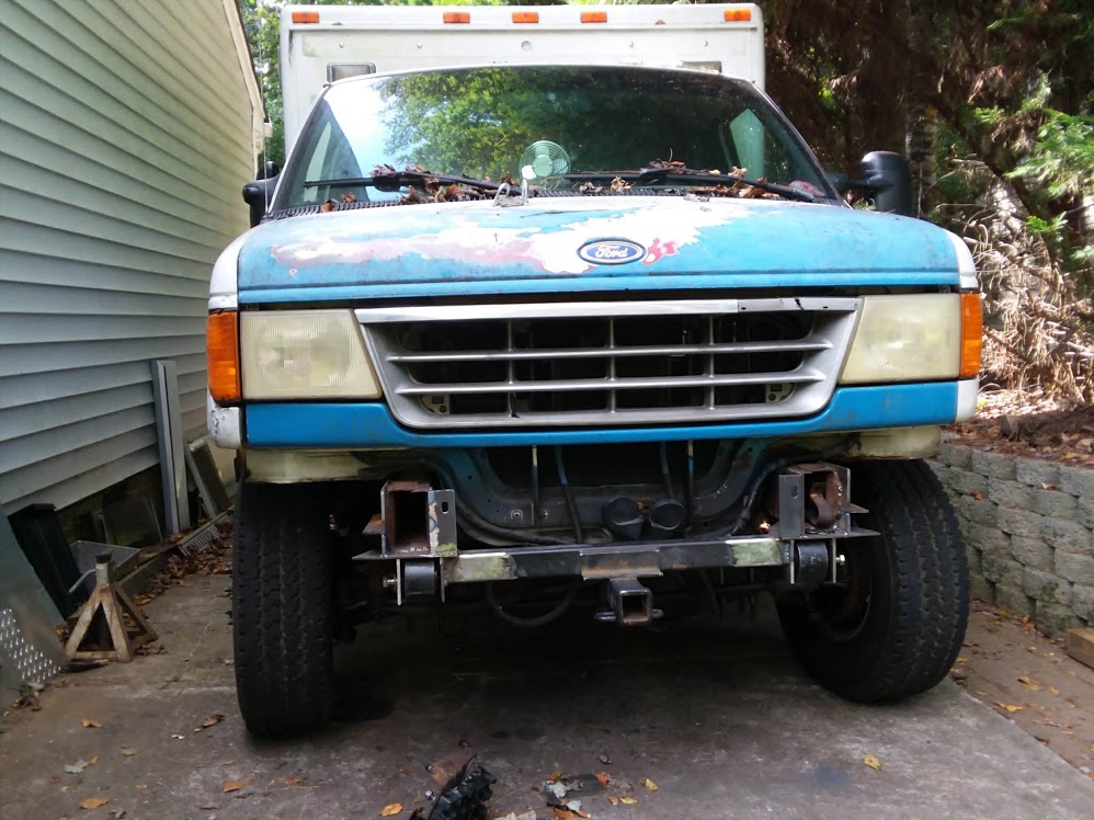

Its on the wheels.....
Settling the springs out a bit... It came down a 1/2" last night. (nice!)

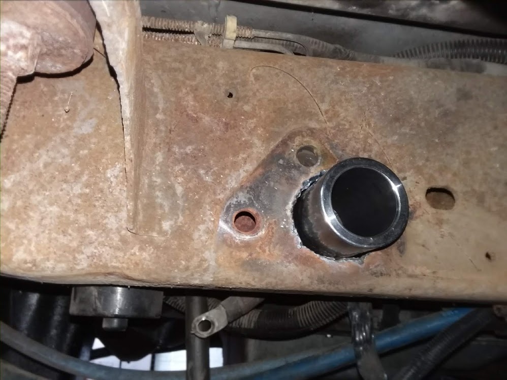

Had to get a tank for the welder
I need to put in a few brackets around the front area.
-Still need to figure out which shocks in will run
-Still need to figure out the steering arm,
I have bought a F350 arm i need to messeugh(sp) it a little
- Bumper brackets front
[i am using the factory brake lines/hoses, the fit great.]

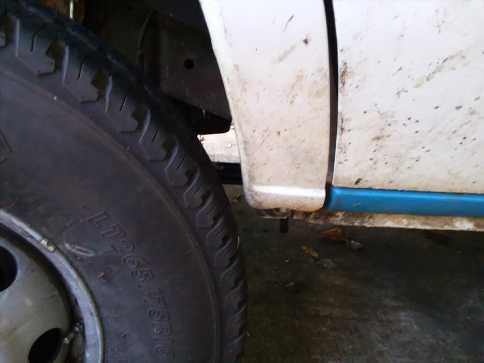

And most of all i didn't have a move the horn !
Other pic, shows the room that the tire has room.
