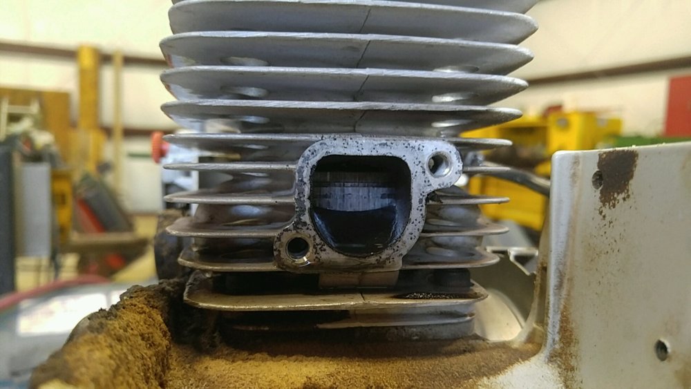

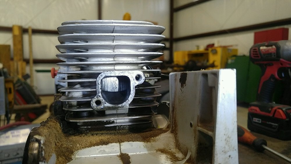

No broke rings. Definitely not straight gas. It broke free right after removing the starter pull assembly. Rings was full gummed stuck in the piston grooves and scored as well. Jug is scored as well. I have replaced a saw piston and rings before because of severe lack of compression. That saw was worked for years and was tired. It had typical signs of blow by and carbon down its length.
This one is spotless.....all but the pesky brail on the exhaust port. It matches the port size width dead on. That I find odd as well! Muffler clear and clean inside too.
Leaning out will cause that. So will insufficiently mixed oil in the fuel.. klotz super techniplate or r50 will prevent that as it stays in suspension (and runs to heat, not away) typical failure.

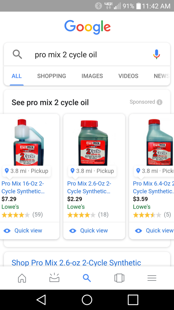

That stuff from Lowes is fine. Is it Klotz or Amsoil? No but as long as the mix and fuel quality is good, fuckin run it. I tinker on 2 stroke stuff all the time and finally had one of my free "Im sure its blown up so you can have it" saws take a shit. Amsoil Dominator is what was in it. Crank seal was the culprit. Threw that old ass poulan in the trash and grabbed the other one :lol:
Screenshot_2018-07-30-11-42-18.png This stuff.
It (might ) clean up , echo has got real thick plating . I've vac and press test stuff here in Asheboro. .. it kinda looks like a slow lean seize , bad fuel ,cheap oil , dull chain , high ambient Temps ,dirty filter...bad recipe , also could be a torn intake boot etc ...but I've never been in a 8000 echo so unfamiliar with intake setup
