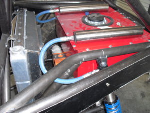

Does the car seat go over the fuel cell?
a little more

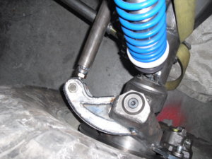

School me on the straight upper rear links. Why not triangulate them?
nice looking rig....congrats on the munchkin....
straight links are via what i needed to do for up travel and using the mounting options i wanted for less snags on the chassis. Jimmy' off road uses it all the time.. so i figure it must work..

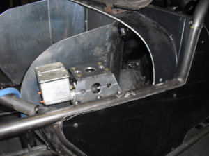

Steering and brake master cyl

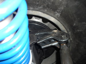

I can't take credit for building them.. They are modified though.. thanks.
it was welded with a mig gun.. They are new from jimmys for the spider nines..

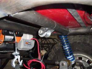

I'm sure you know but that cable on that 1700 winch isn't worth a damn. Mine has broken 3 times on 2 trips...
yep, i use syn rope. are u using a pulley? thanks
I've had cables snap on mine but they always pulled and bent the winch to useless before they do. Cause I'd suck it in and then forget to let it out...or didn't let it out all the way so it became the limit strap...After the third time I just stopped hooking it up.
