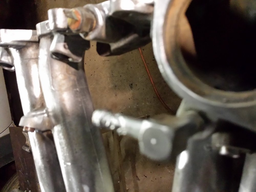

Could sombody with a 22re tell me where the coolant hose on the tstat housing goes? Its a 3/8" line i think.
I mean the smaller line kindof off the side that nasty looking hole in the picture is where the thermostat sitsStraight to the top of the radiator, pretty sure at least I'd have to go outside and look. The diameter is 1 1/2", you sure about the hose?
Yep, IAC/TB are more accurate names than the Air Intake, thanks for the clarification .That goes to the IACV on the bottom of the TB. That hose looks kinda like a P.
im running propane with an efi manifoldUnless you are changing over from EFI/carb to propane, you will need it. The IAC valve on the TB must have the coolant running thru it to operate. Otherwise you will be getting too much air thru the TB to run after the engine warms up.
Ive been looking into getting rid of this, all i need is a throttle blade to open and close haha ill have some time tommorow to work on it if i get my other stuff doneGotcha.
