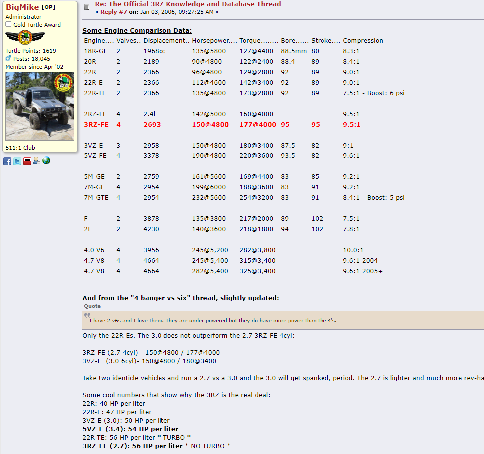

Based on the little bit of research I've done, sounds like the 3rz may edge out the 5vz.
With the 5vz, you gotta do a hood scoop or body lift like @frankenyoter did on his Little Blue Truck build. From what I understand, it also doesn't bolt up to the W-series trans like the 3rz does and the 3rz is obviously lighter bc -2 cylinders.
So, other than the +40hp off the top, what do you see as the advantage of a 3.4 over 2.7? I get it...it's +40hp, but how much is that offset by the add'l weight?
Some numbers from the Marlin Crawler board for reference (The Official 3RZ Knowledge and Database Thread). Specs at bottom for better apples to apples on power.
