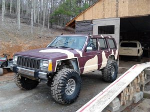

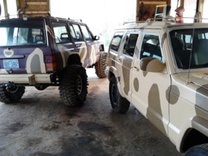

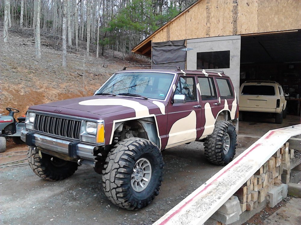

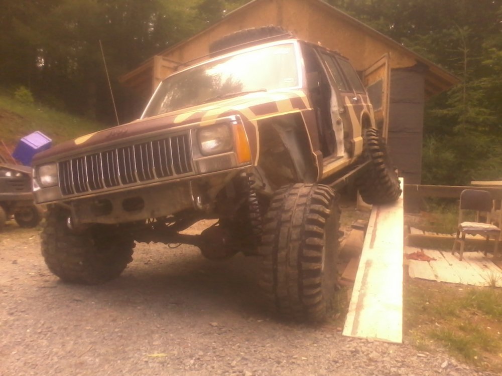

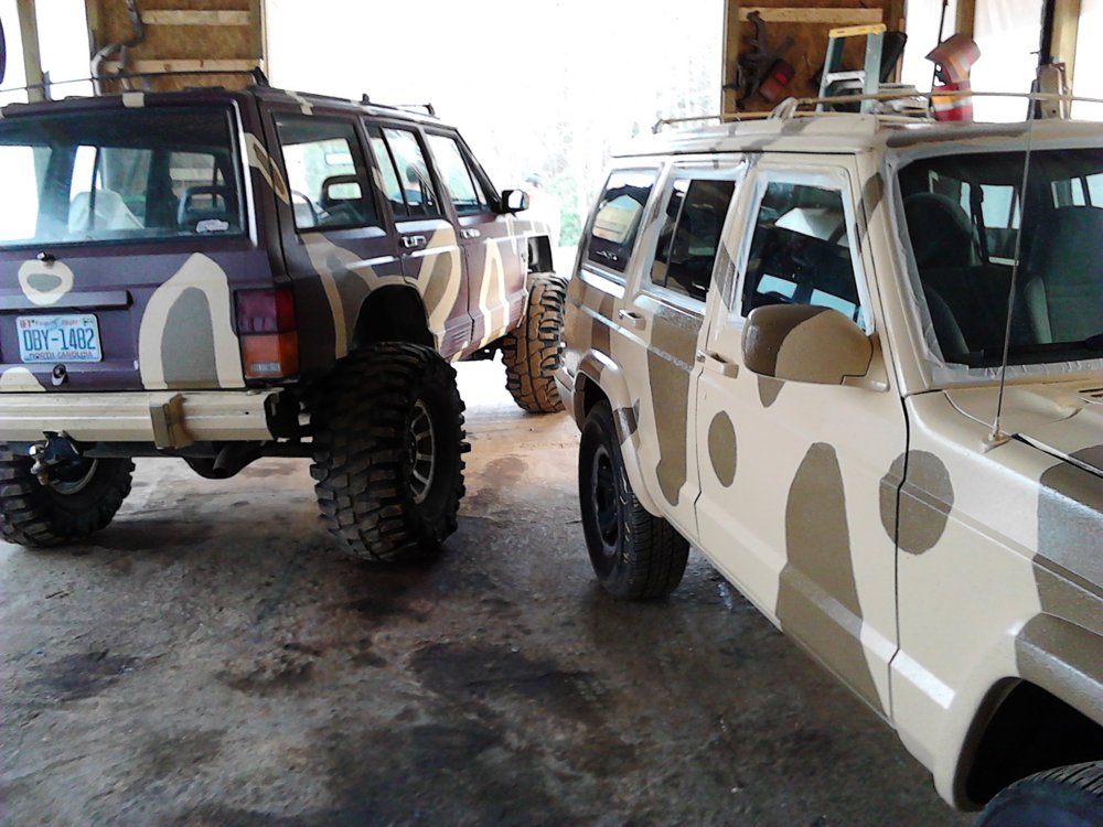

heres some...sorry I promise i'm not trying to show my jeep off man, its the only pictures i have with shop and ramp in the background...i can get you some good pics tomorrow...siding is ...well i've been too lazy to put it on, will get put on before winter T-111 is what i got for it. the ramp is railroad ties anchored in the ground with 5/8"x3ft rebar after leveling of course, 6x6 PT blocks in between each layer...3 layers total, then 2x12 on top but wasn't wide enough so i got rough cut actual 2x12s and used short and long log ollies to fasten everything....has 6x6 tie it together in front and middle...i've had a 2500 suburban up there no problem and shook the hell out of it trying to get the ramp to move and nada...so i'm happy. eventually will go little higher or dig down foot or so, pour slab and stand up working since my knees are kinda bad!!
