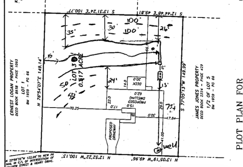

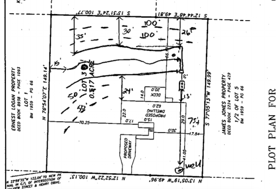

Anybody know how to read the septic map on this to know if you can put a garage to the left of the house when looking at it? Trying to figure if a few feet off the house you could fit a 24x40 going towards the back yard.
http://gisasp2.wakegov.com/imaps/RequestedPermit.aspx?permit=D040073
Doesn't look like you have much room to put anything up with the notes repair areas (dotted lines)
Your current system is the 3, 100' solid lines. The repair area is both of the dotted lines as the two at the top are 2/3 of the lines and the two near the side yard are the other 1/3 (2, 50' lines there).
Not sure why it was built like this. It will be a PITA to install the new system. Seems like the installer was drunk when he installed. That, or there are trees which they wanted to keep as long as possible.
There are some trees back there I guess they wanted to avoid. How annoying, its a half acre lot you think they would figure out a better way to do it.
