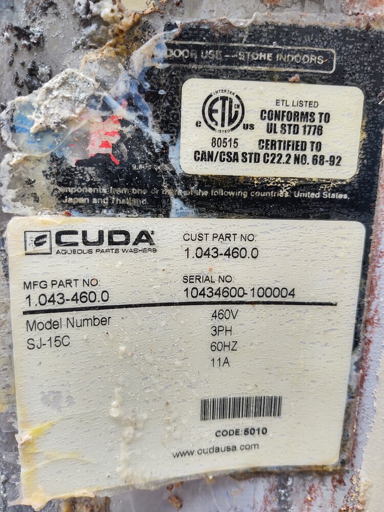

Got a shot at a parts washer that would be super useful in my shop. Problem is it is 3 phase, my shop is wired for single phase
Here's the ID tag on the washer in question.
What am I looking at to convert this to single 220 for use in my shop? This is a long term tool, so I'm not opposed to spending a little money. But how much it would cost will dictate how good a deal the washer actually is.
You would need a phase converter to provide 3phase power, and a step up transformer to get 460v. I'd guess $500-800 range for both if you shop around. If your shop is in an industrial area, it might be really easy to get 3 phase direct from the power company also.
I'm guessing it's just a pump and maybe a spinner or agitator motor, you might would be better off to swap them out since it's a pretty low load and small motor.
Transformer might be more than I remember. You used to could pick em up for a couple hundred bucks. But now they appear to be a lot more. Also, I just looked up the specs, and the 230v single phase version of that machine is 38 amps, so you may need a bigger phase converter than I was thinking. I figured a $5-600ish phase converter and $100-200 transformer. But probably at least double that.

AR 5 is rated for 7 amps - his machine says it draws 11a.
Now maybe that’s max heat and max circ and there could be a way to limit the heat output… but gut feel is the ar5 isn’t big enough. At best it’s marginally big enough and will never satisfy a baller like Sir Treadway

Says it's a 3hp motor and there's a 90% chance it can be rewired low voltage so that rpc would work, the heating element you'd probably have to buy the correct one for single phase low voltage, 3 ph heating elements are wired differently than single ph and you'd only have half the heat going from 460 to 240 then probably a third of that because likely only one element would be working. You could ask cuda about buying a single phase element set

In other words, the simplest answer is probably a 20hp phase converter, but at like $2000, and you still need a step up transformer.
But you can also fiddle with it, and find a way to make it work a lot cheaper.
Smartest thing would probably be to just find a single phase version. End up at the same final cost if you value your time.

The pump itself probably doesn't pull many amps, the heating elements being pure resistance loads don't care about phase you could rewire them in a single phase configuration but you'd still only have half the heat... which might be enough? Maybe worth a try, Jody needs a phase converter so he can buy a Bridgeport anyway

Gonna pass on it.
The added cost and aggravation offsets the good price. Even if I added 3 phase to my shop (commercial location) when I build a shop at my house, it won't be 3 phase
