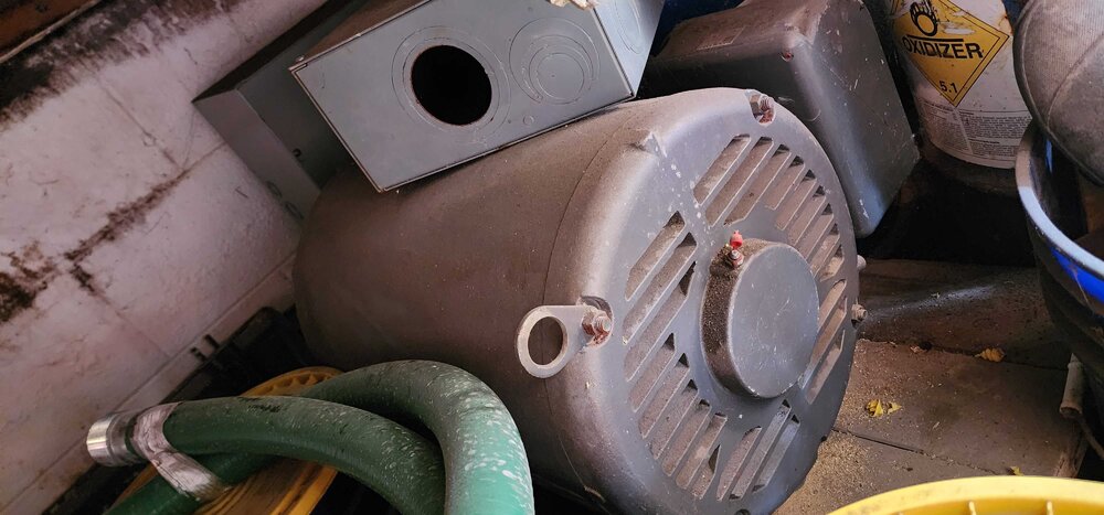

These rotary style phase converters are heavy af and LOUD af. Switched to VFDs while back and now its only as loud as a walmart fan, lol.

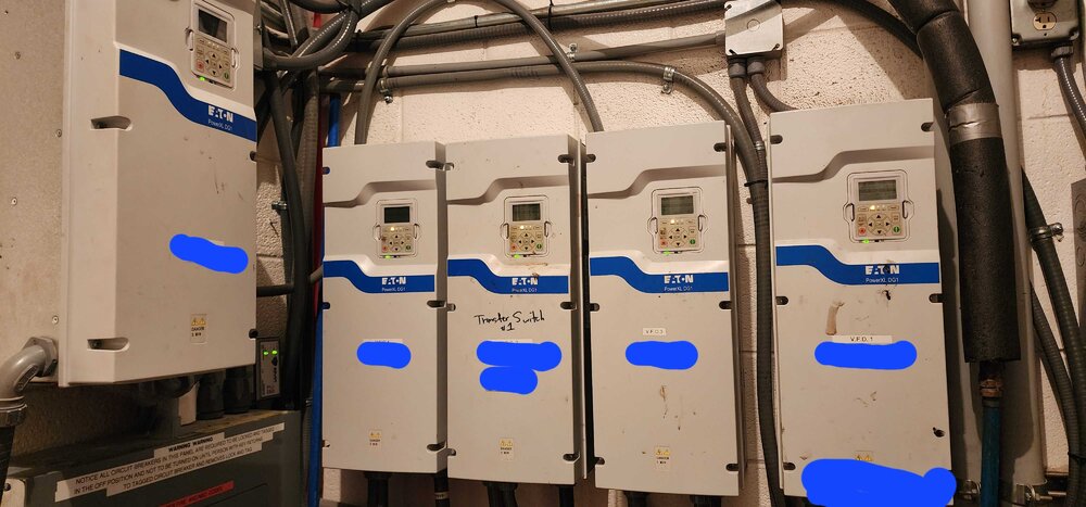

I have a few of those Eaton powerflex vfds and they have a super annoying feature where after xxxxhrs they indicate a fault and say to replace the cooling fan. I haven't figured out how to make it go away.... Haven't actually tried changing a fan though 😂
