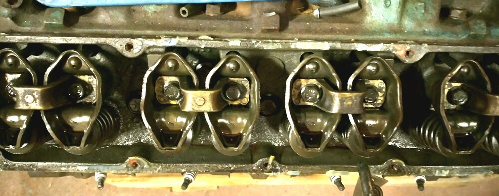

Here is my clean 150K mileage, 79, 304, rockers.

Honestly I have not had time to pull a valve cover and take a pic, but my valve train consists of rocker studs that are 3/8" with 1/2" shoulders. There are no bridges in conecting my rockers. The hole in the rocker is large enough to fit over the 1/2 shoulder part. I am able to buy stock replacement rockers from Advance but that is the arm only (no pivot included). I really feel like I need a full set of arms, nuts and pivots, but no one sells that for my engine.
At the moment the engine is running just fine, but the valves are clicking like crazy.
