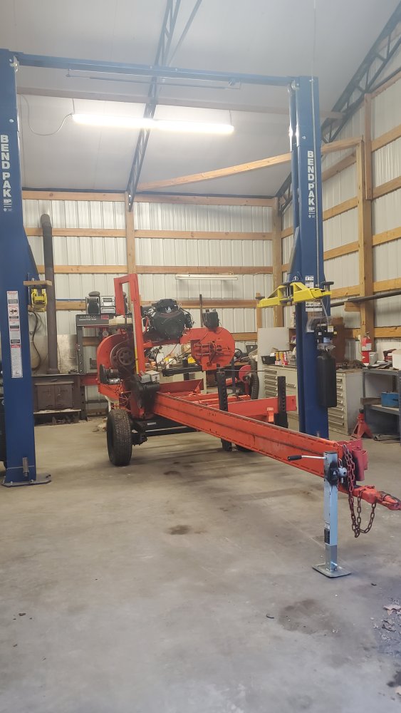

Are you extending the bed? Pretty jealous as I have been watching way to many sawmill videos lately.
No, just some long overdue maintenance, adding some rollers on the backstops, and a larger watertank. Haven't even thought about extending the bed. Now you've sent me down a rabbit hole! But it will already do something like 16'4", and with the natural taper in most logs, there's really no need for more. If you wanna buy it before I go through it, PM me :D But I'm not looking to sail it, so the price won't be super cheap ;)

If you will fix all the things then you can borrow it and keep it until they are fixed, or 1 week, whichever comes first.
Haha. Maybe I will just borrow/rent it from you, time to time? Not like I currently have a good way to load/move a big log, but i do have plenty of down trees I could see making into lumber.
