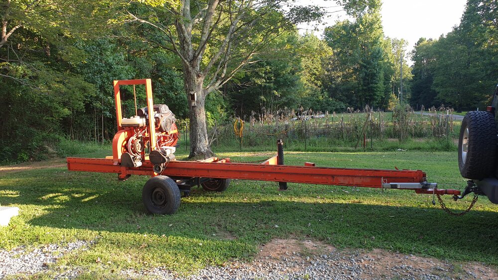

Get what you can and we can grind and drill it into what you need. It's not rocket science. Ironically look at what's now at my shop. She will be purring by tomorrow afternoon ready to make lots of slabs or whatever I want to practice on. Matt is the bestest friend.
