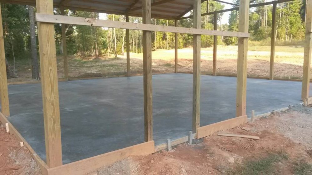

How did you set your post. I've done some reading online and there seems to be a lot of opinions on how to do it. Some say concrete under and around others say no concrete.

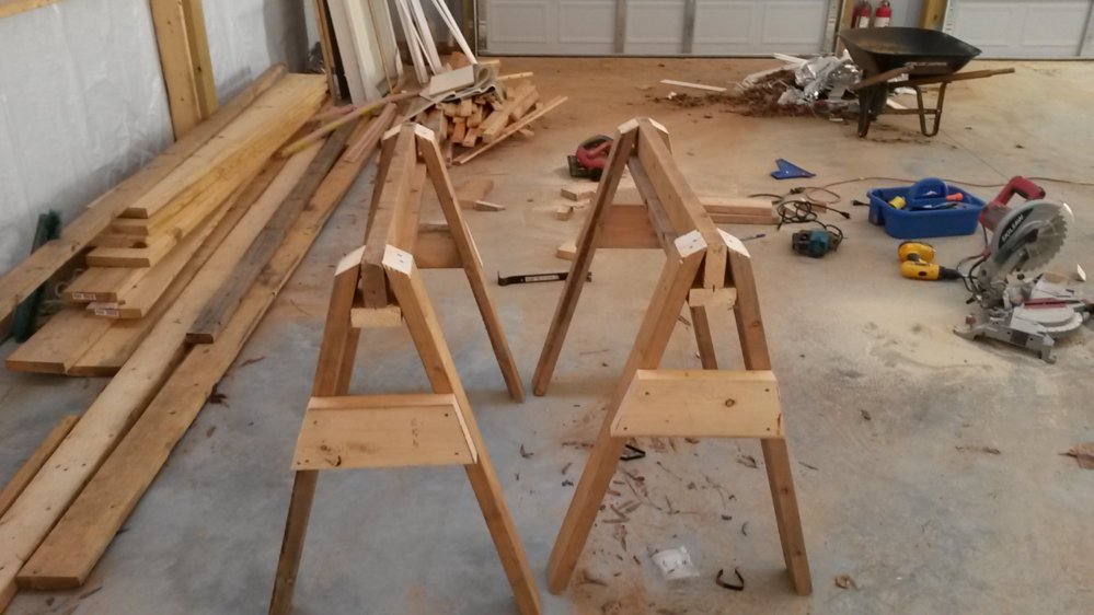

I was tied to the plans that the kit company gave me because I pulled a permit to build. So I went with a solid concrete block under the pole and 18 inches up from the bottom with concrete.
Using the scrap left overs.

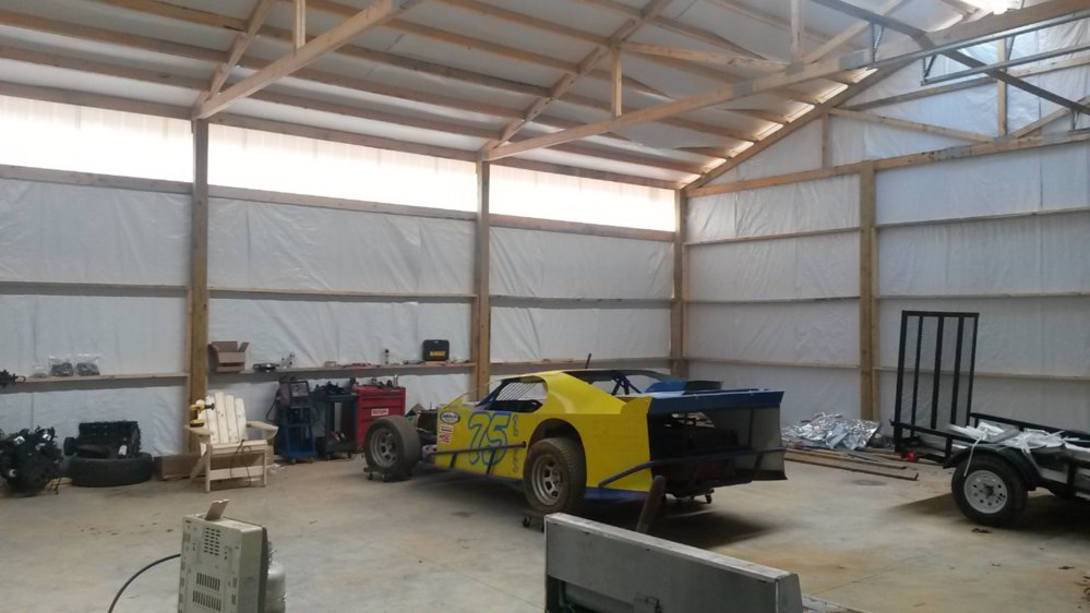

Dang, the translucent wall panels really make a difference. That one pic alone almost makes me want to cut a section out of my shop wall to replace with the panels.
Shop looks great.
