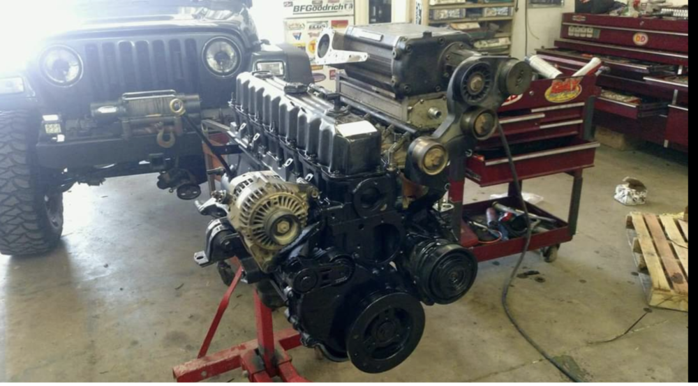

There's a couple ways to stroke a 4.0. You can use 4.2 crank and rods along with 4.0 pistons for one. But you end up with the potential for detonation due to top of of piston travel in relation to deck height not being ideal. You can either deal with it or deck the block. I've done quite a few this way without issue.
Another way is to use a 4.2 crank and 4.0 rods. Along with them you use stroker specific pistons with a relocated wrist pin hole to make up for the difference in piston vs deck height. The bonus is you are using much newer rods compared to 4.2 rods. The last handful of strokers I've built were done this way.
Just food for thought.
