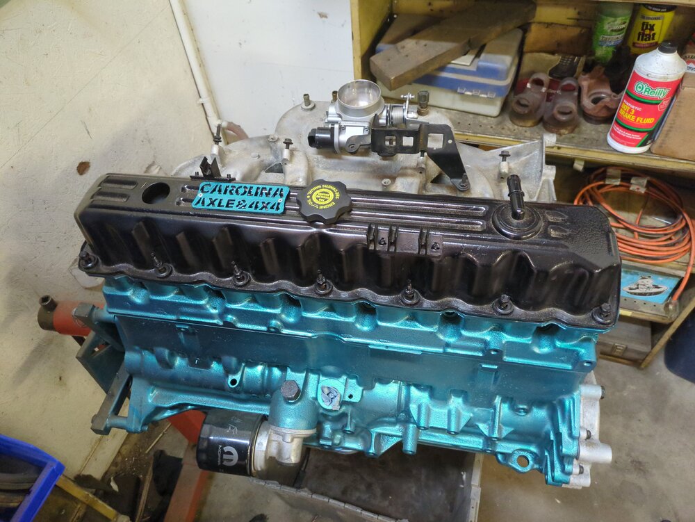

I have a 258 crank and rods and a couple spare 4.0's. I've dreamed of building a stroker but the only engine work I have ever done is head gasket. I also don't have a clean shop!
Don’t be intimidated, i managed to get mine together as an idiot college student, anyone can.
Micrometer plastigauge and torquewrench is about all you need.
I’ll find the link to book with all torque specs and post it later
If you have a set of bore brushes, they're good to have. You can borrow a set from somebody (maybe even AutoZone??) if needed.
