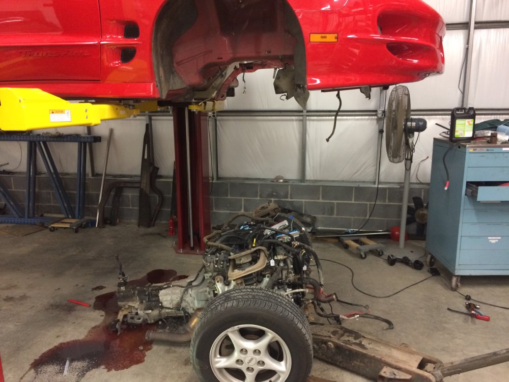

I have dropped axles and transmissions out of cars and trucks with my transmission jack and not felt to scared, but I do utilize safety stands for anything sketchy. I removed the whole front cradle, engine, and six speed out of a firebird when we started my dads LS swap and that was dang nice.

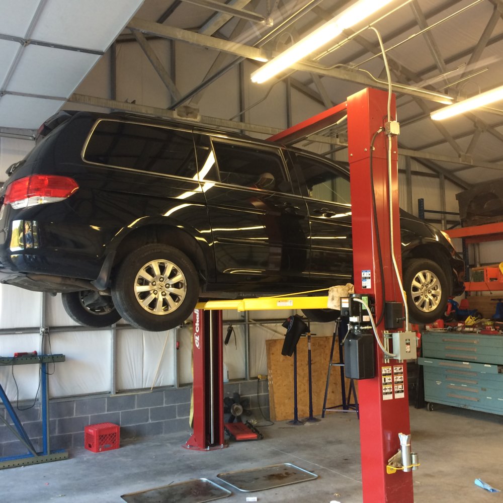

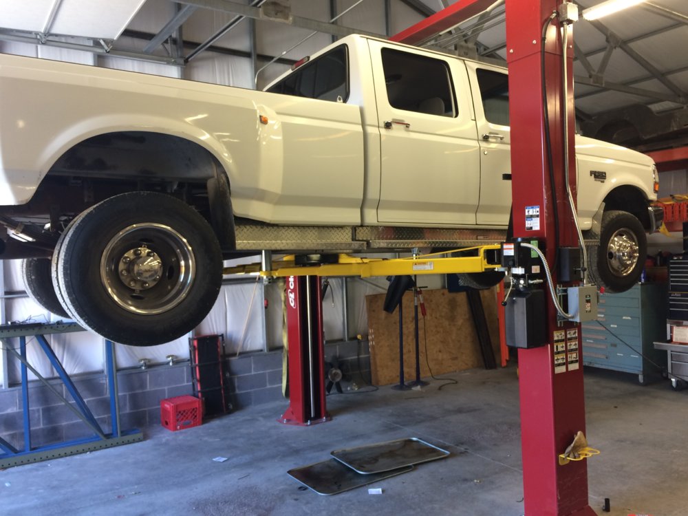

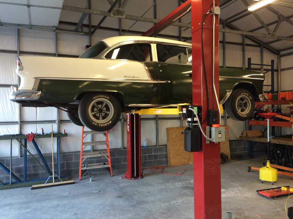

I guess I will put up a picture or two. I have had everything from a Miata to a 4 door ford truck in it. Surprisingly to me, small cars are harder to get lined up correctly.
