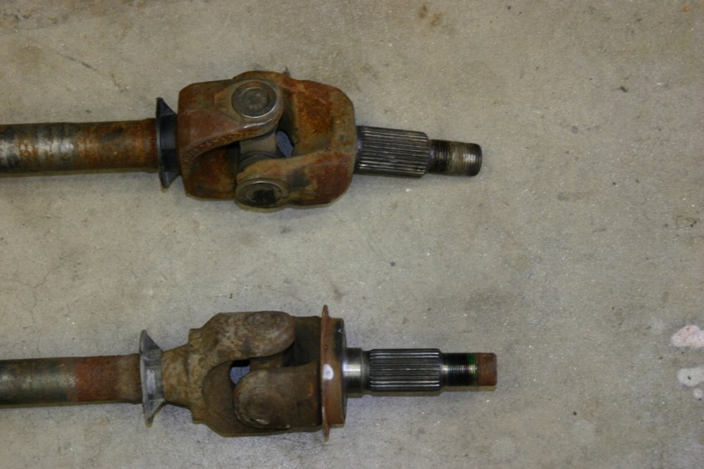

Top is a JKd44 front shaft, bottom is a d30 shaft. Both are factory so again don't say that it's just a different center section. When there are a lot more differences.
