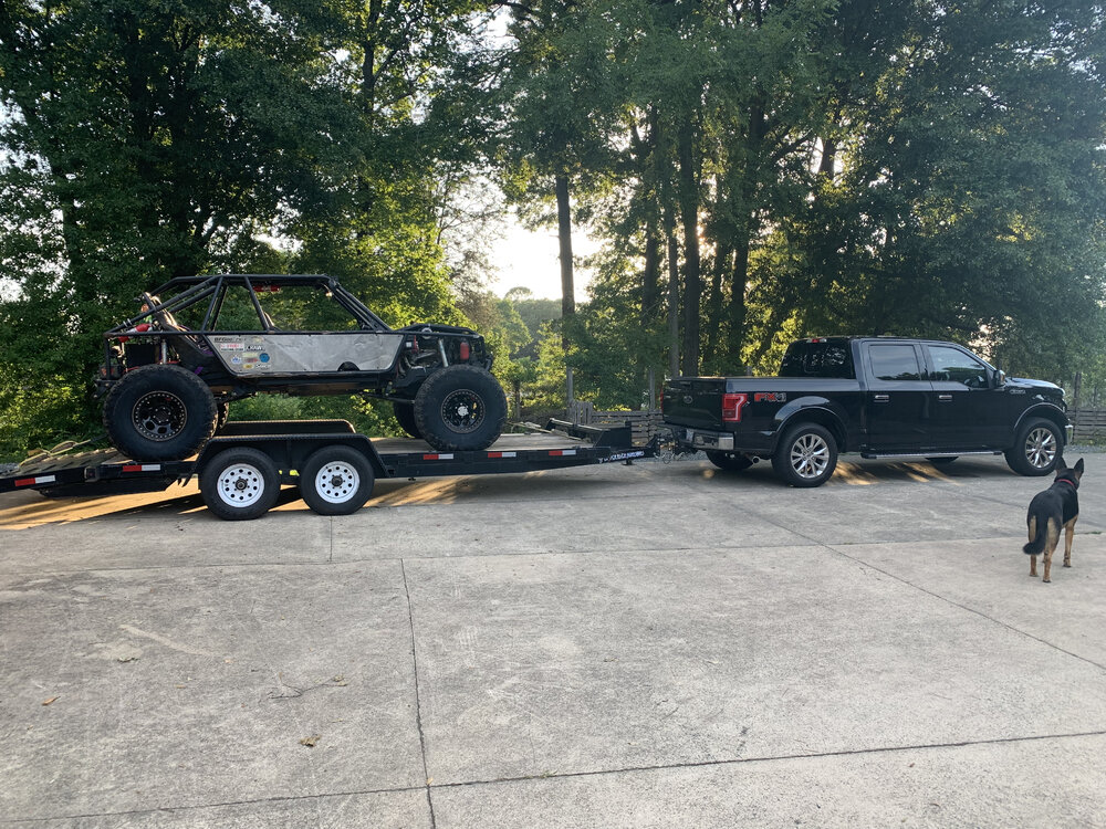

I have a 16 F150 lariat crew cab with the 5.0 and 59k miles. I love it. Bought mine almost 3 years ago with 22k miles. I daily drive it and use it to tow my 20’ car hauler with my buggy and a truck bed full of gear. I don’t have a single complaint.

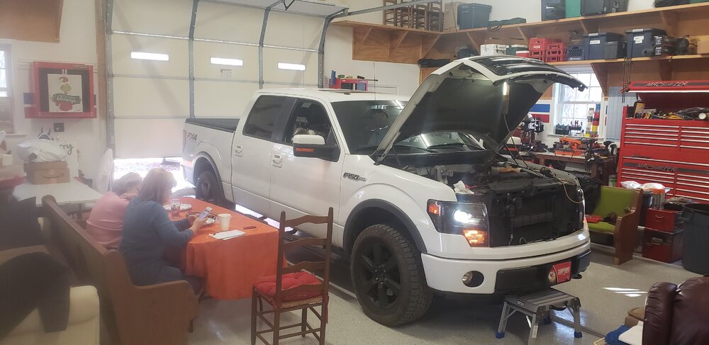

BIL's 2013 "FX4" CC 6spd automagic (white/blacked out) is a dang nice truck, but arrived Saturday week puking coolant.
We both assumed the waterpump, given the limited sight, and grabbed a NEW one locally.
After removing the intake plenum, found it was only a $5 O-ring ($20 for the set of 4) at the "Y"... <1 beer and only used a single nutdriver & 1 screwdriver 🤣
Those upper radiator hose Y connectors are notorious for leaking. I did, however, put a water pump on my BIL's 2013 F150 at 110,000 miles. It was toast. I heard it making noise one day and popped the hood to look. He nor my sister ever noticed the noise or the coolant leak. Go figure...
That being said, they are considerably easier to work on than any 5.4 ever thought about being! I was done and filling it back up with coolant in about an hour. Spark plugs are super easy as well.
