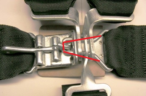

Angles or not, you were in a situation where the upper and lower straps were both under load, and if those two straps are under load and the plates are close together then they load the central plate in shear and it can't come free. That's not really common, but it's probably not hard to replicate when you're hanging from the harnesses so the two left straps are loaded in opposite directions.
It's like supporting something heavy from an eye hook attached to a cable using a shear pin, and trying to pull the shear pin free under load.
Sure, cam locks can get dirty, but they don't have that shear release problem.
awww.soloperformance.com_assets_images_ProductImages_pyrotect_harnesses_5PTLatchLinkCloseup.jpg
So if you look at that picture, visualize what happens when the left and sub belts are loaded in opposite directions, and won't let the left side lap plate pull out from between them because it's loaded in shear.
It would be extremely unlikely for the right side to be loaded symmetrical to the left at the same time, so the right side would likely always release without fail when upside down, etc.
That's not necessarily true, as it would be easy to still have enough friction to bite and bind along the angled sides. But it would likely reduce it from happening as easily.

Under the same load directions, that may just cause the right shoulder to not release. The normal way is fine, and it's a strange combination of loads and directions that would cause the left sides to not release.
