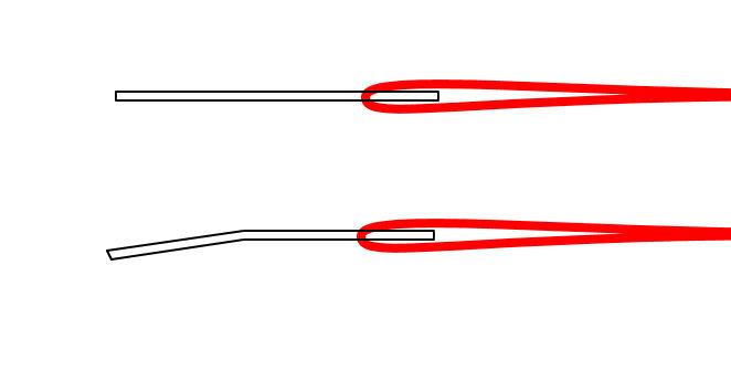

As someone who was in racing near 30 years, been upside down in two race cars, and turned over 30 times in the Jeep, (that reads...'fat guy hanging in belts'...worst condition possible for any type harness!) I have NEVER had so much as a hitch in a latch-type harness. I cant imagine there being any fix for this because I cant imagine there is any reason properly installed latch type harness would ever hang up. They slide in...they slide out. (And I havent worn an anti-sub belt outside of a race car)
That being said...there would only be one possible reason one might hang up.
I have seen two styles of "loop" ends. Both straight style and a slightly bent style. If the "loop" end was a bent style like the lower picture and "loop" side was installed upside down, That would def tend to hang up!

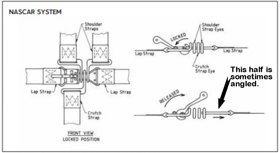

I've only ever seen the crotch between the two shoulders, and you should assemble it per manufacturer design. I don't think assembly order is going to affect much with the weird set of conditions that makes this happen.
I just spoke to John Crow. They did not know this was a possible problem. They are looking into this and going to try to duplicate the problem today. He suggested that my idea of putting crotch strap on last might help and he will also look into the idea of and angled connection bar. I'm excited they are responding in such a helpful way.
There are slightly different latch and link designs for different manufacturers, so this may be a case of small design details making a difference. The shape and offset of the belt plates, the shape/width and type (round or flat) of the central shear plate, etc., may have slight effects under your odd set of conditions as well. It's a common design, but sometimes the devil is in the details. I've rarely heard of this happening before (most everything we deal with is all cam lock though), but I can visualize the load paths and see how it could happen under just the right set of circumstances and loads.
I disagree about there being only one reason. I'll go back to my previous statement: With the crotch strap under load, and the left shoulder strap under load, and those two belt plates close together, the lap strap plate is in shear. With the weight of a person loading that point, friction could make the lap strap plate very hard to pull from between when loaded in shear. The shape of the lap belt plate doesn't affect the shear loads.
...The shape of the lap belt plate doesn't affect the shear loads.
Sure it does. Instead of needing to pull straight 90 degrees to the shear load to come free of the other belts, it pulls at some angle, more in the direction of the angle of the lap belt, allowing a reduction of the shear load once the latch is released. (if Im saying that right!:rolleyes:)
