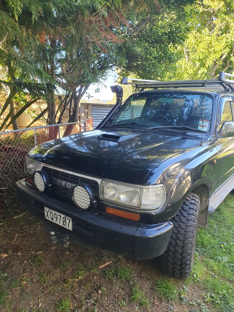

Hi, I'm wanting to put a ford 302 into my Toyota 1994 4x4 Landcruiser, any ideas on what 5 speed manual gearbox I can use with out to much hassle, look forward to anyones feedback. Regards
