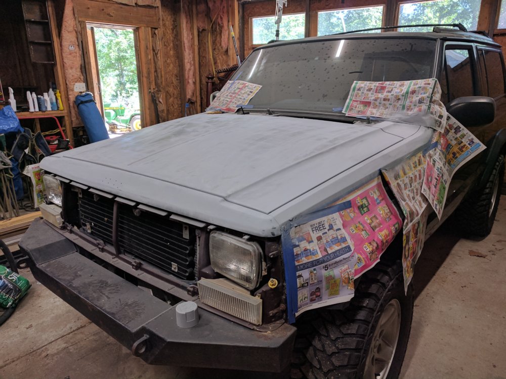

I turned the corners on the hood to help blend better.This is where it sits now. Good Lord Mac that is a lot to take in.It was sanded to remove rust hit with etching primer then sanded again and primer coat .

Whichever way you decide, if you are going to use a HVLP gun, you need to mask the truck waaayyyy better than that. Get some plastic and bag it, then cut out the area to be painted and mask. Overspray will get EVERYWHERE and the cleanup will be a bitch.

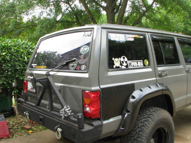

For a few years I rocked a Jeep Cherokee that I painted with tractor implement paint. It actually worked great and was easy to buff. It lasted years and when I sold it still looked pretty good. Best part is they sold the same paint in cans, so I could touch up trail damage when it got bad haha. Here are some pics of it a year after I painted it.
