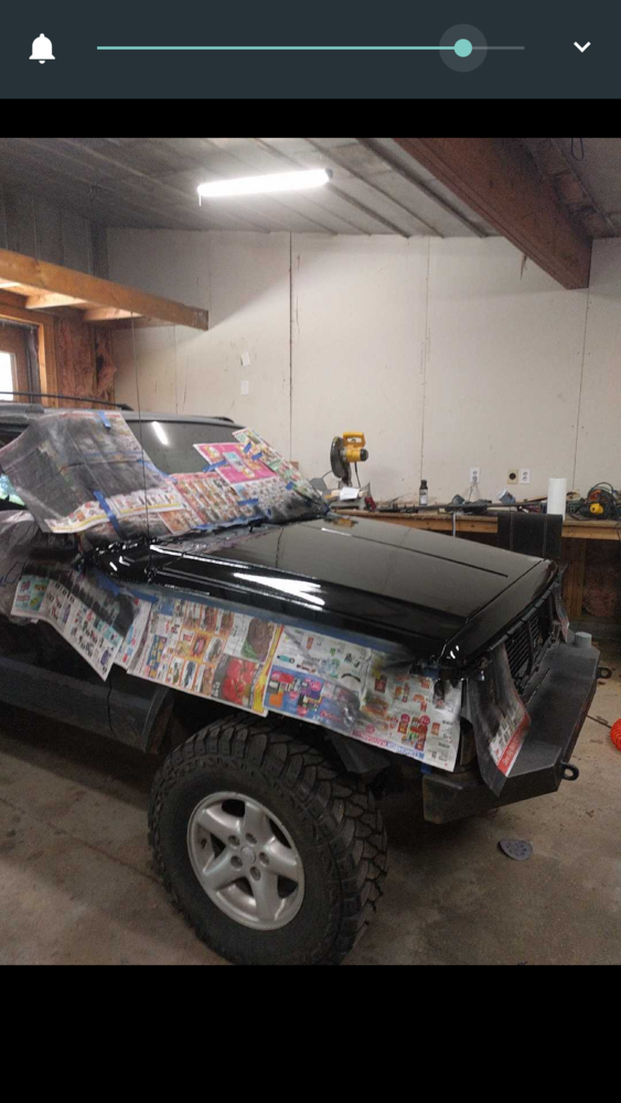

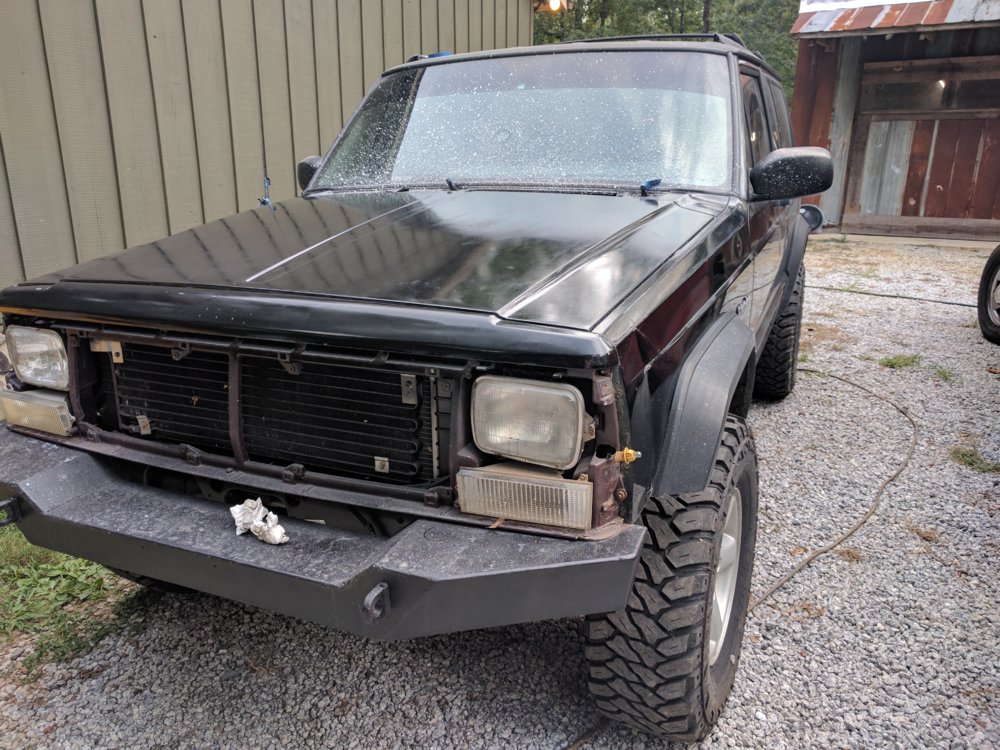

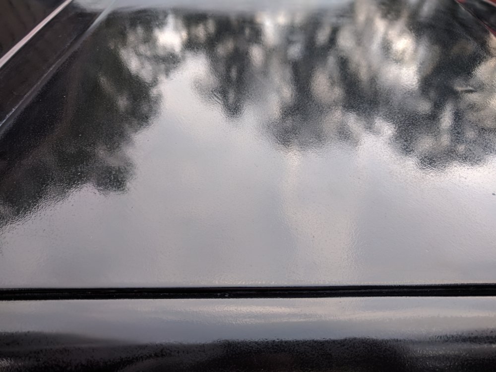

Okay I ended up with a20/20 Wich matched the failed factory paint ok. I have orange pill from a huge rookie mistake . The spray pattern on the gun was the wrong way so way to much paint at once. I wet sanded from 800 to 2000. Then cut with mcquires and polished.
The rest of the Jeep is not perfect I thinking dry sand with 800 till flat and reshoot any thoughts?IMG_20170803_185323.jpg IMG_20170803_185336.jpg
Painted a few rigs I had with tractor paint turned out really good. Paint, little thinner, little Hardner spray away.
How much time you want to put into it and how much paint did you lay down? If you don't want to mask and shoot it again, hard block it out with 800 wet, 1200 wet, 1500 wet, 2k wet then 3k wet. Then buff it out. Worse case you burn through (be careful around edges) and have to reshoot it, and maybe you save some paint materials and it flattens out enough for you to be happy with it. Or DA it flay with 6 or 800 dry and a soft pad then reshoot (again, very careful/avoid around edges so you don't burn through.)
