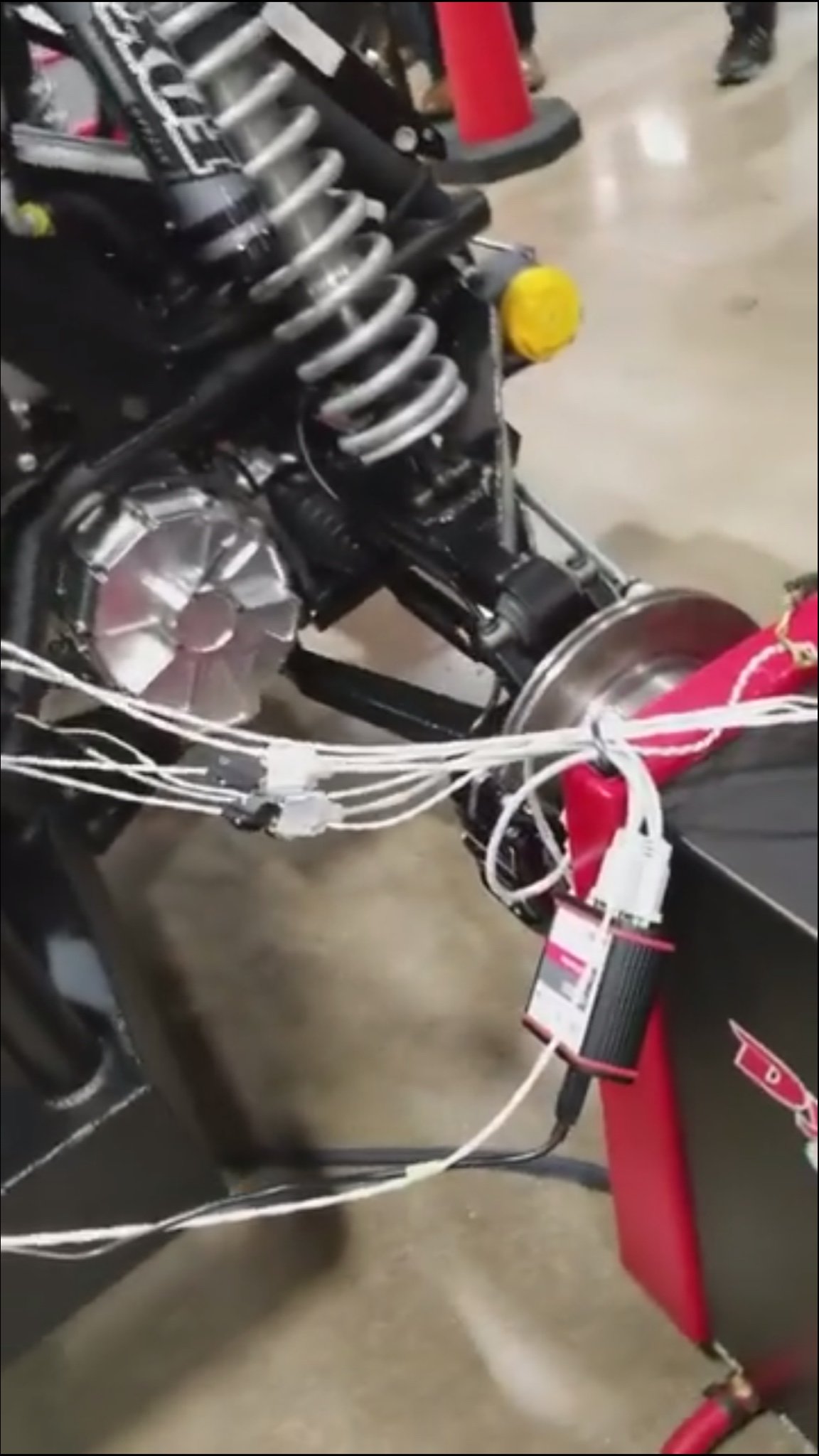

Looking at the dyno video, the motors are sprung weight and has cv axles.
Much better this way as the torque reaction is into the chassis and not directly on a-arms, and definite bonus to less unsprung weight
Yeah, that's the rear, and that looks like a good way to package it. Sort of like a portal box for the gear reduction, and letting them put the motor facing out from the center rather than into it.
In all the pictures of the front, I see CV axles, and the arms pivot near the center, like most UTVs, But I don't see the motors at all, I wonder where they are, and how they are attached to the CV?
