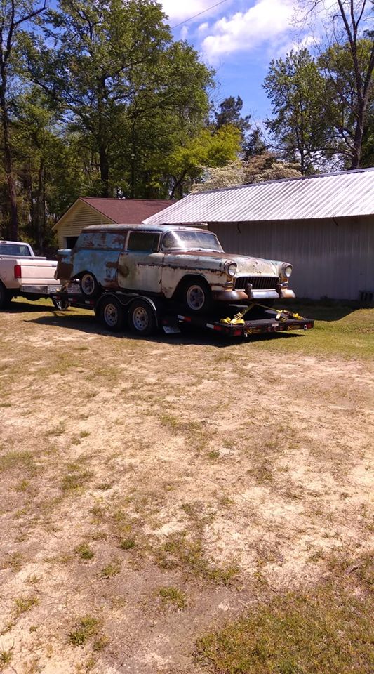

this when I brought her home a couple of months ago.
now she stayed on the trailer for a few weeks while I figuredwhere to put her in my yard. I bought some sheets of treated plywood and now I have her sitting just to the left, in front of my garage. The garage is too short to put all this meat in so I'll have to do alot of the work outside.

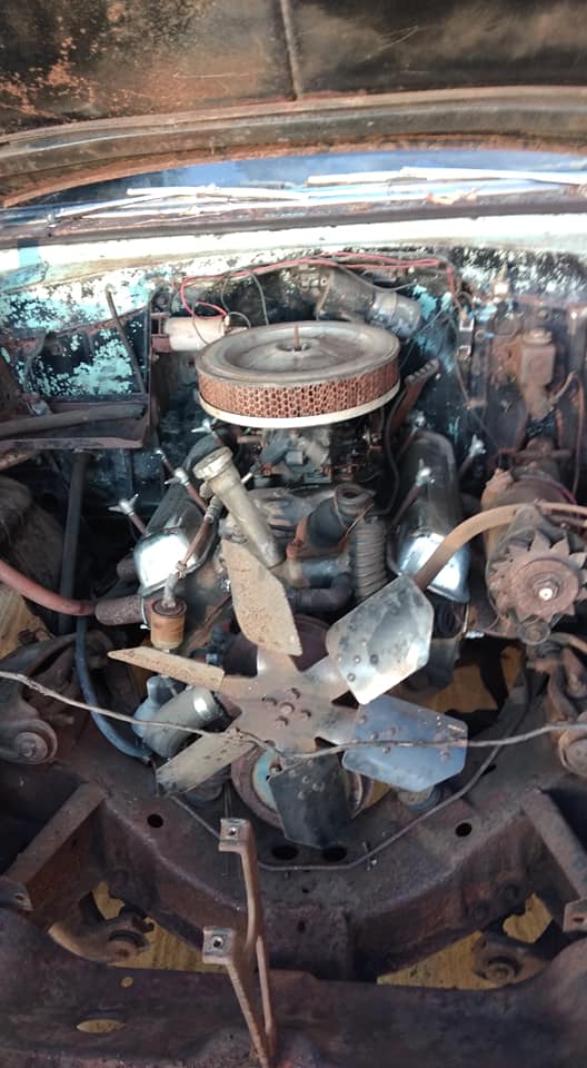

and a better picture of the 67 dated 325 horse 327 with a 67 dated Holley 750 carb:

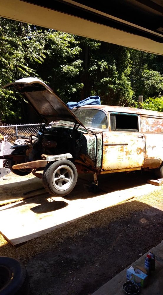

ok,been a few weeks since I started and then stopped to prep up for a trip to Windrock with ole Nellie...we had a good time.
but now it's time to get on track with Ole 56:

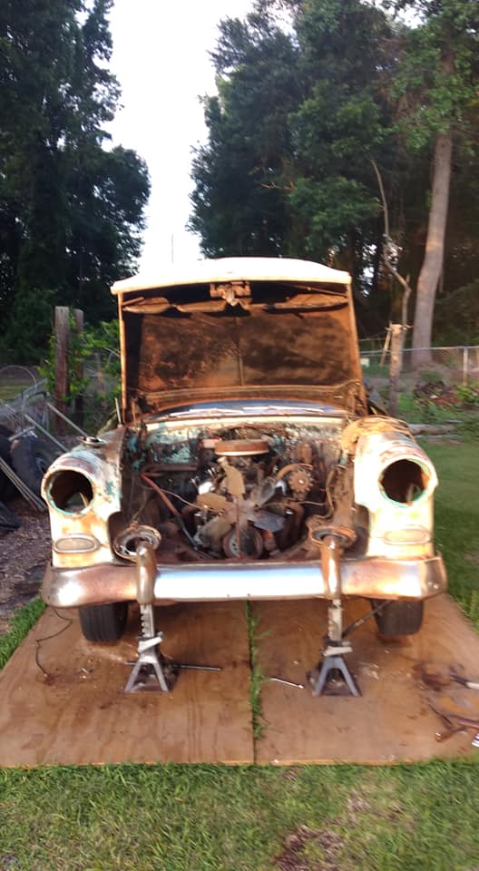

pulled the front off this morning.That went better than I thought it would.me too

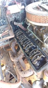

pulled the chrome chevrolet script valve covers and this engine is clean on top side.

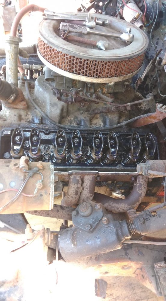

I hooked my ford to the starter with jumper cables and spun it over with no plugs in it.Then I pulled compression test on the 2 cylinders I could easily get to with the headers on.First one hit 175psi but the second did 100psi. I've started soaking pistons in Marvel oil and hopefully get piston rings to spring out.I'll unbolt the headers so I can get to the cylinders better and check all 8.

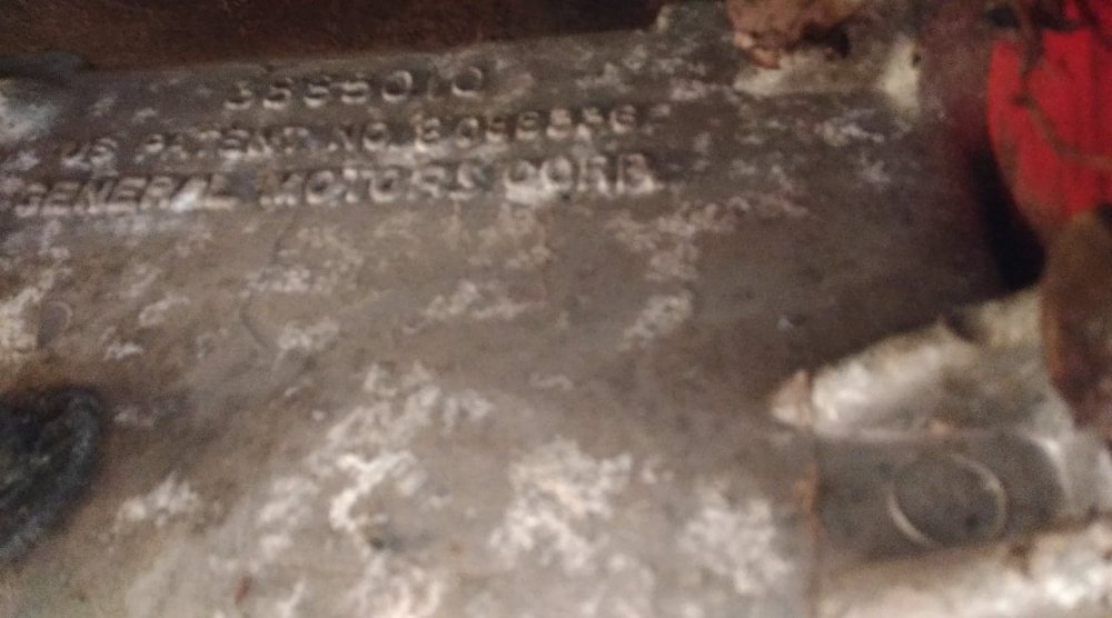

up in the frame picture of the Muncie 4 speed case that is also 66 to 67 dated...goes along with the engine. Wonder if the came from the same car.Oh yea,checked and the bell housing is actually an after market scatter shield.

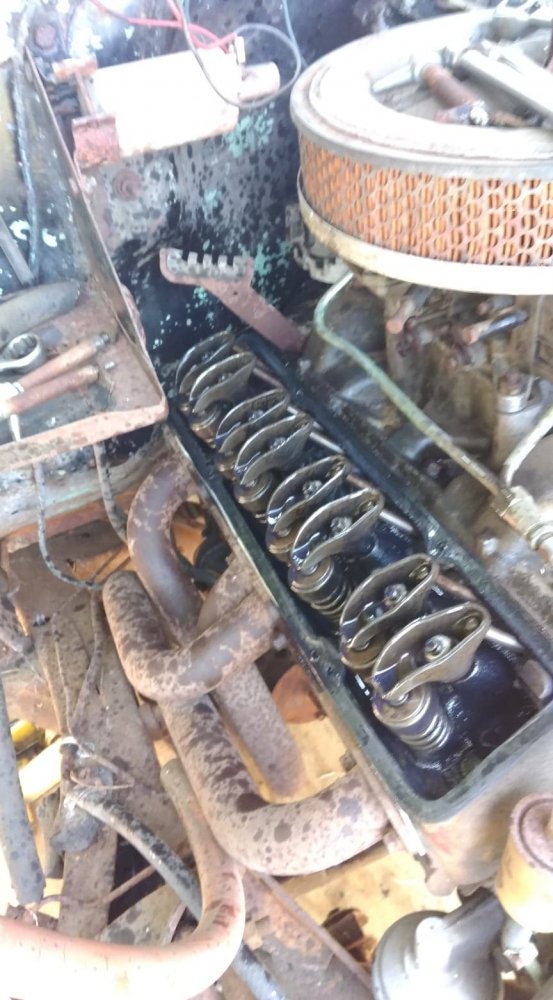

today,I unbolted the headers.These things are old enough to actually have the generator bracket made to the plate that bolts to the head.Never seen that before.
I pulled a wet compression test on all 8 cylinders with the carb held open.Here is the run on the numbers:
1-185psi
3-186psi
5-127psi (up from 100 yesterday)
7-35psi (uh oh not good)
2-165psi
4-152.5psi
6-179psi
8-179psi
I've reloaded the low cylinders with marvel again and will sit all week soaking.I'll check them out again next weekend.
