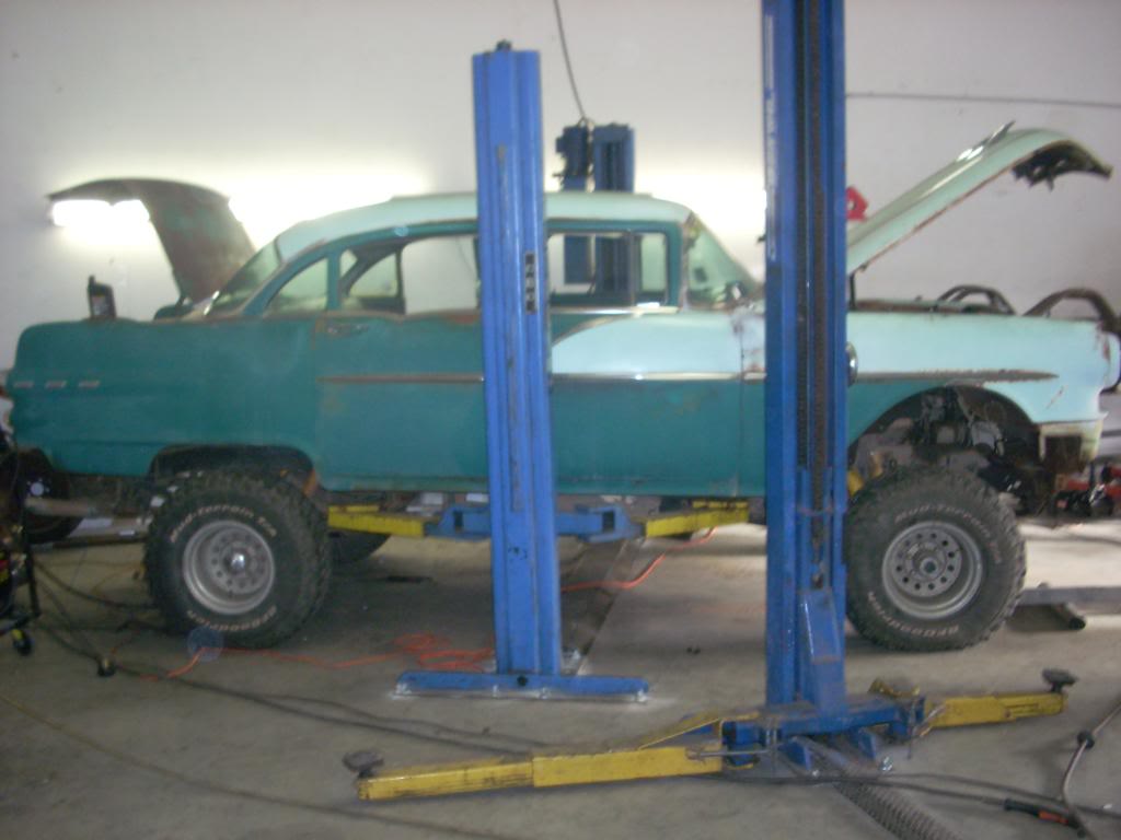

wow its been a while since he's been banned but I figured I would update since he's no longer on the board and he is one of my brothers.

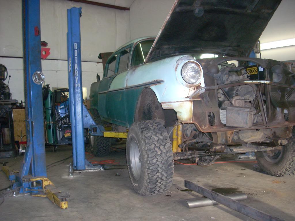

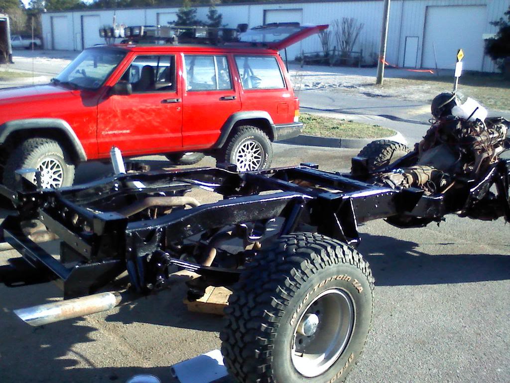

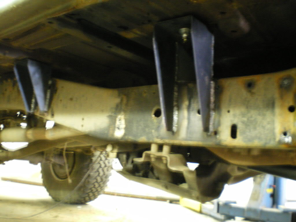

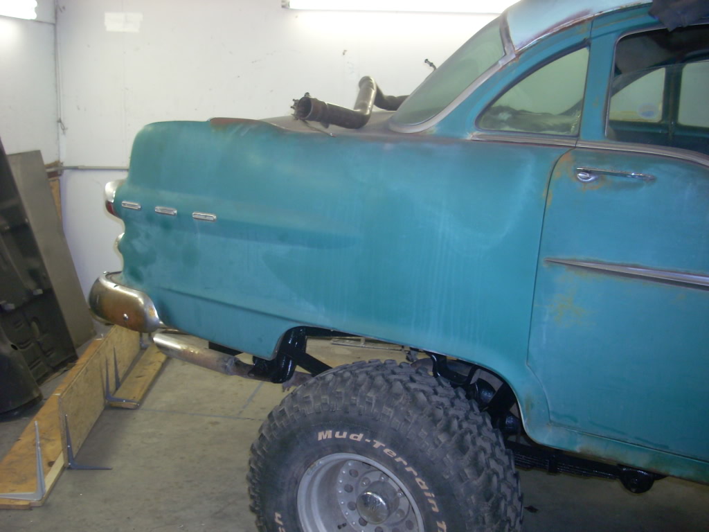

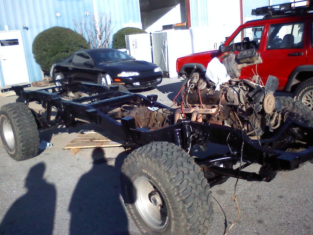

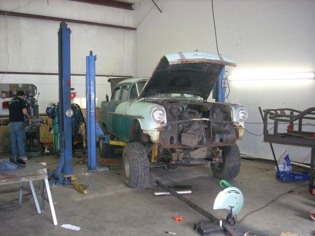

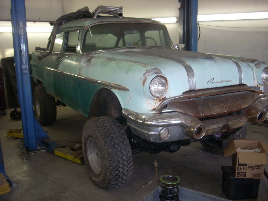

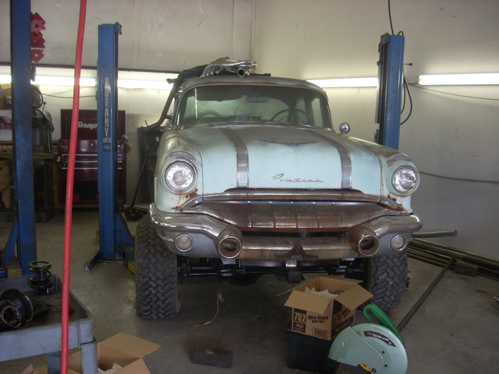

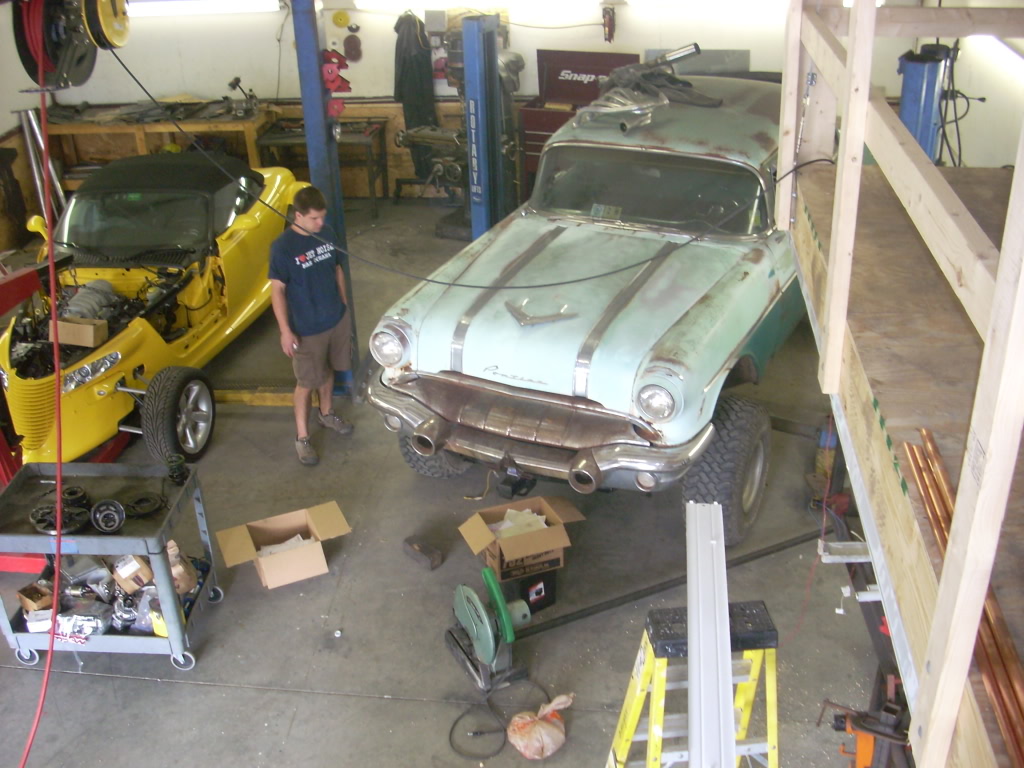

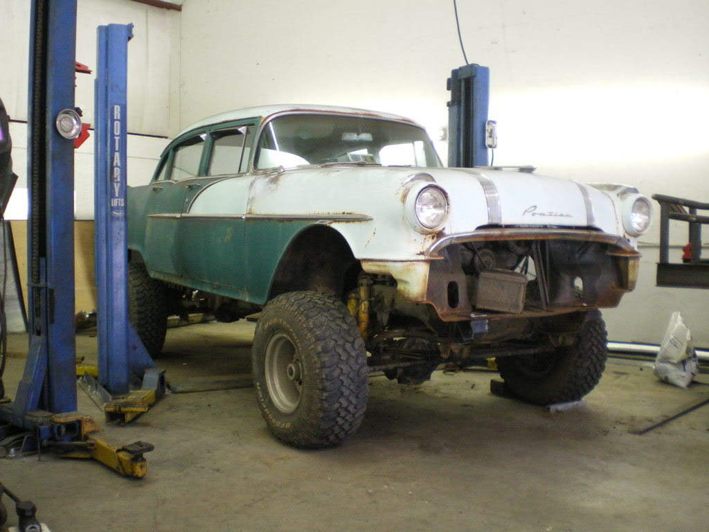

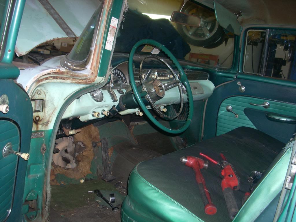

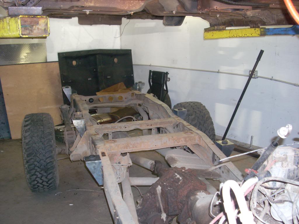

The truck we found was a 1986 chevy shortbed reg cab with a 2" lift, the wheel base difference between the two is about 4" so we might have to lengthen the frame a little bit. The motor is a 305-4 and a rebuilt 700r4 trans with a shift kit, 10 bolts front and rear with the Gov-Lock in the rear. The swap is starting THIS WEEK! Brendon at Performance Innovations is going to be doing the body swap and making the new custom body mounts, and doing most of the shifter linkages and stuff like that with us helping along the way. We are sticking with 33" tires and the 2" lift on it for now so it doesn't look ridiculously tall. And we plan to have this thing drivable in 2 months at most and have it completely done -less a paint job which will be a while- by summer time. Already cant wait to cruise the beach with it and show it along with our dads '56 two door
