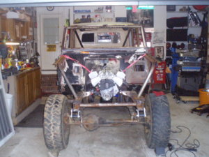

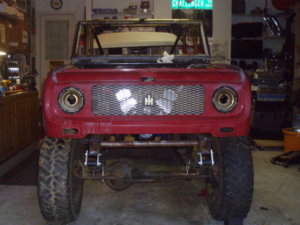

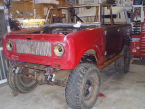

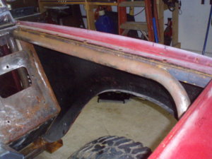

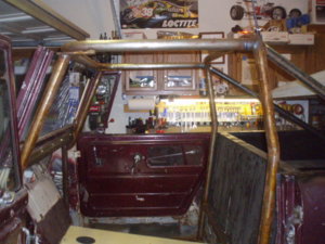

Thought I would post my low buck junk up here along with all the nice stuff you guys build. I am slowly building a 66 Scout into my idea of an all arround driver. All the suspension is just temporarily pinned in place right now while I finish the cage and interior sheetmetal. Being a big fan of acceleration and parts availability, I ditched the IH boat anchor and built a nice little flat top, roller 350 for it. D44's will have to stay with it for a while. Got a well built 700R4 and 231 Tcase will go under it. I just want this one to be a nice driver that I can hammer on a little when I feel like it. Maybe hit some trails at URE but, still be able to wash it up, turn the A/C on and drive it to church on Sunday. I am hoping at age of 45 I can show my new found maturity and not start building it into a beast like I usually do.:shaking:
All the bare metal got a coating of rust on it while I was on vacation and the tarp blew off. Gotta' love it! Now I have to break out the scotchbrite pad and the WD-40 and go to scubbing. NOTE: I lost my new found maturity... Its going racing!

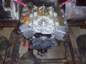

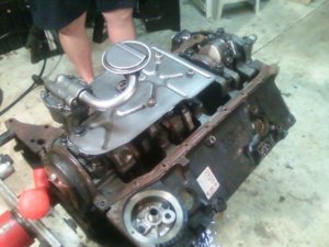

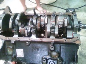

Short block was a GMPP crate engine called a Ram Jet. Has a nice crank, powdered rods, ARP rod bolts, factory windage tray, 4 bolt mains, roller cam provisions, high volume oil pump. I installed a LT1 Hot Cam (Roller) and double roller chain. Heads are AFE 190 intake runners. Beehive springs, titanium retainers, Manley under cut stainless severe duty valves, 5 angle valve job, ported and cleaned up for tourqe. Intake is a GMPP mid rise dual plane that has the quadrajet pattern. Had my buddy Scott build the Quad. He has 13 NHRA Wallys in Super Stock. He knows what to do to a QJet! Headers are left overs off a drag car thats sitting in the shop. HEI and a MSD box to light it off.

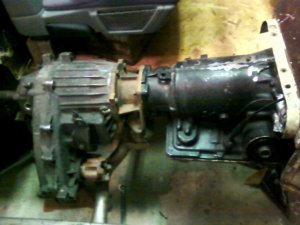

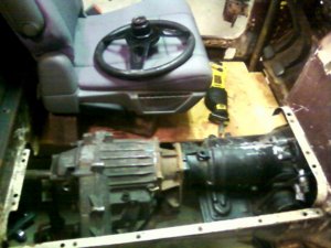

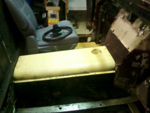

Built the crossmember for the Trans/T Case. Started cutting the floor and firewall out and remaking it for the most foot room around the pedals. With the engine set back this much, it is a real challenge. Got the tcase up as high as I can. Built the steering column and hung the firewall mount and rod ends on it. Steering wheel is removable with a quick release.

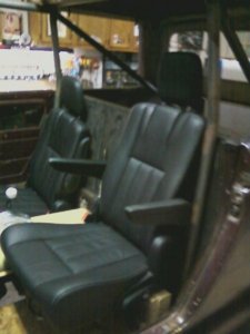

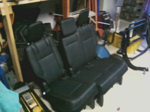

Seats are leather mid row and rear units out of a new Chrysler Mini Van. The fronts have built in heat, arm rest, tilt with collapsable head rest and seatbelts. Best part is they they fit perfectly in the narrow confines of the Scout. I am going to cut down the 60/40 back seat to fit a removable cradle for the rear. I plan to mount it like the factory did it back in the day.
