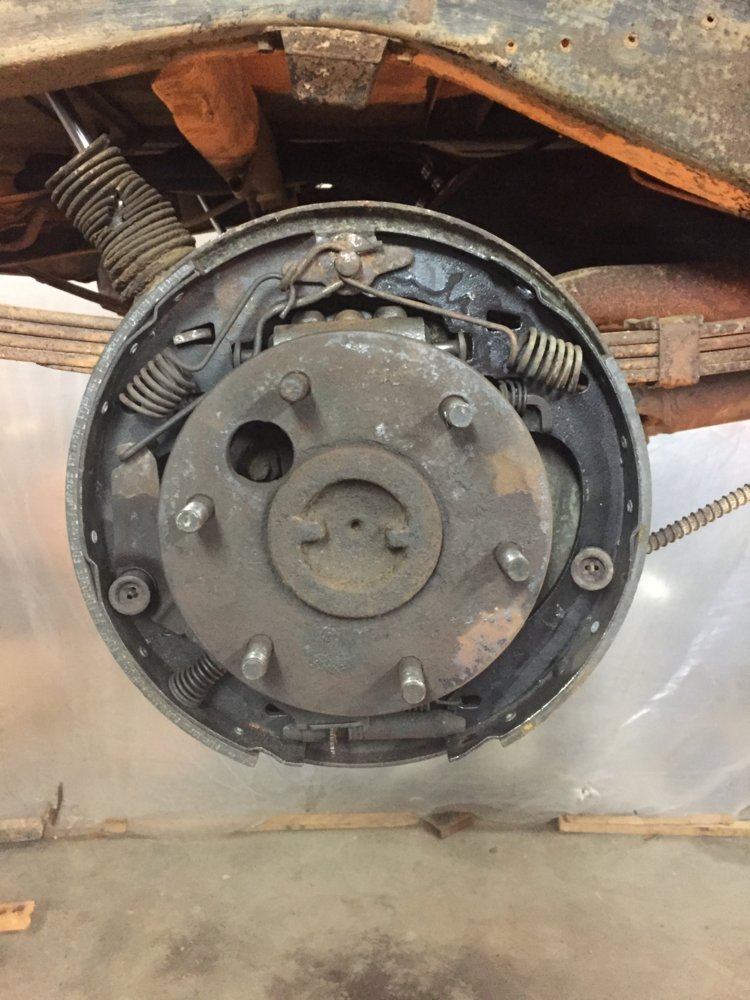

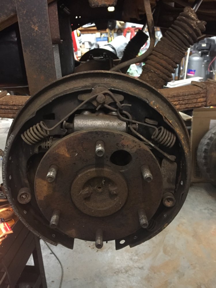

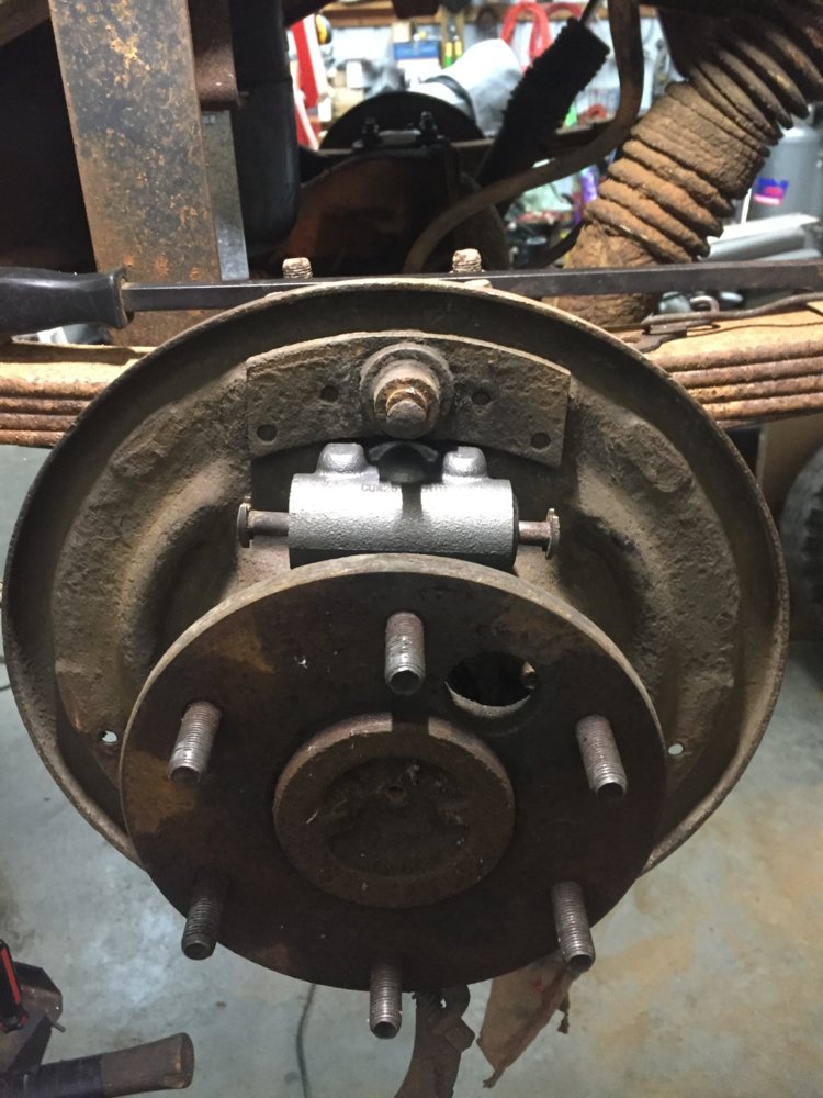

Got rear brakes completed today
New wheel cylinders
New shoes
Had them both done, but didn’t like the passenger side e brake cable as it was too tight and wouldn’t release. Took it back apart and went to the parts pile and had a good one and installed it. Now e brakes work.

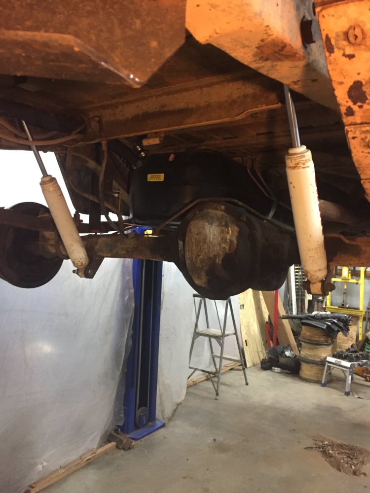

Rear shocks were toast, like no resistance at all so found a couple Rancho 5000 in the pile and put them on.

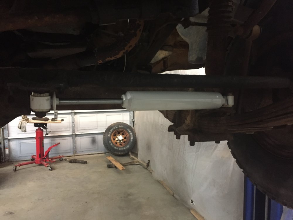

Next was the front steering stabilizer, was as bad as rear shocks. Since I had one laying around, I put it to use.

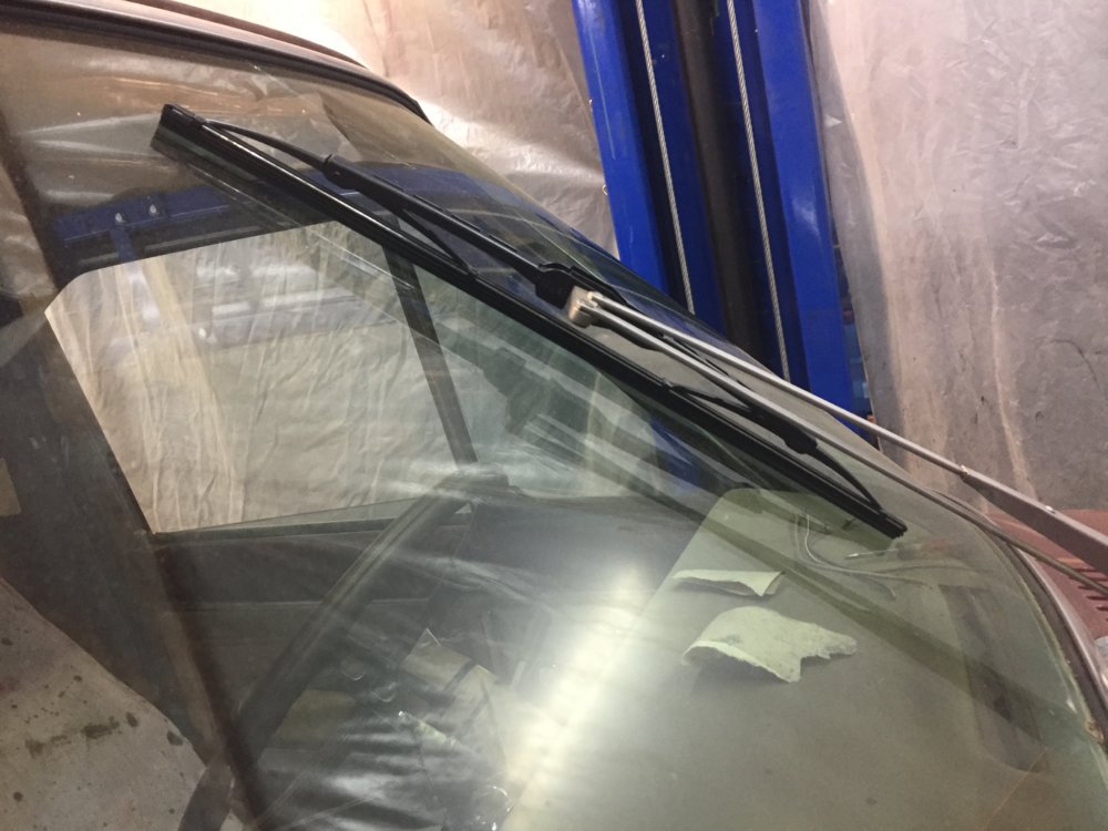

Took a trip to Ollie’s last night and picked up some seat covers and wipers. Forgot to take pics of seat covers :rolleyes:

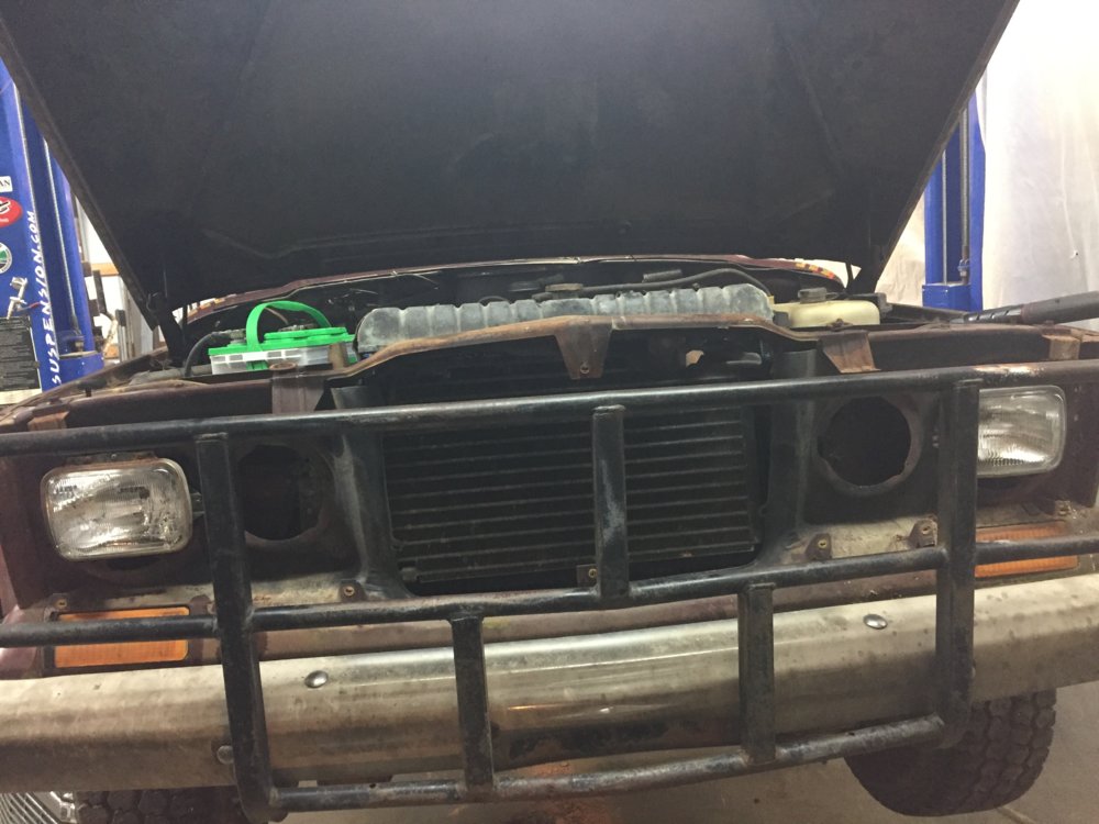

Had a dim headlight so removed the grill to check ground. Found it was actually a bad bulb after all, so I replaced it.

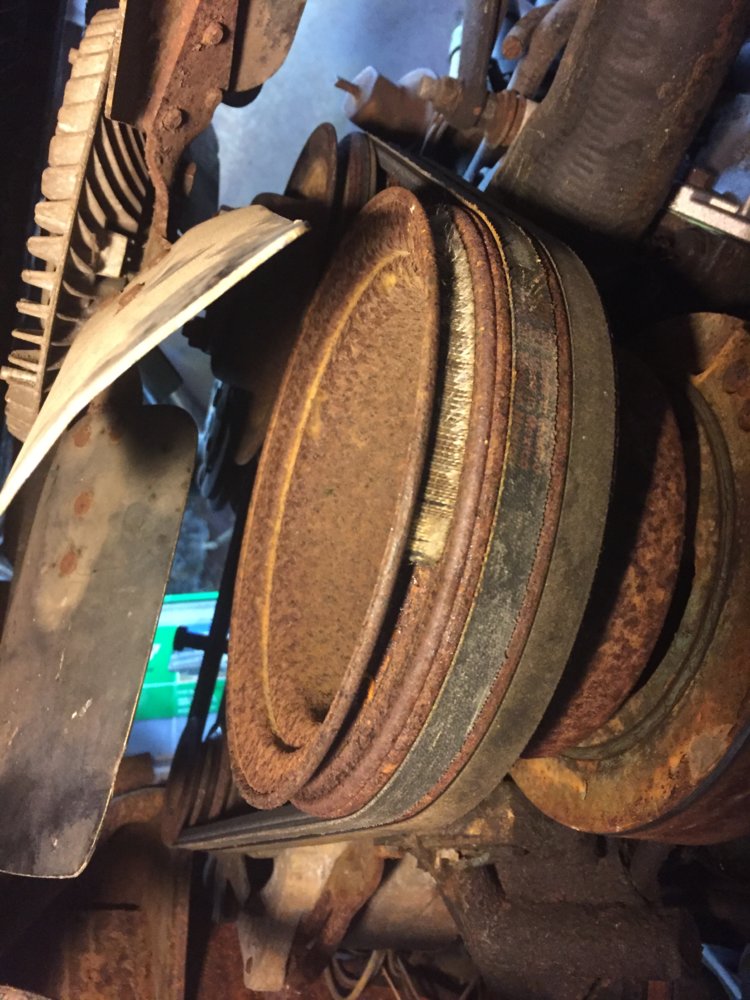

get back to house and now no power steering?? Open hood and new belt is wrapped around fan. Another damnit moment. I look and found about 4” on the old belt still stuck in pulley, go figure.

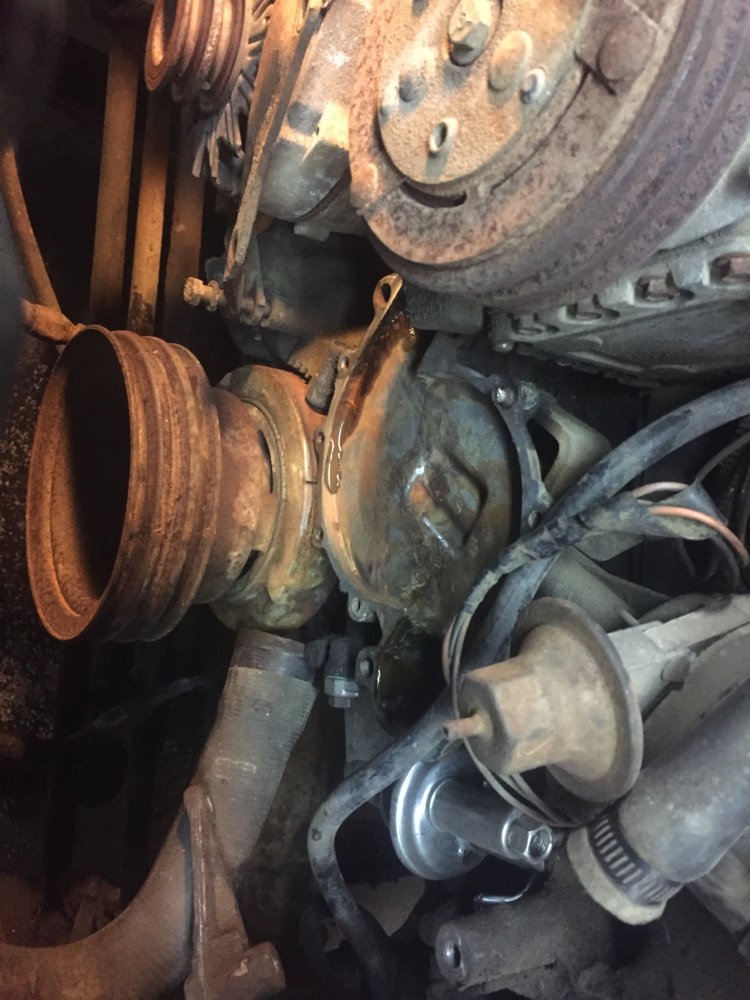

Water pump is dripping so looks like it will be next on the list. Stay tuned!

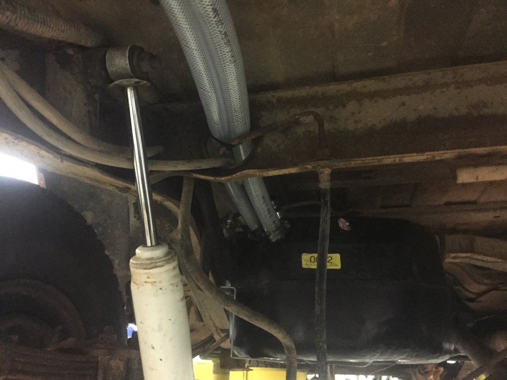

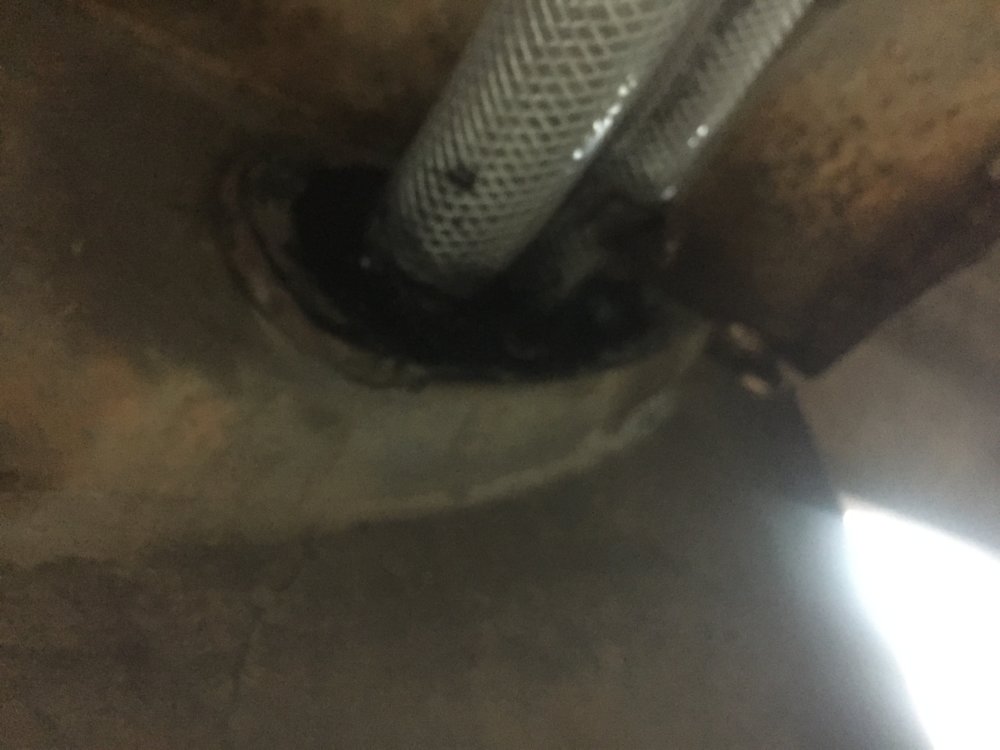

Fixed the leaking fill tube for gas tank. Ended up cutting off the rusted part and extending the fuel fill line. I went with a more flexible line in order get it where it needed to be. Was a lot easier to work with.

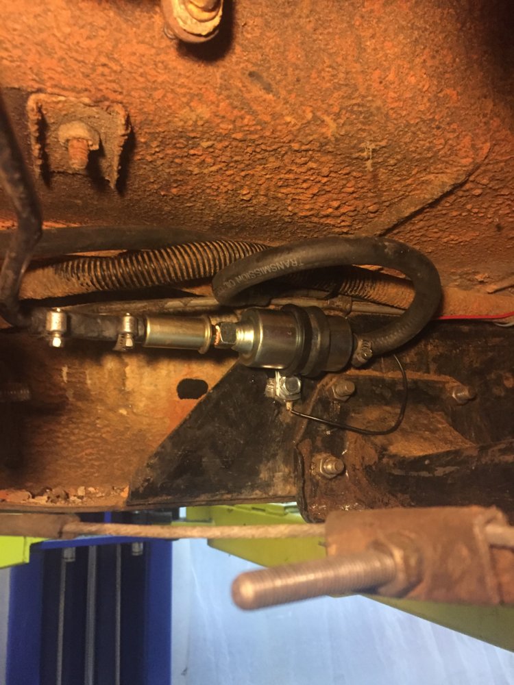

Next was it still wouldn’t start. Damn new fuel pump was not working? Finally said screw it and went and got a electric fuel pump and installed it. Now I have gas to the carb!

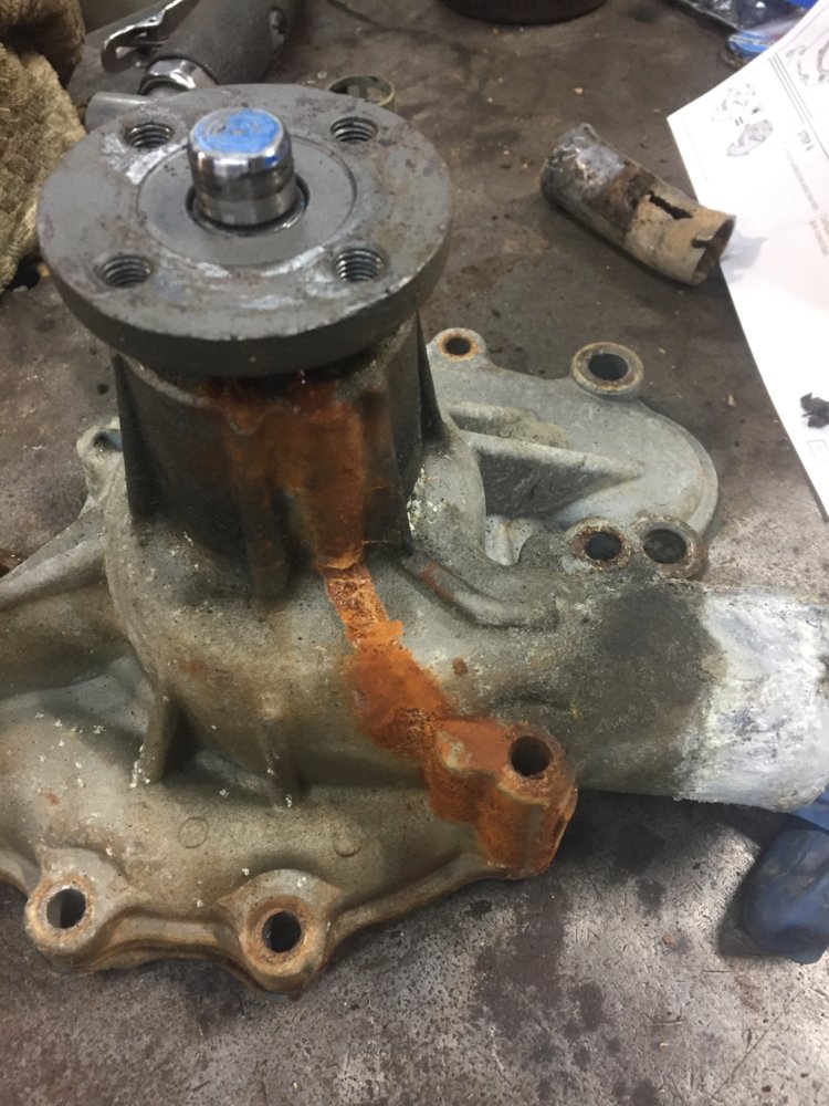

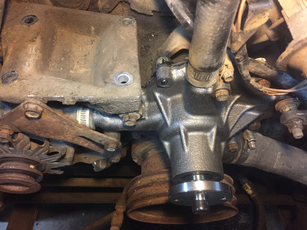

Next was the water pump. Pretty normal. I removed the AC compressor for now since it didn’t work.
Old one
Filled it up with water and took it for a test drive. All good! So figured it was time for a longer drive so went to the gas station to fill it up with gas. All good. Stopped by a buddies house for beer. Still good. Runs great, sounds great, trannny shifts good. On way home, brakes get weak.... then brakes go out.. damnit. Thank goodness for up hill roads and manually down shifts and no traffic. Made it home, pop the hood and master cylinder leaking bad.

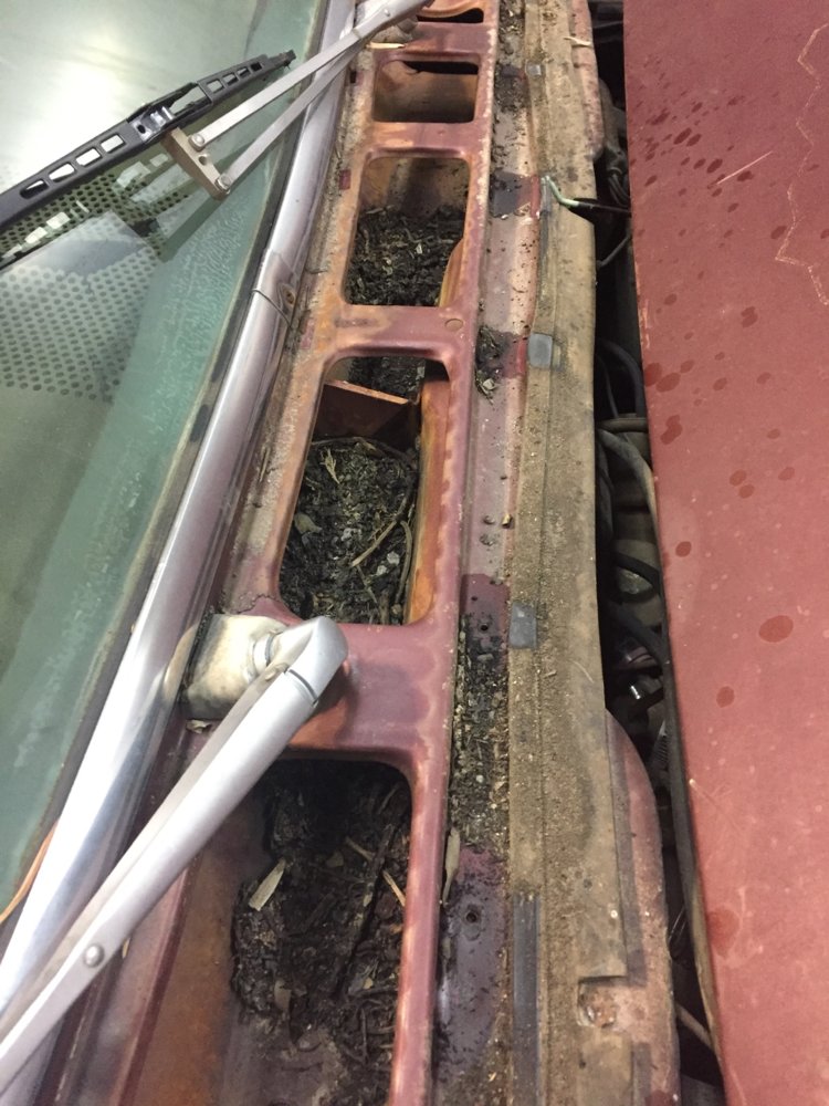

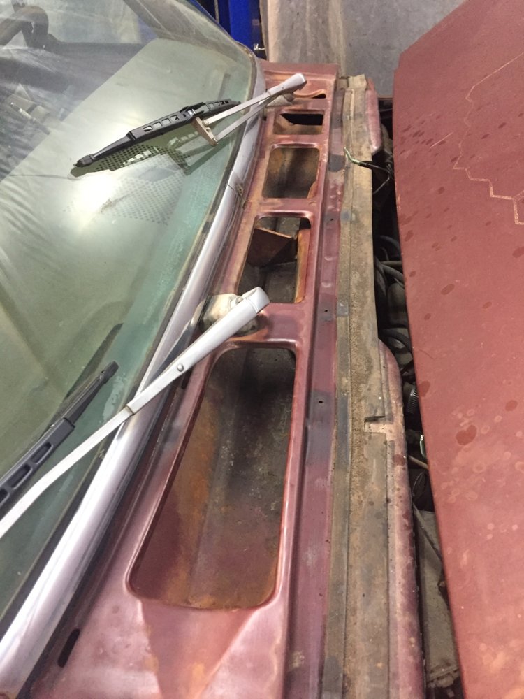

There was a lot of debris under the cowl vent so I removed it and cleaned it out.

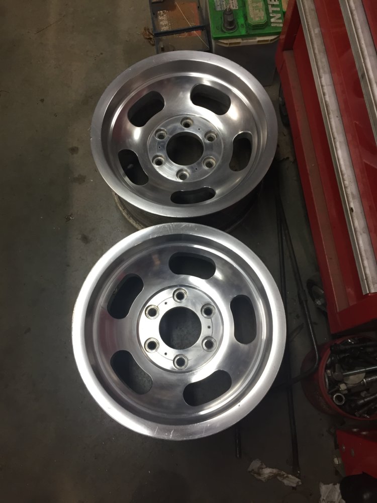

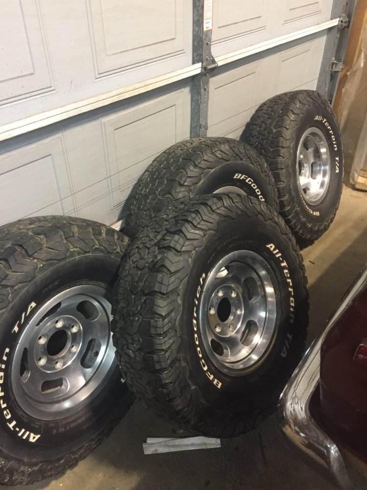

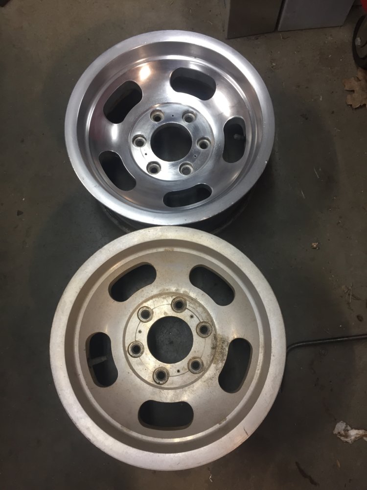

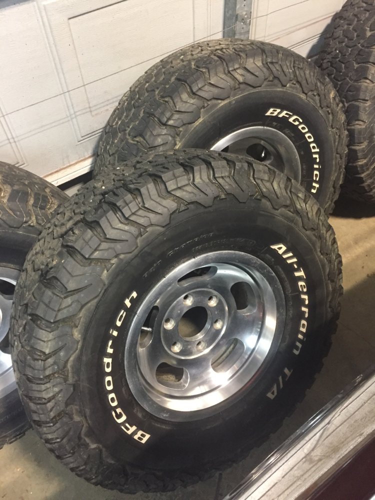

Picked up some 33/10.50’s so along with those figured I would throw on some old school alumn jeep wheels to replace the ugly wagons. First step was to clean them up. If you have never done this, it really does suck.
Dirty vs clean
Two done two to go...
I am still looking for two more of the wheels if anyone in the area has any. I do have a line on a couple in TN if I can ever get over that way. Hopefully I will have tires mounted by end of week.

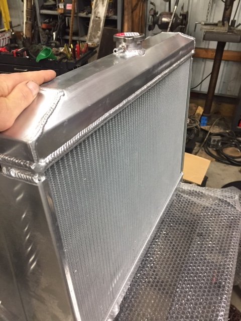

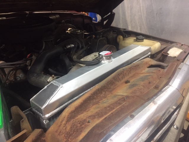

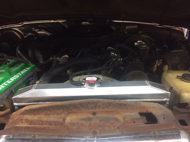

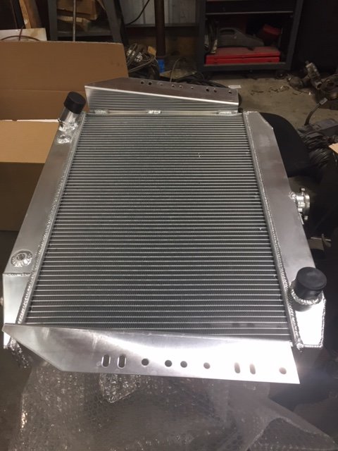

Little update. Had a small leak in the radiator. Checked another one I had, but it really wasn't in much better shape. Did not leak, but tubes inside were pretty gummed up. With the price of a new one vs getting the old ones fixed, I just went with a new aluminum one.
installed

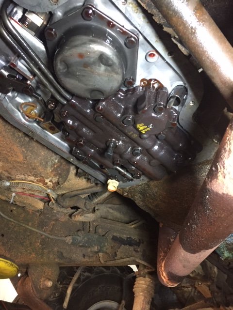

While I had it on the lift and trans lines unhooked, I figured I may a well change the tranny filter and fluid. Was surprisingly clean on the inside.

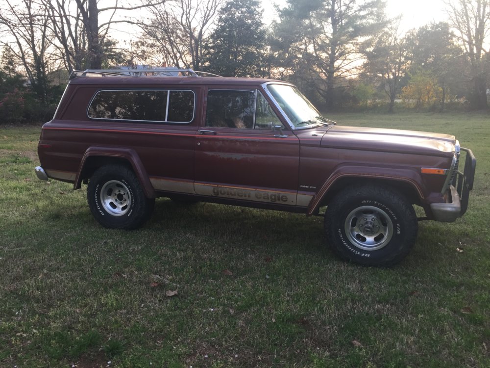

Next on the list will be new felt tracks for all the windows. The rattle is extremely annoying. Oh and it is now officially tagged and insured so I can drive it legally!
With all that bling, you gonna dress up the rest of the engine compartment?

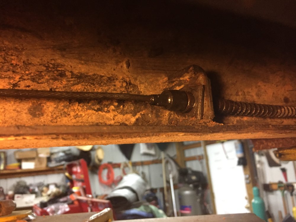

Also, is that some major frame rot I see?
No more bling in engine area. Probably Gonna have to do a rear main seal and pan gasket down the road. The frame is rock solid with just some surface rust in places. It does have some dried dirt is a few areas too. I think what you are seeing is where some of the undercoating is peeling off. The whole underside between frame rails and under body were undercoated, possibly when new from the looks of it. From what I could find it was bought and lived most if, not all of its life in SC.

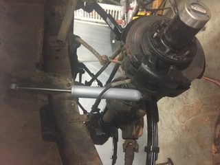

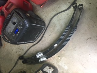

Sagging springs, no spring bushings up front, busted front shock. Ride was terrible and big “clunk” when turning because of missing bushings. May as well get a cheap lift and remedy the issues.
New front springs
new springs installed and all new shocks
before
after
ride is so much better! Now to get A radio For some tunes and the window felts and channel’s ordered to quiet those rattles. Almost every time I take it to town, someone ask me if it is for sale. I tell them not until I get my other 79 chief done. I have four numbers to call when I get ready..lol

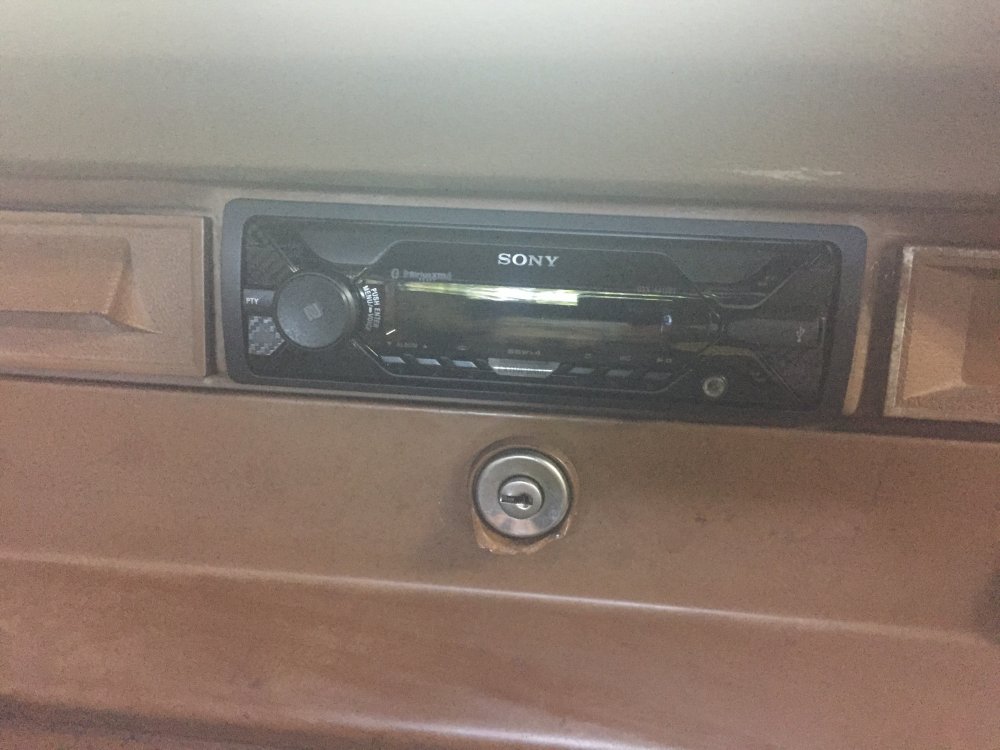

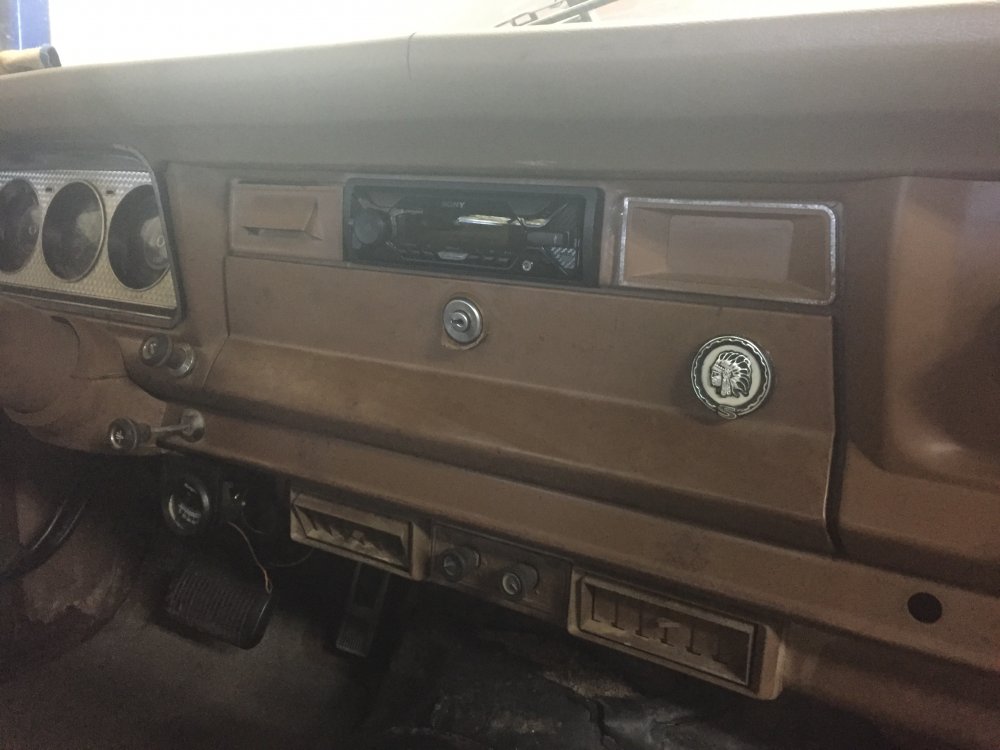

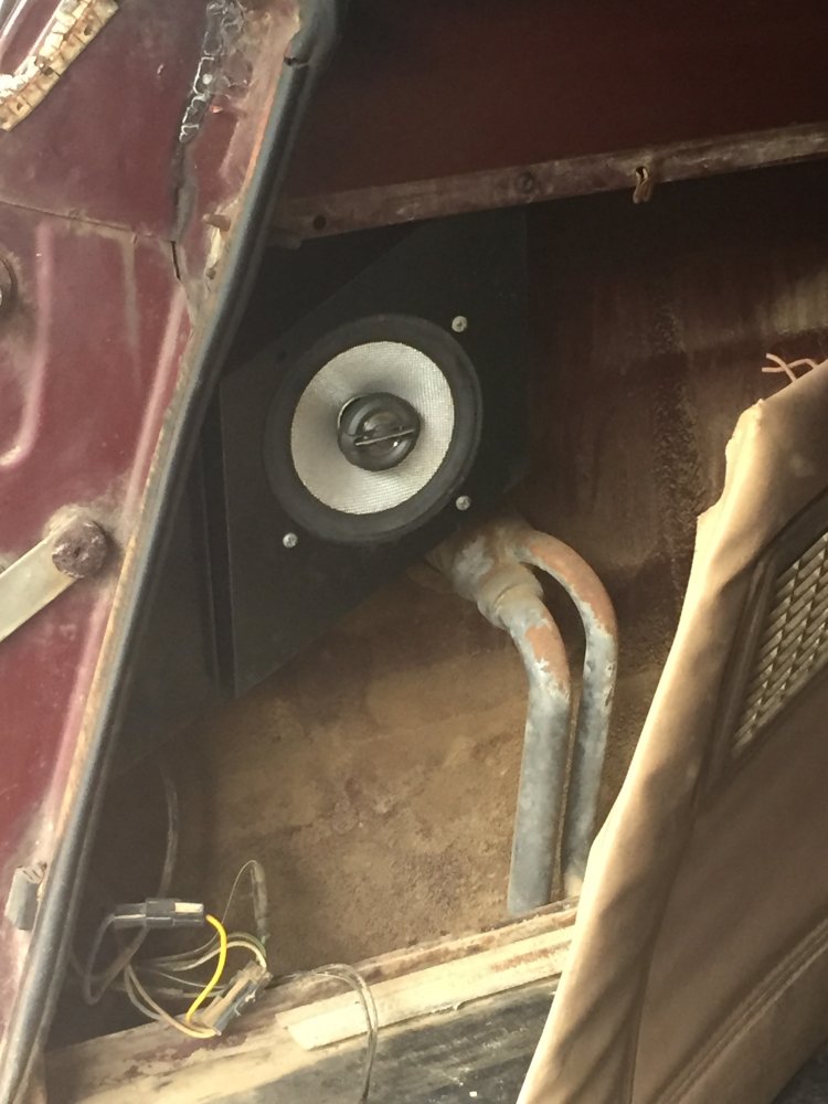

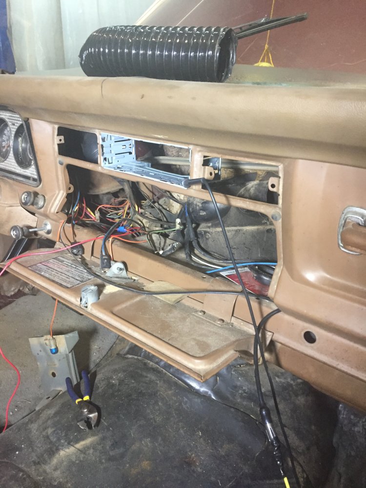

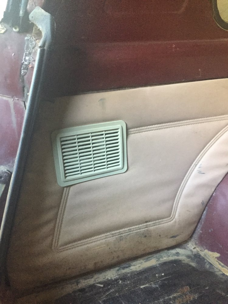

It is tune time. Picked up a cheap blue tooth Sony radio. Out with the old push button radio/CB and in with the new. Also replace all 4 of the speakers with some I had laying around. While I had the radio out, replaced the passenger side defrost hose that was all cracked. Also cleaned and painted the ash tray, now change holder. Thought I was good to go but there was a puddle of fluid when I went the back it out of the shop. Steering box sector shaft seal is leaking...bad. Looks like a trip out back to the parts Jeep.
radio bracket in and new defrost hose
new rear speakers
was missing one of the speaker covers so I grabbed a red one out of parts rig. Threw on some paint
got good tune now.
