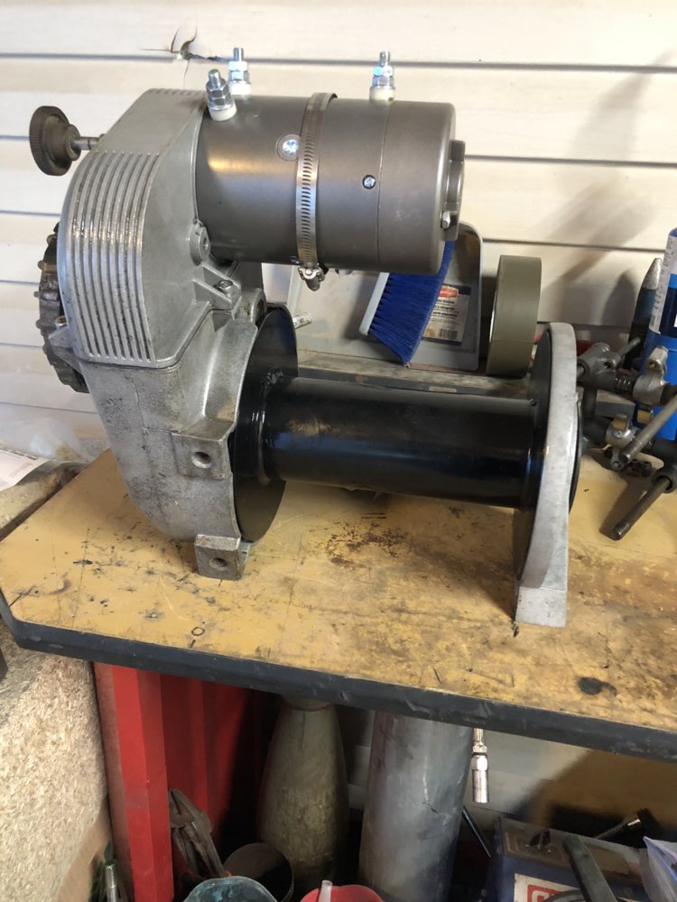

I bought an older 8274–50 winch a while ago and getting around to rebuilding it and have established it is in need of a motor. What are you all running? I have heard there are upgrades but I am not looking for anything crazy. Any recommendations are greatly appreciated TIA.

You can buy the 4.6hp motor. It's a direct swap (assuming you have the matching spur gear), and is what comes on the 8274-50. You can also do the 6.0hp motor, but it sometimes breaks cases.

Went ahead and bought the 7536 4.6hp motor. Summit had an Easter 10%. And I had some Christmas gift cards. @shawn thanks for the links. I always search the wrong thing and then feel like an idiot when someone links a thread.
