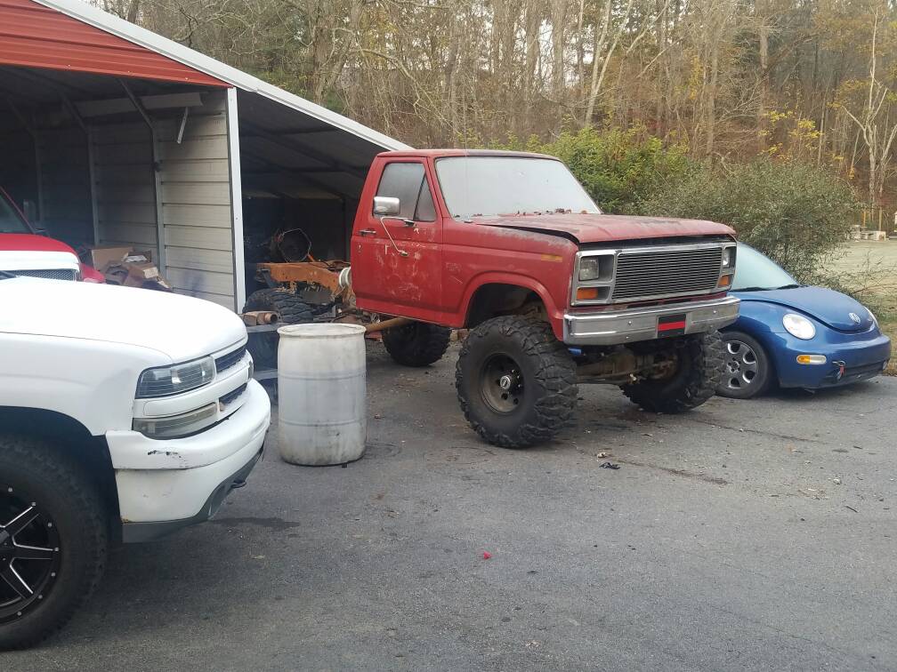

With Dana 44 front:
After Dana 60 swap and some wax. I got a wild hair at work one day and waxed half the paint that was left off of it. The 60 swap lifted it about 2.5 inches. I put the F-350 springs up front. Still have to put the FF and F-350 blocks in the rear.

Looks good, is that a custom 4 lug Dana 60 :D is that a Dana 60 sf rear?
Edit: nvm just saw you said it was a sf 10.25 didn't even know they made those.
Sent from my mobile Toyota base using Tapatalk
Haha yeah it's a 4 lug for now. I can't do anything but pull it out of my carport and back in or I'll rip the fender off of it right now. Yeah it was a light duty 250. I didn't know they made a SF 10.25 either but they definitely did. I need to get rid of it. Definitely ain't worth anything to me.
