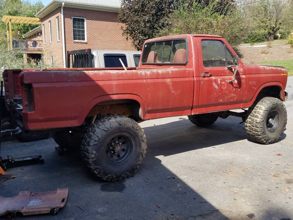

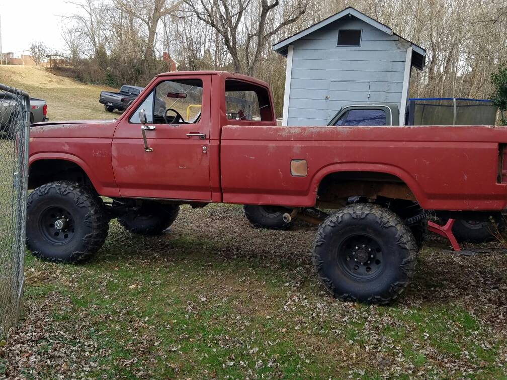

Got the bed back on and front brakes done. Going to have to put a new proportioning valve on the rear. Got in a hurry and welded the bracket with it mounted to it and pretty sure I melted it. Just need a track bar drop and shocks and it'll be ready to go. The rear ended up being a little high. Going to take the 350 blocks out and put the 250 blocks back in.
Finally made some good progress. Lowered the back two inches, dug through my shock pile and found a brand new set of Ranchos from a 2012 F-350 and they were the perfect length, new brake prop valve is on for the rear discs, back glass is in, 96 bench seat is in. All that is left is a track bar drop bracket and windshield after the whole thing is clear coated.
