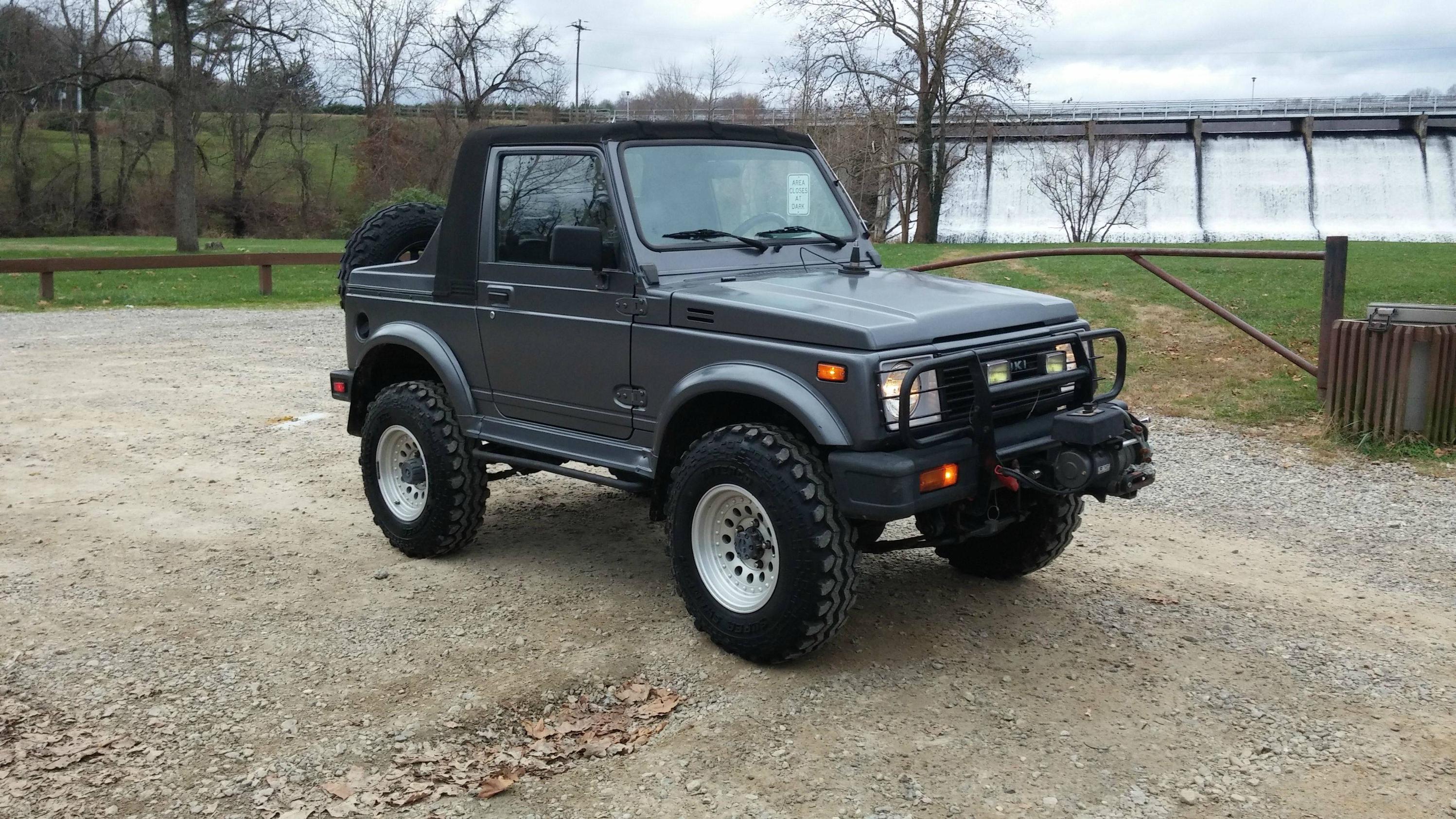

I have been looking for a winter driver/off road toy for a while now and picked one up today.
What I know it has:
Warn Winch with hitches front and rear with winch connectors
5 new 31x9.50x15 Interco TSL Super Swamper Radials($$$$ worth of tires)
Dual Battery set up
Webber carb
Rally Tops Sport hard top.
What the seller claims it has:
Transfer case gears
Detroit style lockers front and rear
What It needs:
Clutch cable adjustment badly
Shifter bushings as I shouldn't have a foot of shifter movement in gear
Power steering. OMFG so heavy
Fix rear hardtop lock
nice Zuk!!
that thing is clean, id love to have one like that for a daily driver
Order the power steering kit while you're at it and buy my Sidekick PS setup!
That's clean! It's about got the perfect stance for wheeling around here, IMO. I wheeled mine at stock height for years. A couple inches of lift and 31s make for a happy beast! You can get lighter springs or possibly modify yours for less money. I'd also ditch the stock bumpers and buy something from Zuksoffroad or have somebody custom build something. That winch is going to be an anchor hanging out there like Bubba Gump's lower lip. A good set of rockers and a little tasteful body modification and you'd have a really nice, reliable rig on your hands.
Oh, and ditch the Weber as soon as you learn to hate it. The My-Side is a fantastic setup for a carb, probably the best out there. A Tracker fuel injection system is also a great option, but much more involved.

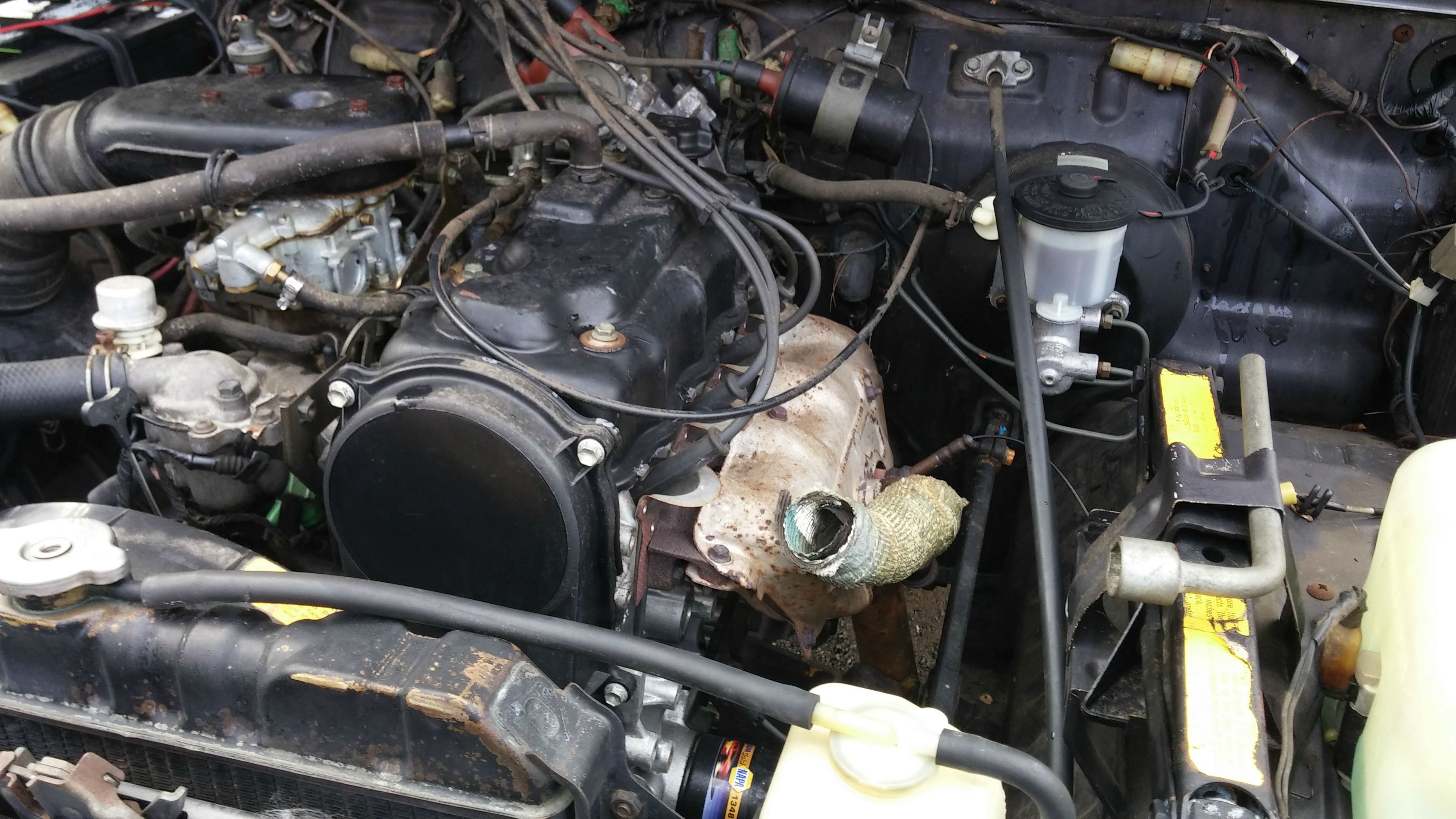

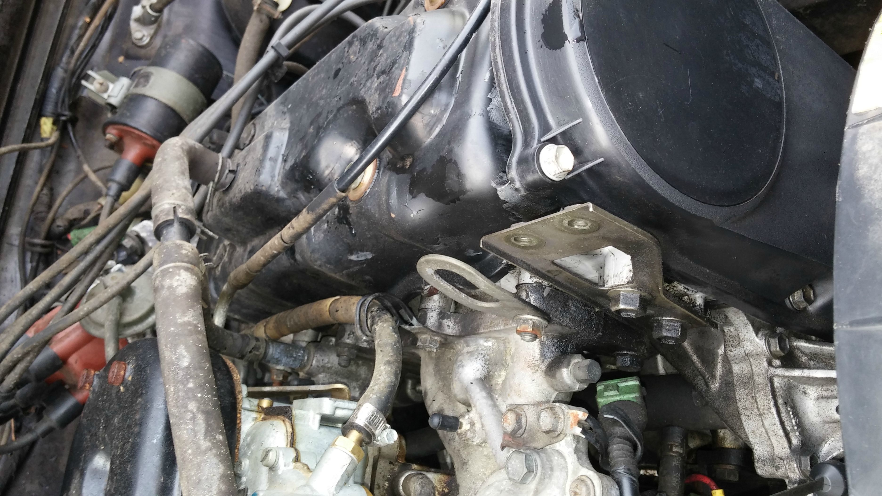

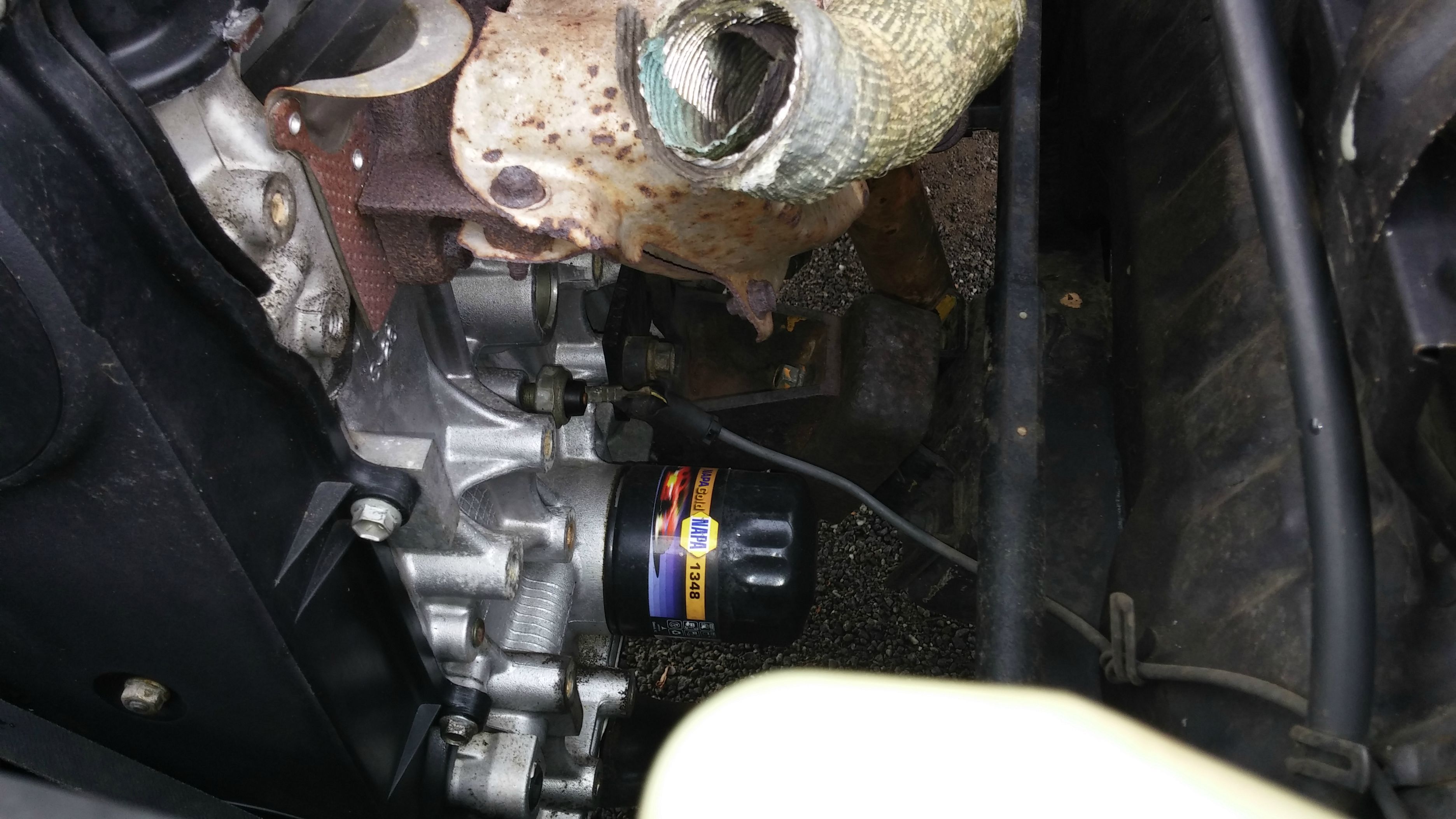

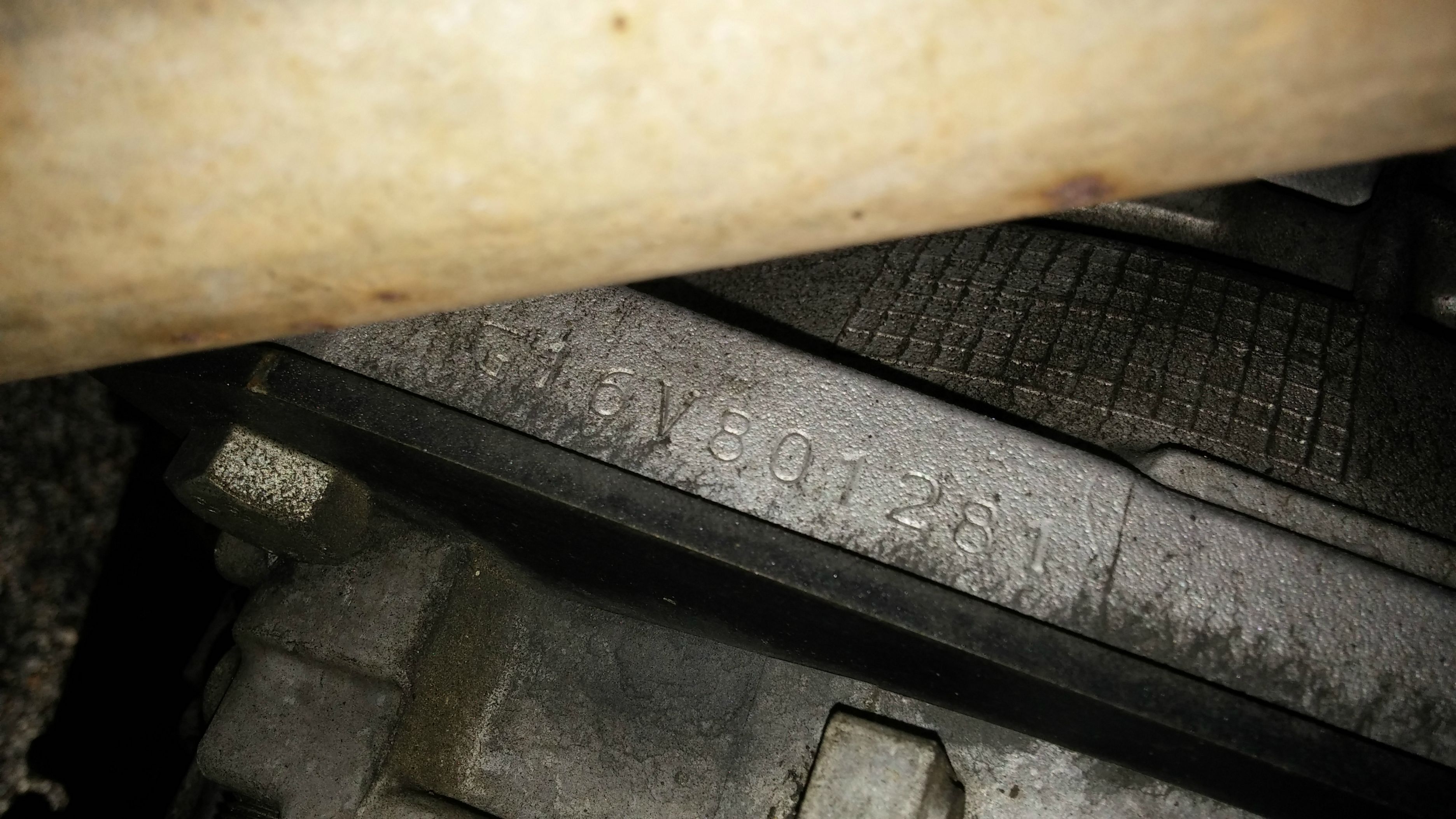

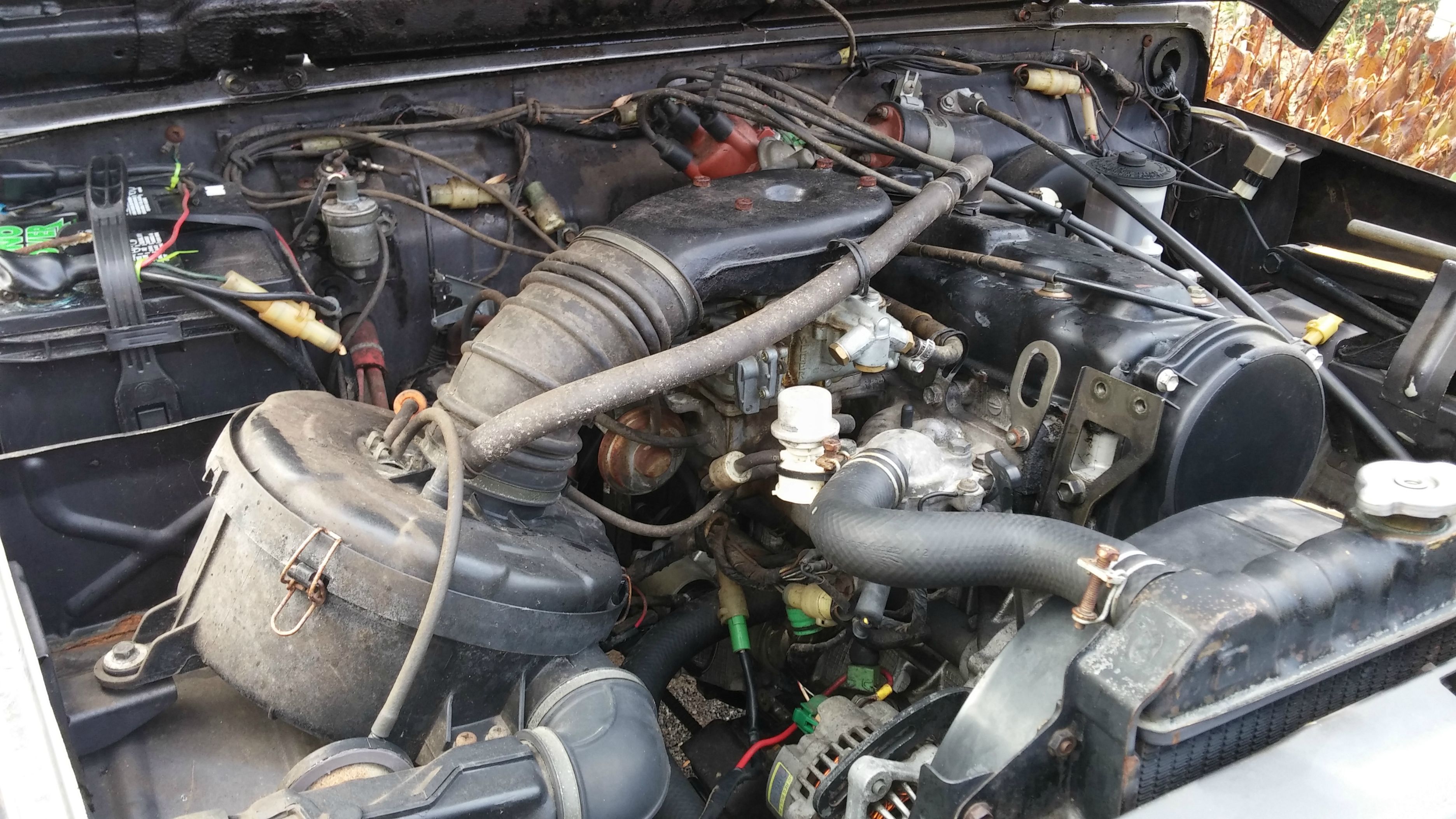

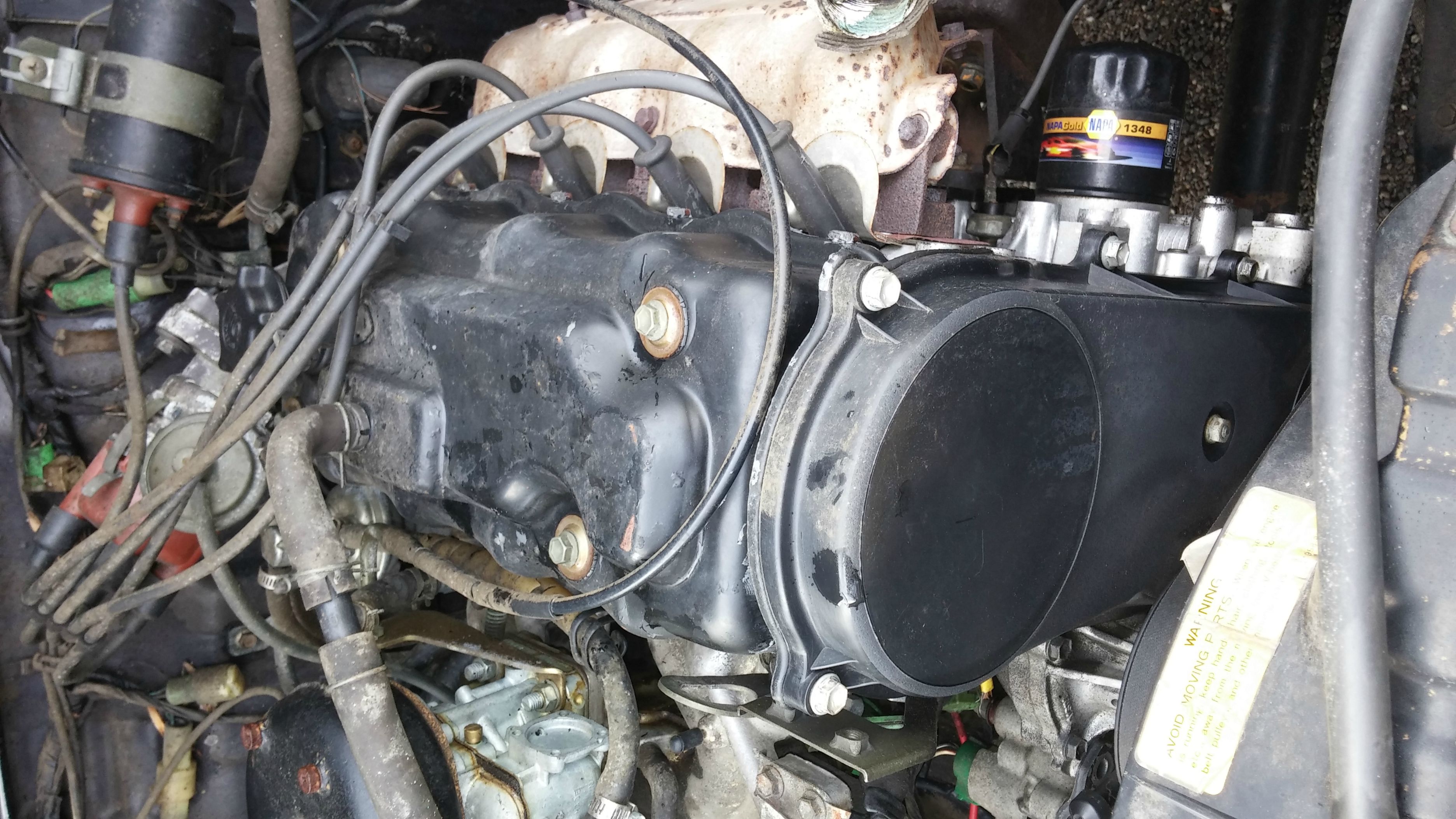

There is clearly an adapter plate and with the block numbers it looks like it is a 97 1.6 block with what I assume is a 1.3 head. It has a plastic timing cover as well.

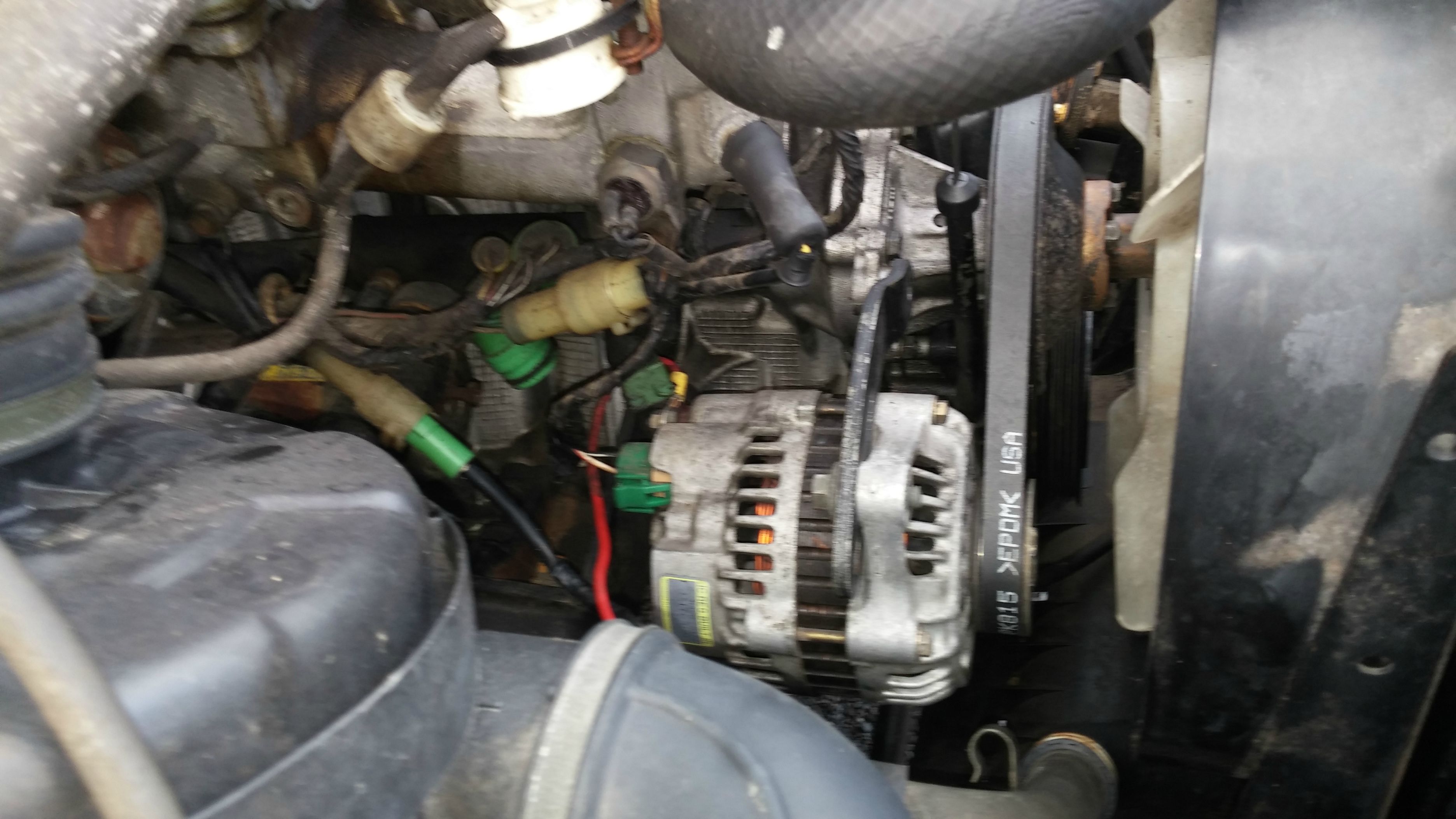

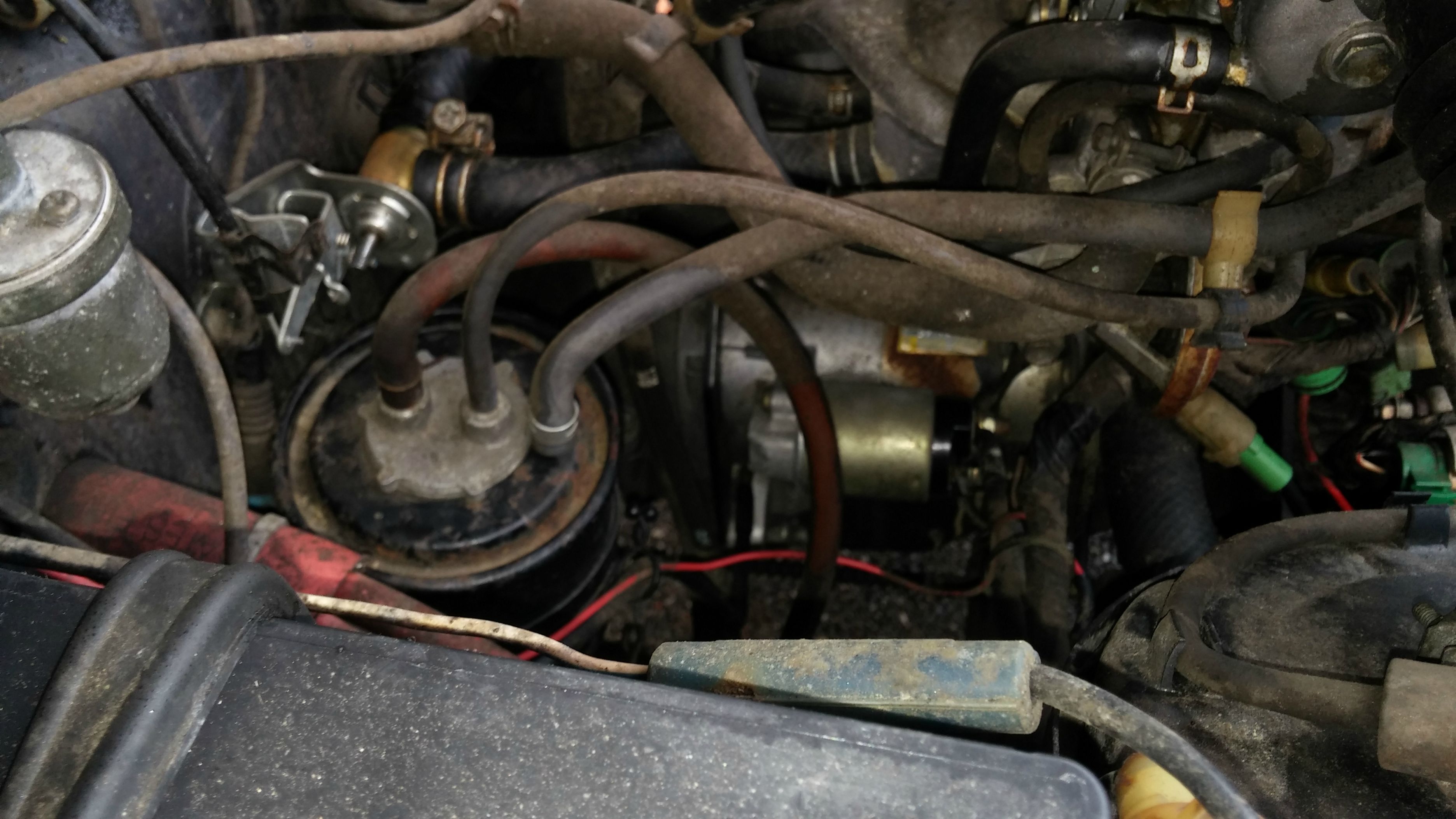

Here are some pics of the engine bay.

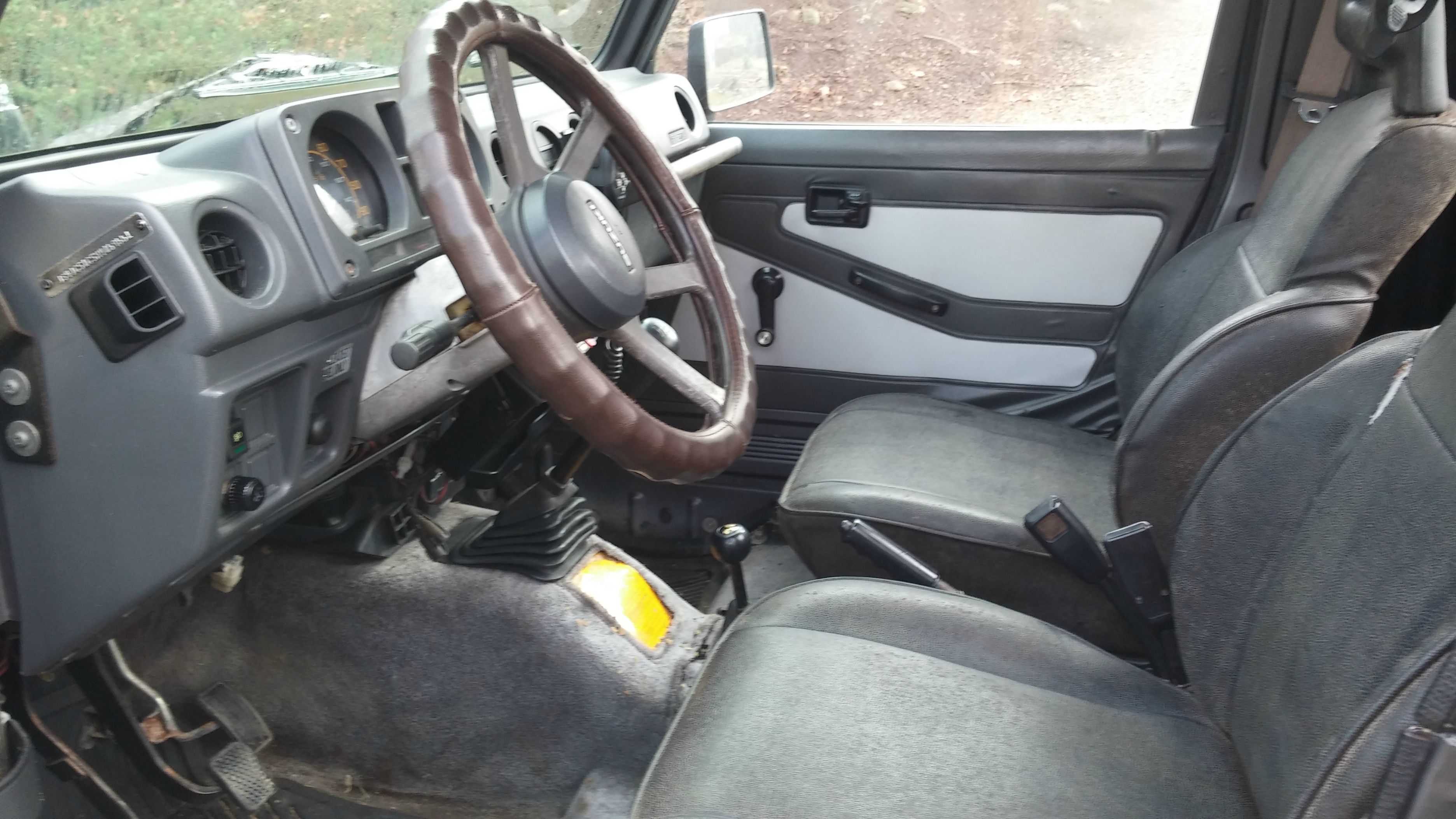

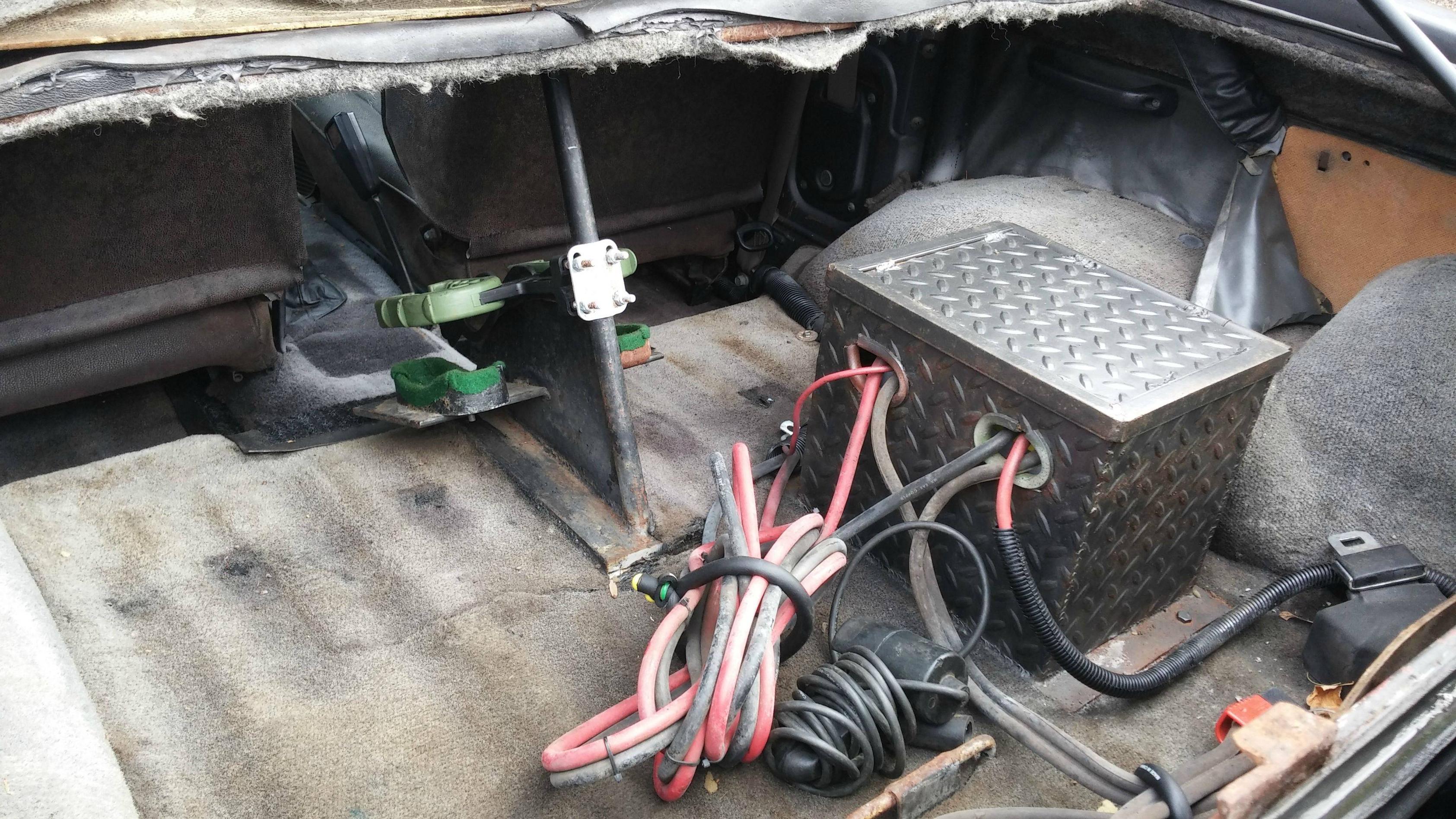

and some interior pics
That actually looks like a pretty nice rig! There's a lot that I'd do over time just to make it more comfortable/dependable, but it's a nice setup. I'm not so sure about the rear-mounted battery. It's a nice box, but those exposed cables leave a lot to be desired. I'm not sure the 2nd battery is even necessary, really. You could get by with the one. You're probably rarely going to have to make a long pull with that winch. Upgrading to a 105A GM alternator would probably be a more effective charging system upgrade.

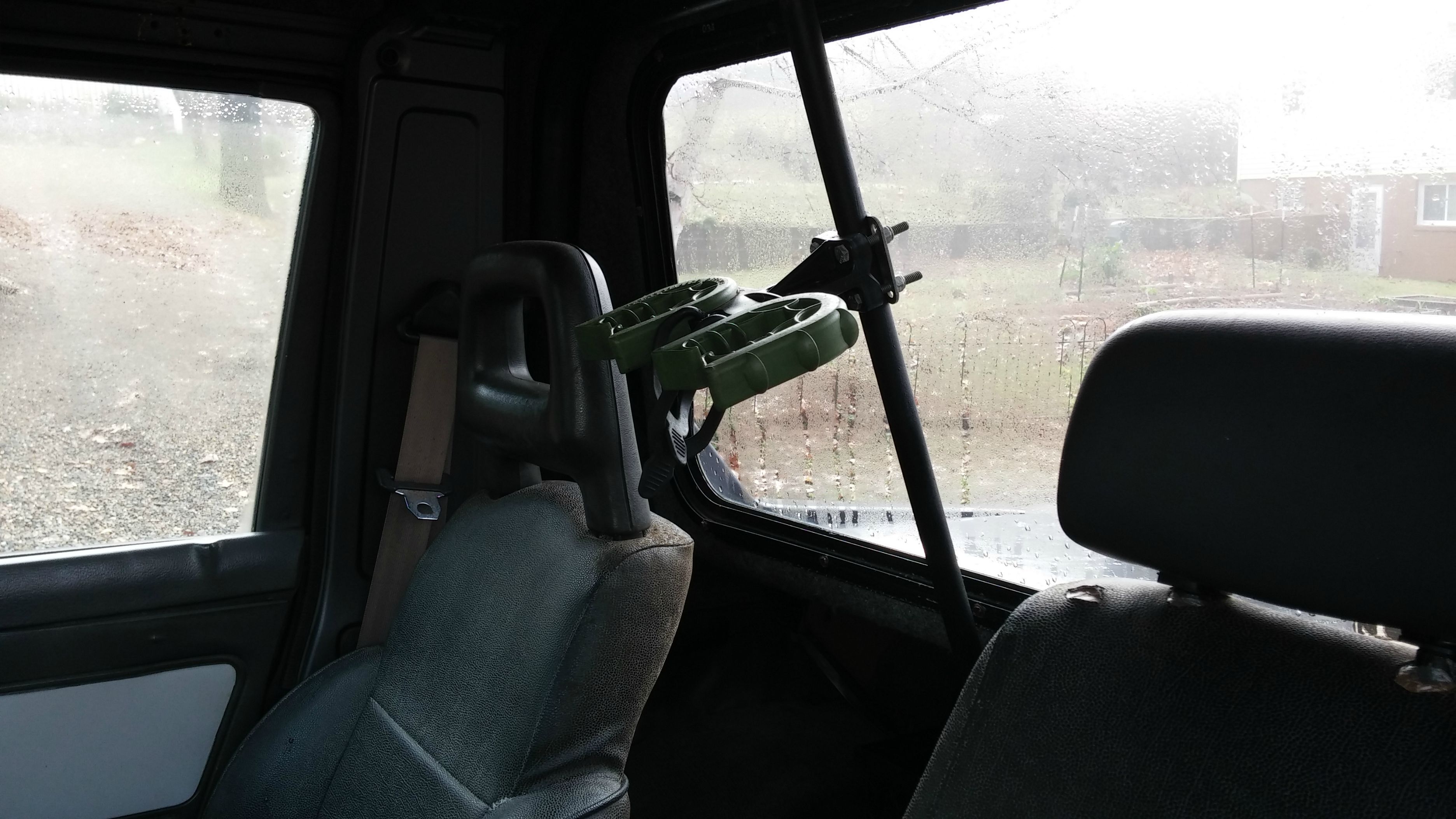

Who did you buy it off of? That gun mount looks familiar. I think I saw the build on that years ago on Zuwharrie. I think somebody was producing one for a while, too. I'm just wondering if there is a build thread or some information about it over there.
It was for sale on consignment at a little car dealer in Maggie Valley for the dealers friend who is like 80 and got it from his cousin. The gun rack is welded to the floor :confused:. it rides like a shopping cart so YJ's are in the future to soften it up.
I am thinking of swapping a 16v head and efi next year since the block is for a 16v already and power steering.

The clutch cable could have a rusted casing allowing it to kink. Make sure it's a smooth loop.
The shift lever slop isn't bushings , it's a lost, broken, or wornout shifter bolt. (if you're on zuwharrie, search for it there)
