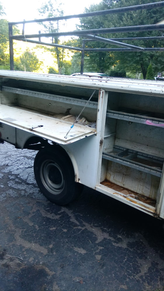

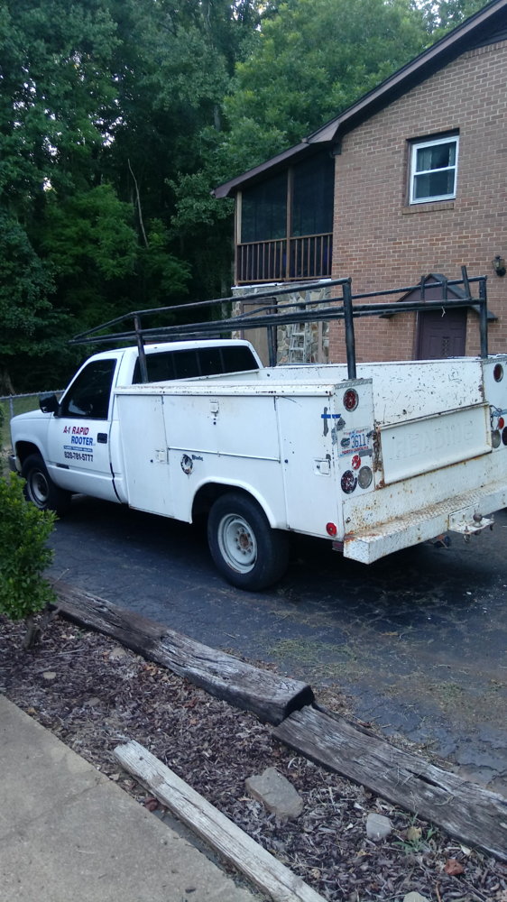

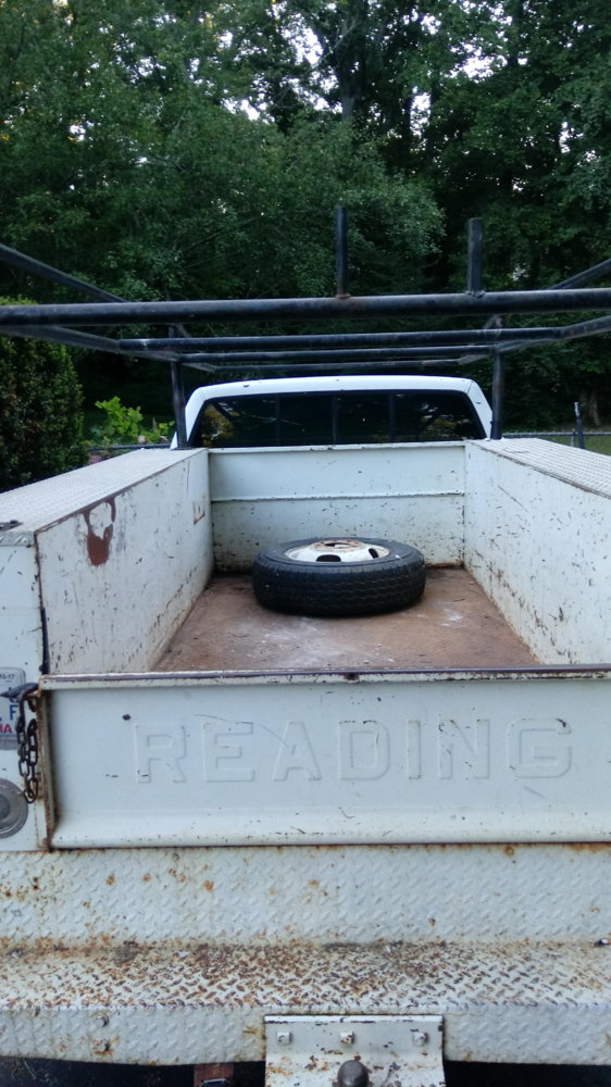

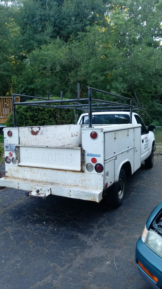

Well I scored pretty good (for me) on a legit tow rig..for me finally since we're settled and ain't going anywhere!!
Major Project for sure but will be a cool towing/work truck!
89 Chevy 2500 2wd truck with Service Bed.
5.7L, Auto 3spd, Carburetor, 4:10(mechanically unconfirmed), basic of basic model lol. Manual window, no factory radio (didn't even know they did that haha), load E tires etc. Gonna be a project but will be nice rig eventually.

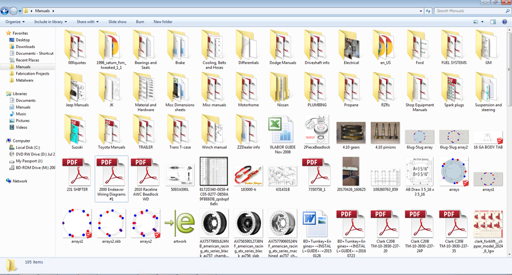

John...you're a smart guy. Do what I always do. When I buy something I am not familiar with or have no background in, I go immediately and download, (or buy), a Factory Service Manual, or at the very least, a Haynes manual. Familiarize yourself with what you have. Your questions will be 95% answered there! (see attached pic...!) Def worth the $10
