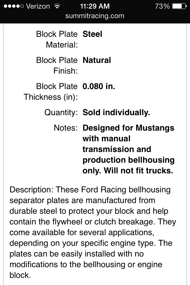

found this...seems to be the best of all worlds lol and fair price for what it is...
Ford Starter Block Plate
Now one plate, one part number fits all 289-351 Ford engines whether manual or automatic transmission equipped 157 or 164 tooth flywheels. Protect your expensive starters, flywheels and torque converters with a block plate that ensures perfect starter/flywheel alignment and correct torque converter back spacing. Ventilation holes are provided to ensure adequate air circulation. Manufactured from .060 steel and gold irradiated, a removable starter spacer provides for exact starter positioning to prevent starter kick out and flywheel damage on either 157 or 164 tooth flywheels.
Applications
Part Number
Price
FORD STARTER BLOCK PLATE - FORD 289 - 351 ENGINE
915116
$81.95
Post #24?
from hours of searching the mustang ones will not fit...didn't say why but every site/forum/parts place said not the same...so complicated lol thank you though...well how could we get that to boone quickly...how much for it cause the mustang ones will bolt up but starter area is different but i could buy those starter shims at advance and just modify that one to work is price is right. thank you
