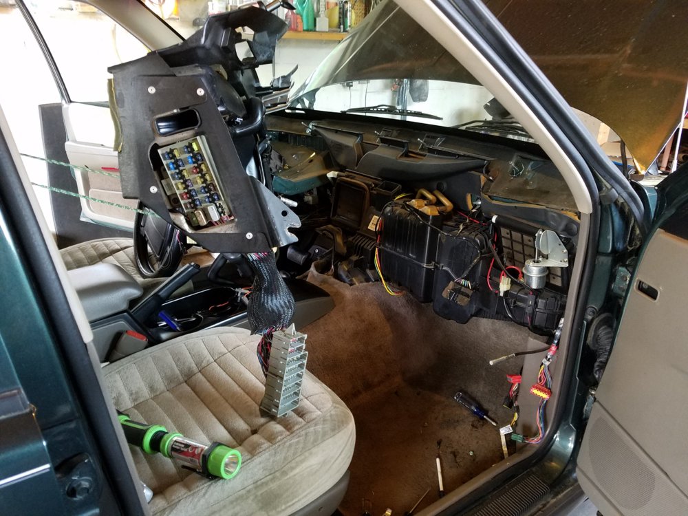

My fathers 94 ZJ is leaking from heater core, debating on doing it myself.. Suggestions...
Never done a ZJ but I've done plenty of XJ's. Look it up on YouTube and go for it.
Give me a call tomorrow if need be. I've done literally hundreds of them.
The dash has to get unbolted a laid back across the front seats.
Then unhook the ac and heater hoses from the firewall. A few nuts under the hood hold the HVAC box to the firewall.
Remove HVAC box from inside and the heater core is on top, held in with a few Phillips screws.
Not a hard job at all just time consuming.

Welllllll... Halfway done!
I've done it on 2 zjs and i say this, 10 hours has never sucked so bad! A 98 Kia Sportage takes the cake for me tho had to take steering wheel out and disco frame for dash... 18 hours for Kia
We also put new unit bearings, track bar and steering stabilizer on the front, he is gonna be one happy fella
