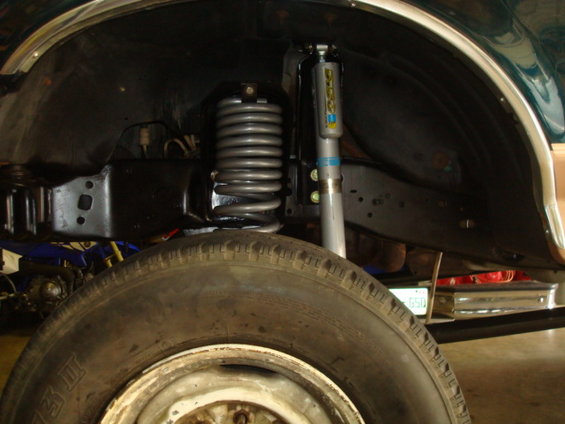

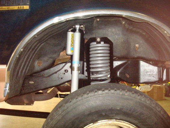

Front shocks mounted
DS
PS

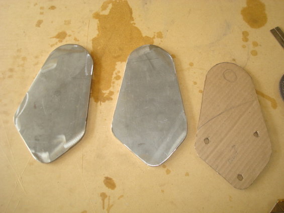

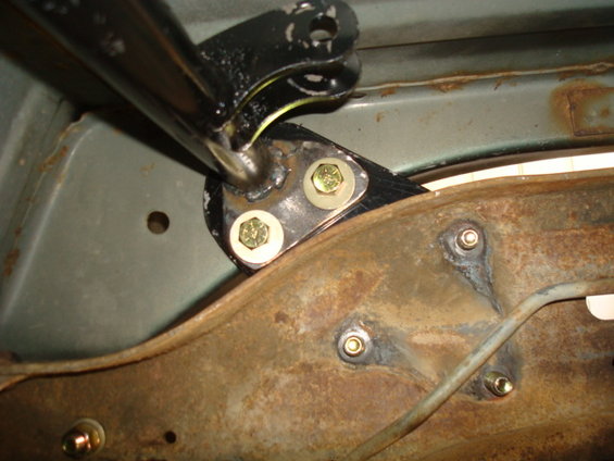

My mounting brackets cut and ready to be drilled. I tacked them together and drilled the holes, that way they would mount the exact same.

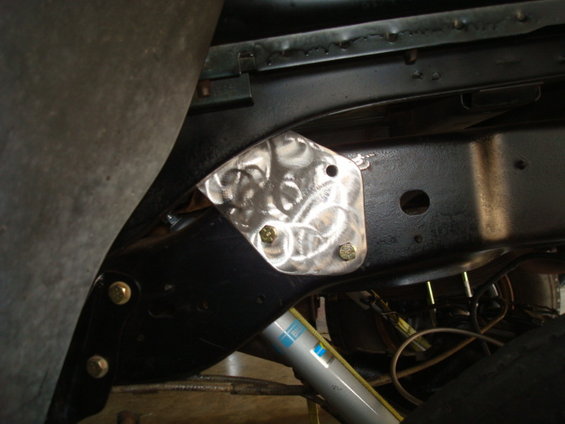

Here's a pic of the Drivers side in place. I drilled out the stock shock mounts and use the original holes for these. I didn't want to do anymore drilling in the frame.

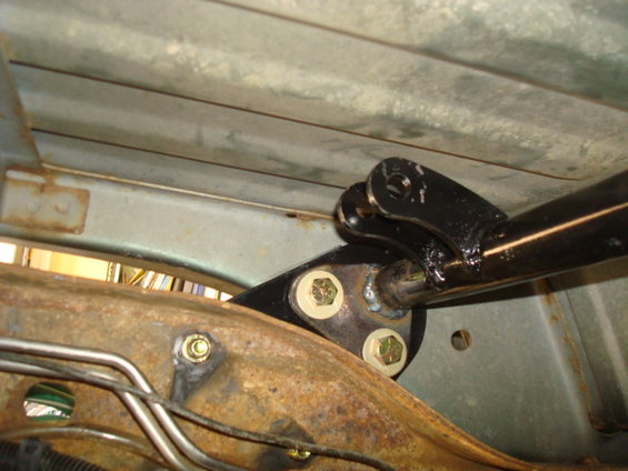

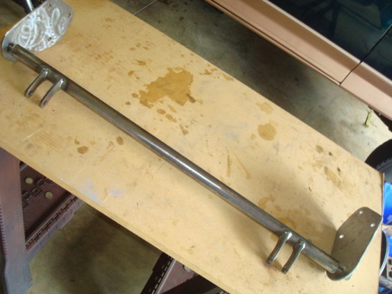

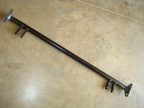

Here's the rear shock hope with the tabs welded up and ready to be painted. It's painted and ready to go in. I ran out of time before going to work so I'll install it tomorrow and take some pics of it installed.

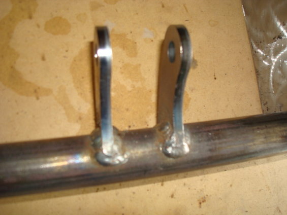

Here's a crappy pic of one welded up. I could have made my own tabs but I figured for $10 bucks I'd just order some. That way all 4 would be identical. I think the welds look ok but I think I could have done a little better.
As far as the SAS goes the rear shock hoop will finish it off. I'll do some test driving and some flexing to see if everything is ok and then go from there but I'm hoping all is good and I'm done except for some minor things.
DS
PS
