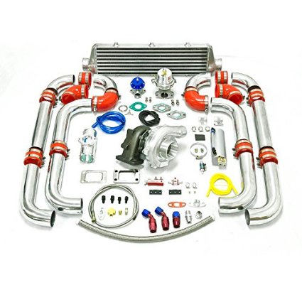

$544.00 is all i would need...i'm not trying to build a hot rod but i figured it would be worth the money for say....6-8psi boost, just enough to give that extra pulling steep grades

Yeah that system is not going to just work on your TBI Tahoe. You can't add 6-8lbs of boost to that tahoe without adding a lot of other things to support that "kit" You will need AT LEAST:
TBI intake adapter to the charge piping
A lot of custom exhaust work
higher output fuel injectors
higher output fuel pump with adjustable regulator
new MAP sensor that will handle 1.5-2 bar
A good tuner that still has the ability to burn chips (harder and harder to find someone good that still deals with TBI/TPI)
This is the absolute minimum
On top of that you still have a junk turbo with junk parts that will probably just blow that tired 350 up

You are thinking of using an Audi diesel 4 cylinder diesel turbo on a 5.7 gasser???
no it came off a v6 twin turbo i believe...i'll have to ask the guy what it came off who gave me the setup

That is probably one of the poorer choices for adding additional torque. Those transmissions are marginal at best stock.
Don't skimp out on fuel system components.
Cheap turbos have cheap bearings and machining. You don't want some $1 a day kid assembling something turning 100,000+ RPMs that is attached to your engine.
Research, research, research!
I wouldn't put a turbo on the tbi motor period, save yourself a lot of time and headaches and stick with the gears or spend a little time hunting and you can probably swap a 5.3 or 6.0 for under half what that turbo kit would really cost you. TBI is easy, cheap and reliable but not the easiest setup to modify for power. Carburetor or LS for power.

Turbo adds air you get that.
If you dont add a corresponding amount of fuel you aren't really improving anything.
