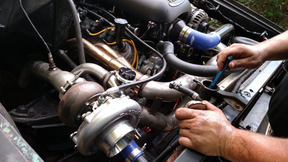

I will say this just because I just helped finish a turbo build 5.3 cost alone without the motor, just parts to build the system was right at 1500 he then had to buy new injectors and have it tuned that's close to 1200 total. His cost more than that cause he had a stand alone computer and cut down harness that I didn't add in. From a cost effective stand point 4-5 lbs is point less on the horse power and torque gains.
And cause everyone like pictures
so it is confirmed there is NO CARRIER BRAKE?? just want to make sure i'm researching right before i plan to buy some bigger gears...surely 3:40s to 4:11s ought to be worth the 500
And cause everyone like picturesView attachment 197355
freaking AWESOME AWESOME...yeah maybe i will wait and just pick up another one of these Audi Turbos and just twin turbo this thing then down the road with a built 350 to handle it and make a crazy sleeper out of it with a way to switch the turbo on and off for putting around town...that's been on my mind for years to do to my next Tahoe i bought and this one might be "that one" later down the road lol...it would for sure be one of few on the road and boy would i love to see the look on all them WRX/STI people when they "expect" to spank you by a mile and you're right on their tail!!!
.... You can't just turn a turbo on or off, turn down the psi possibly but not turn it off that would also require multiple tunes to be burnt into the computer other wise the motor will run like shit cause it needs more air. Also the Audi turbos might be to small for what you're wanting to put them on

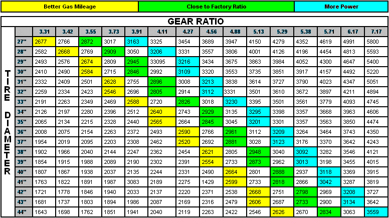

Dont guess.
Look int he glove box and find the axle code
GU4 - 3.08
GU5 - 3.23
GU6 - 3.42
GT4 - 3.73
GT5 - 4.10
G80 - rear axle lock
and here is a helpful little chart
