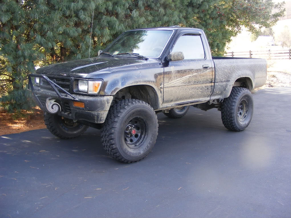

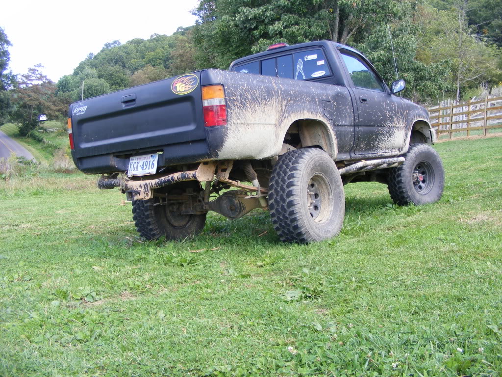

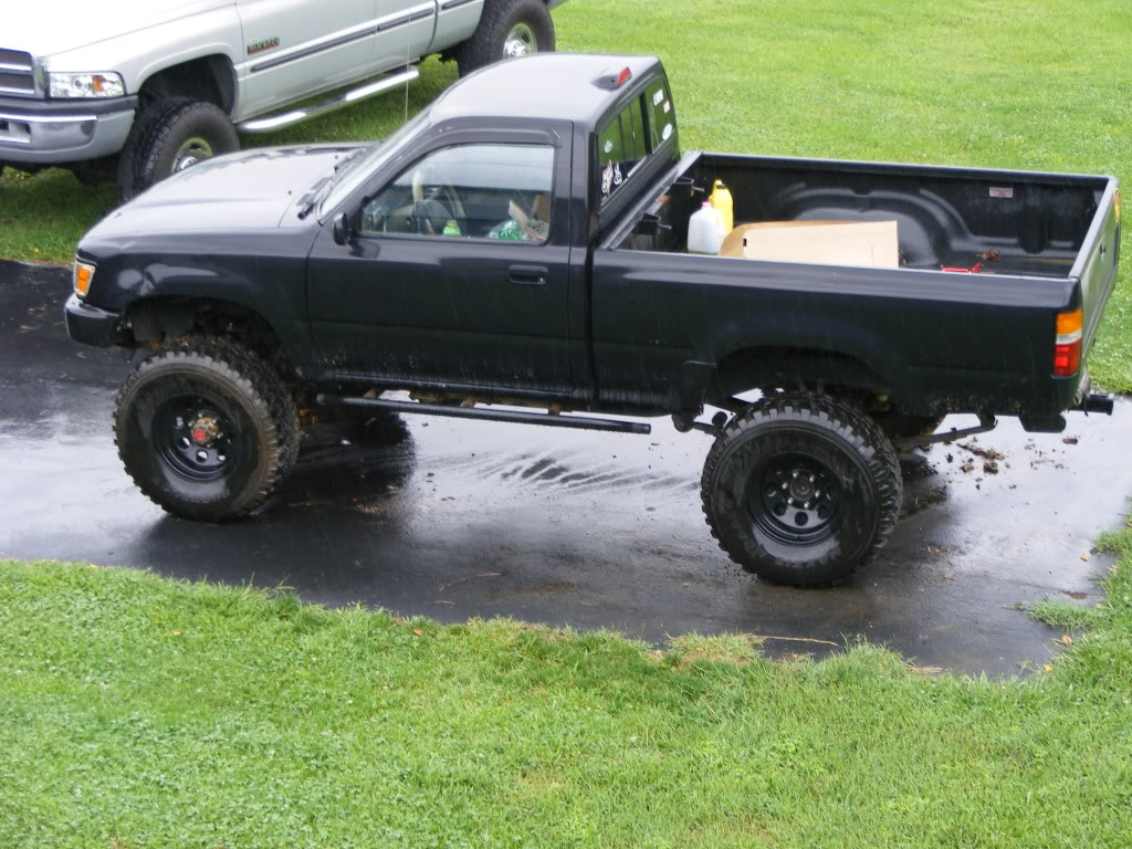

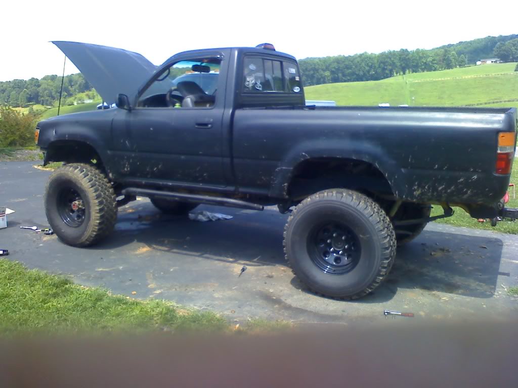

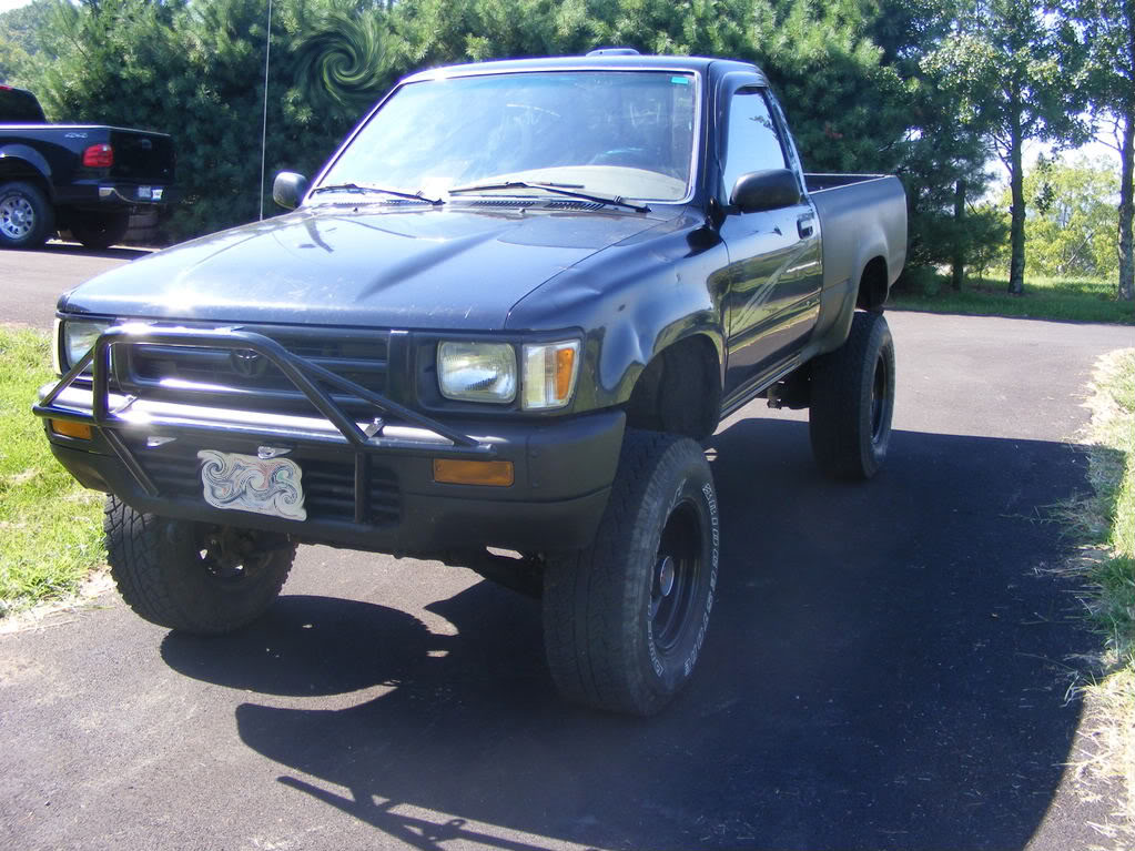

figured id throw the build of my 95

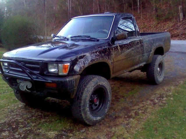

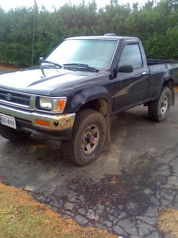

here it is when i bought it oct 07 for $2300
new bed and some balck steelies

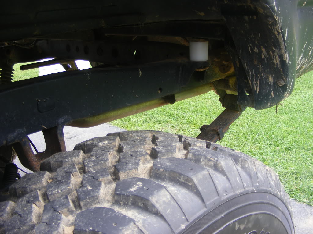

1.5in bja spacers, 1.5in tbar crank, 3in AAL
relaxed the tbars cuz the CV angles were so steep it ate 2 CVs in a week, thru in a 2in AAL

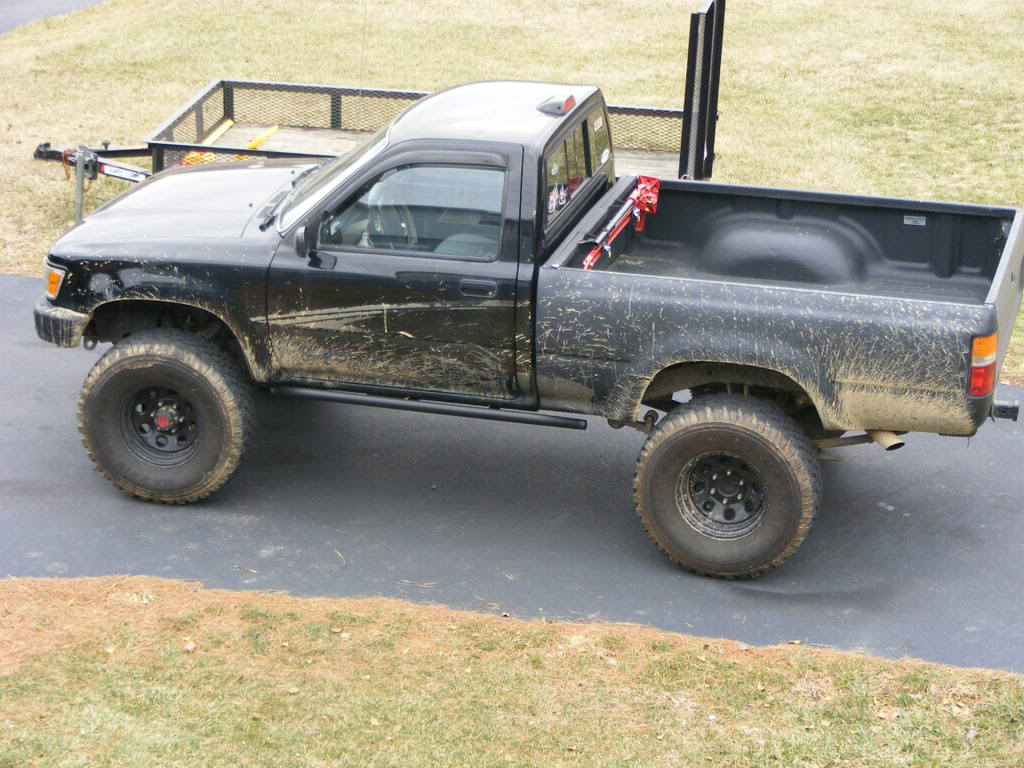

33x12.50 maxxis buckshot mudders

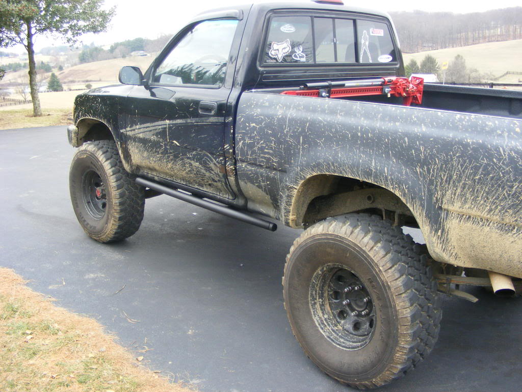

hi-lift mount
TG sliders
a few poser shots

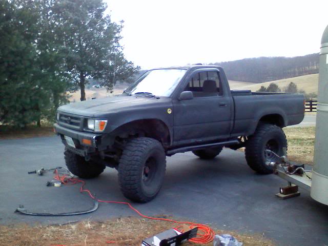

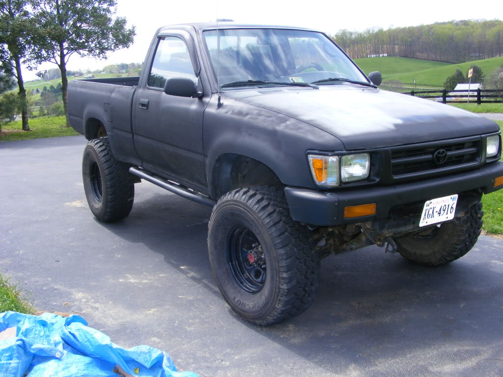

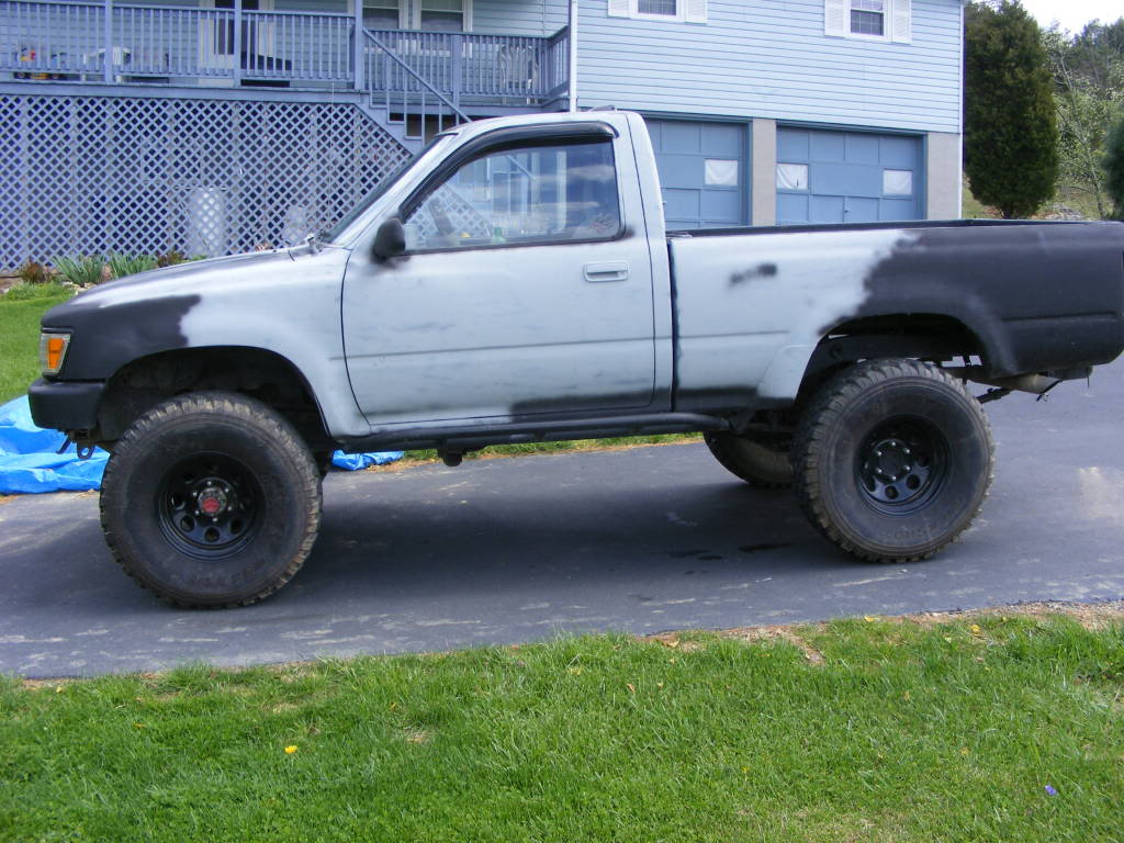

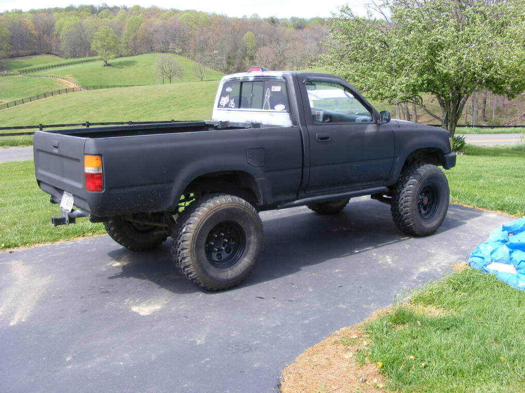

a little rattle can

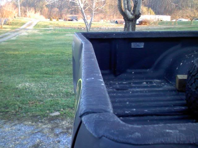

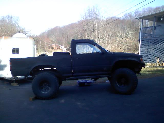

2inch body lift, bed
finished

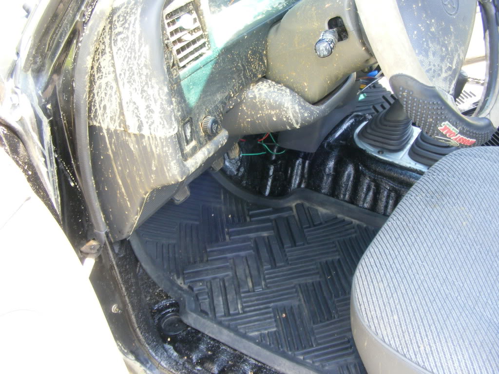

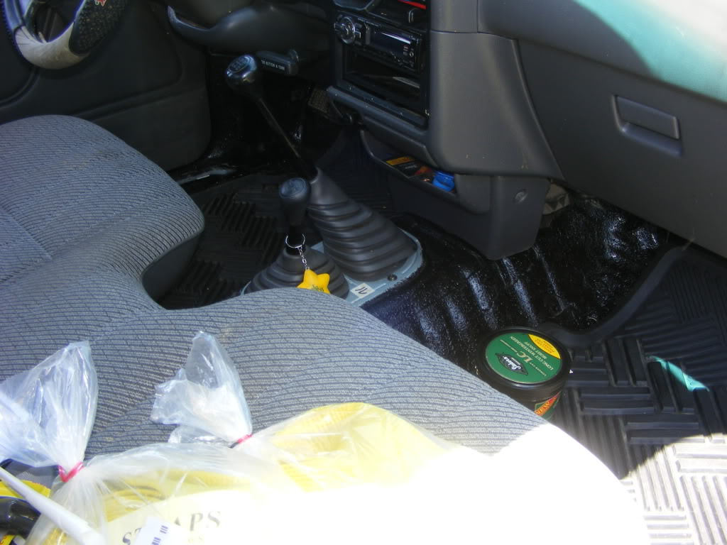

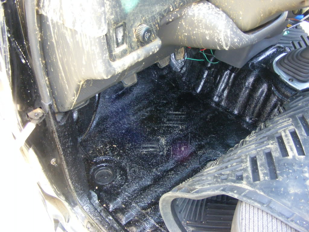

herculined floorboard
not a build like most of them on here, but when i got my truck i was 16 and thought a big lift and gimoungous tires would make it go anywhere. and we all know how that goes. a little backgound info, i bought it oct 07, sold it with a blown HG october of 09, then bought my 85 jan 2010, and teh following week bought this truck back. but now the rings are broke and it was burnin 5qts of oil a week. so its in the shop right now gettin rebuilt, and my Marlin Crawler HD clutch came in today for it. itll be my DD when it gets done. and then the 85 will begin, if i can geet it runnin. anyways thanks for lookin!

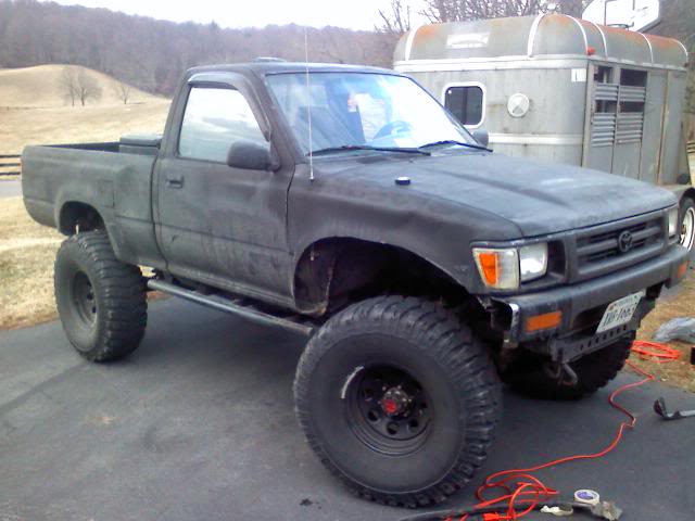

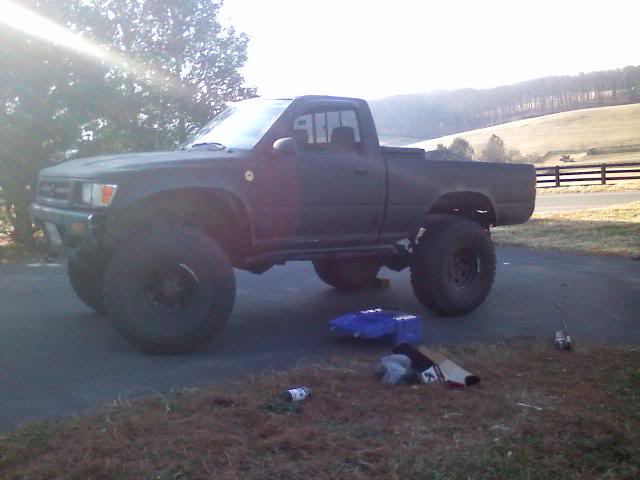

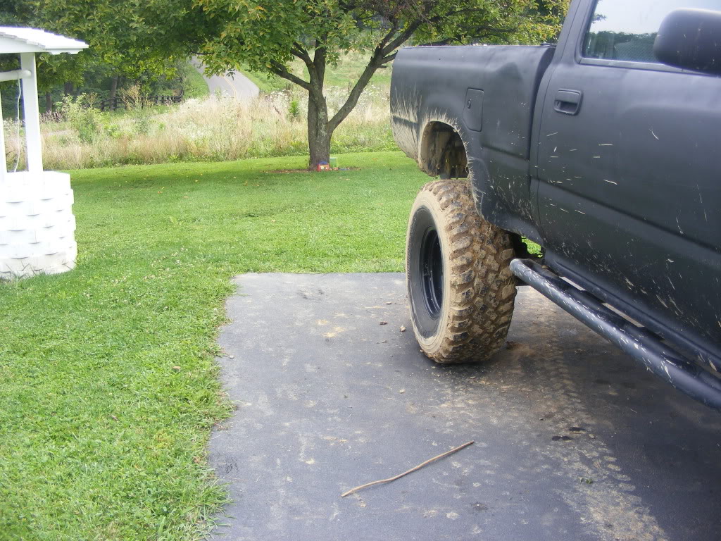

yea i kno, they look kinda goofy but ive never gotta around to movin em up. i wasnt plannin on puttin a BL on, but i got tired of rubbin when i was wheelin.

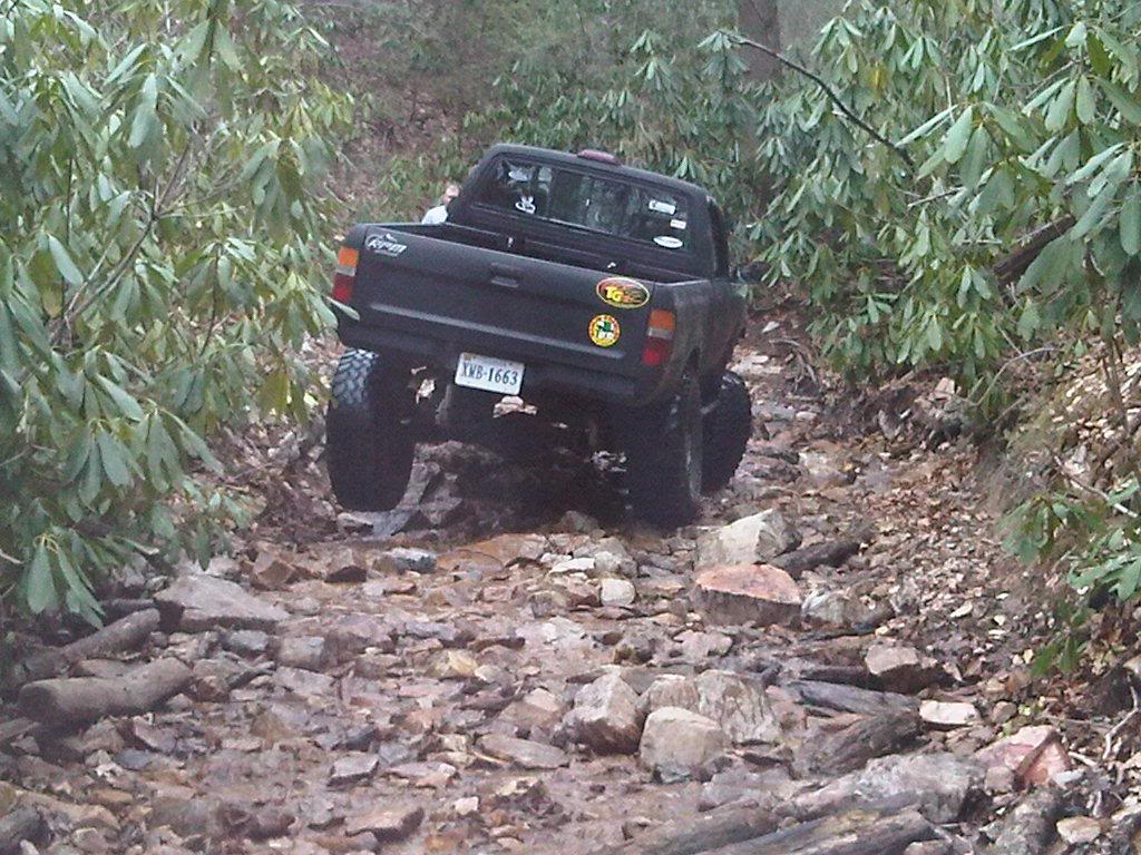

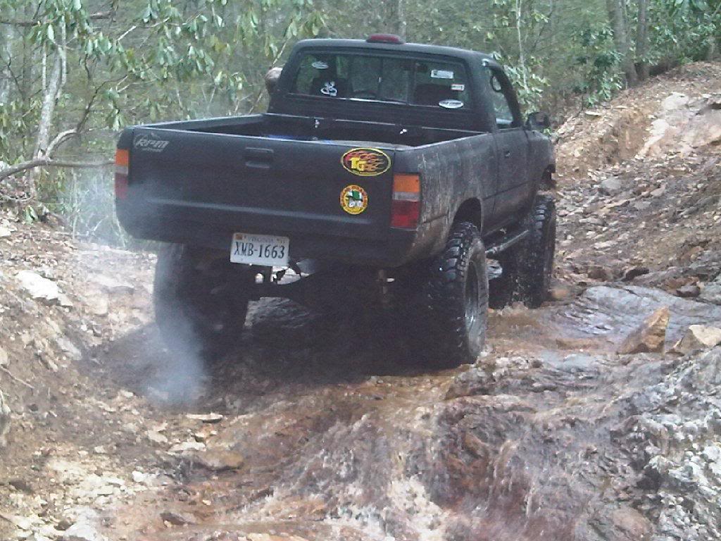

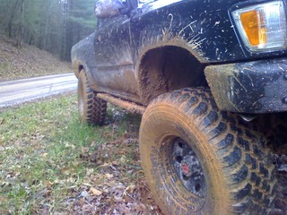

threw these 35 xterrains on after i figured out i hated the bfgs. one callentee trip broke about 14 lugs total off all four tires!!! im thinkin about takin teh body lift off aand cuttin the fenders out. i wouldnt mind to have to back low again
callentee
xterrains

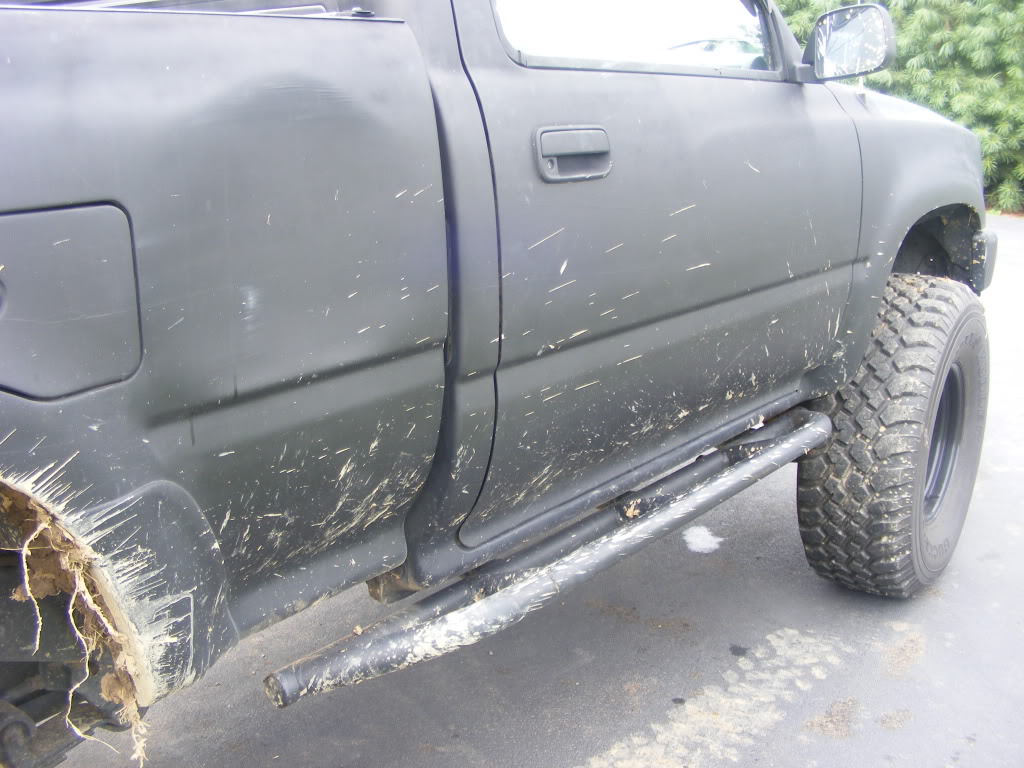

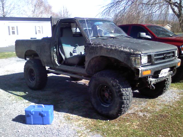

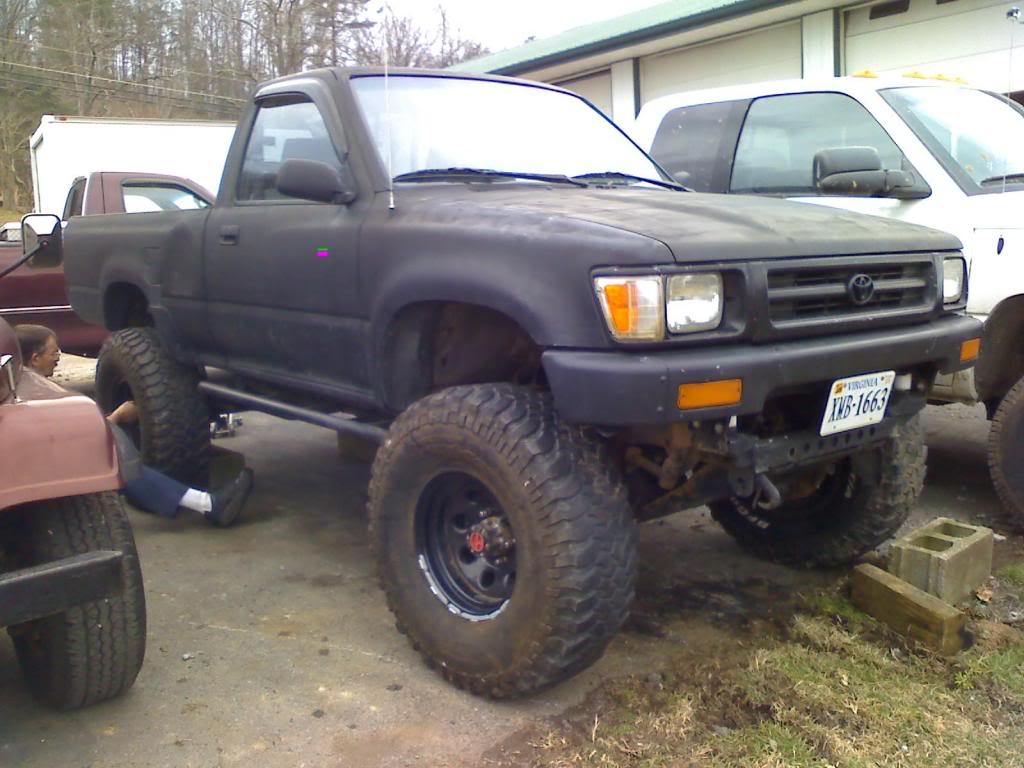

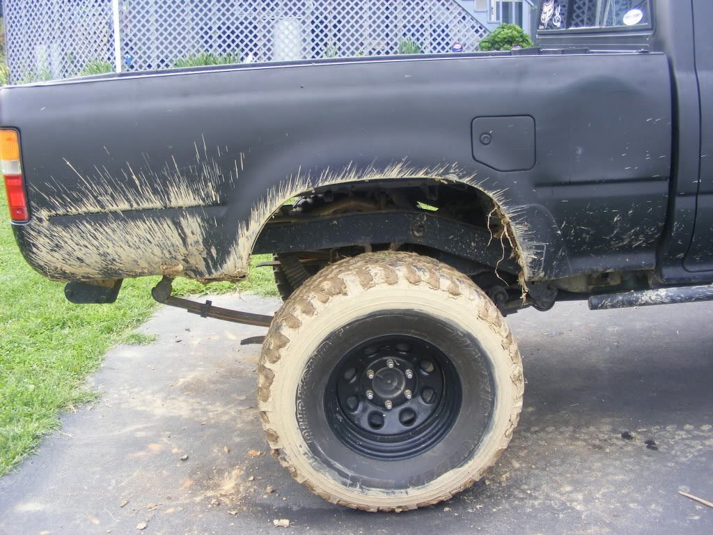

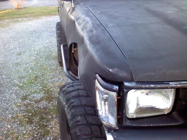

finally some progress pics. got my front fenders cut yesterday, and cut the rears today. was goin to put the rear 4.88 3rd in, but then couldnt get the bolts on the dshaft broke loose, so itll have to wait. aint got no pics, but i bought some door guard from advance auto and put around the lip of my fenders, works PERFECT for this. yes, i cut more than enough fro my 35s, but i wanted to cut all the rust out, and follow the same body line. not perfect, but im happy

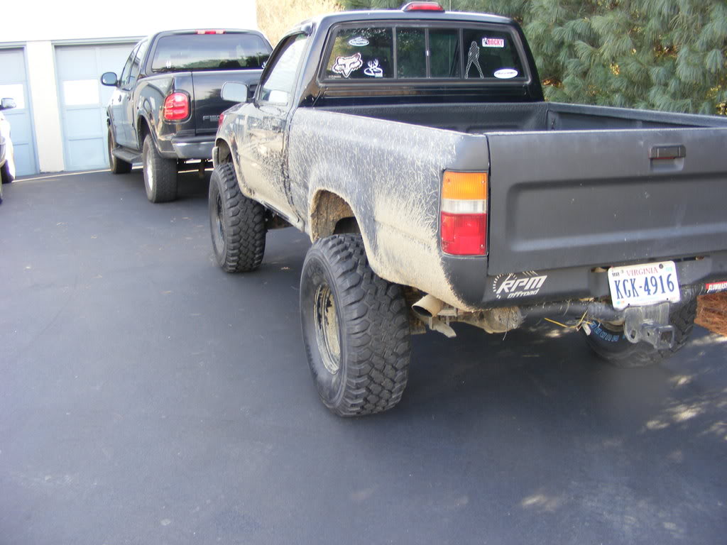

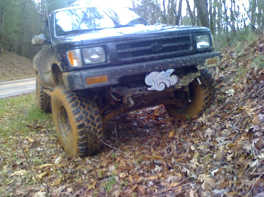

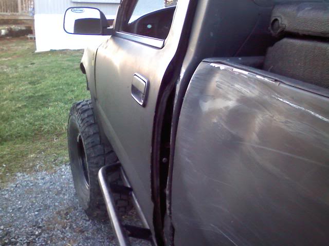

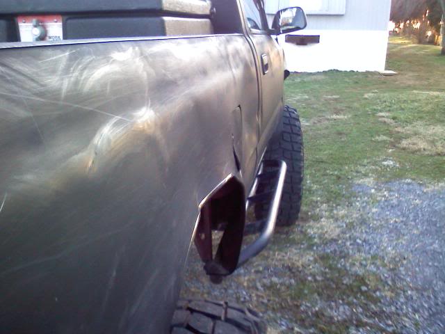

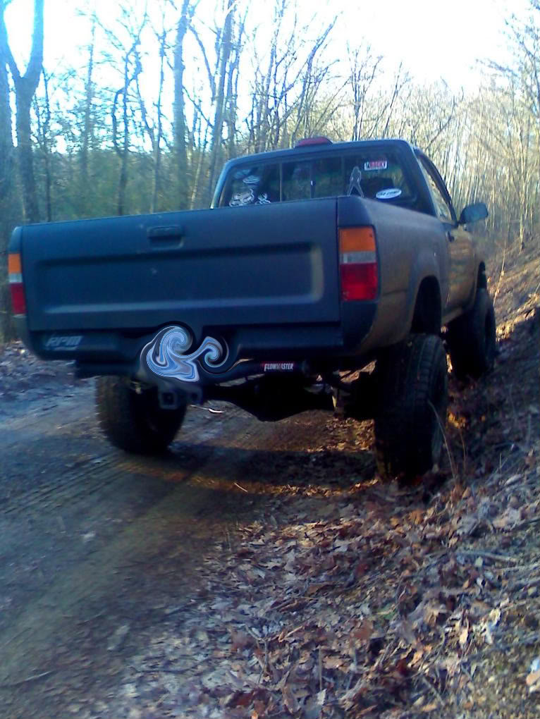

me and a buddy hit mtn city today. wow. what a bad day. there is no longer a straight piece of sheet metal on the entire truck
exhaust studs on manifold and down pipe worked there way out. its done this the past two times i went to mtn city
caved in pass fender
broke pass signal light off

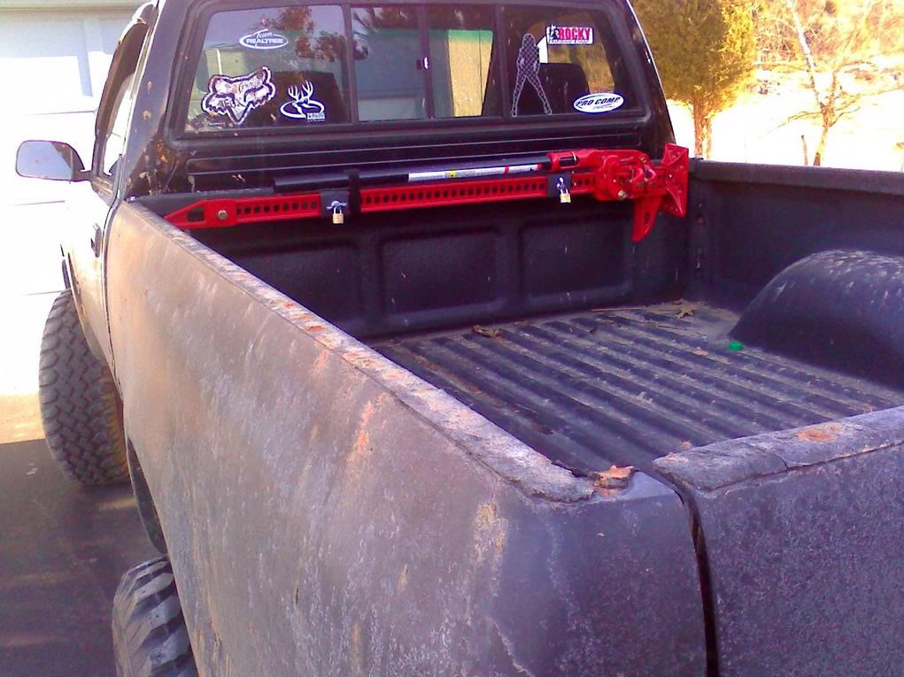

dented pass side of bed all the way down
dented drives side of bed pretty bad

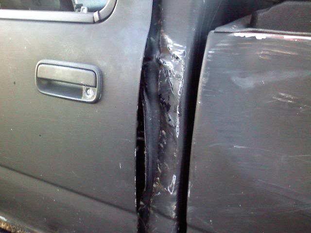

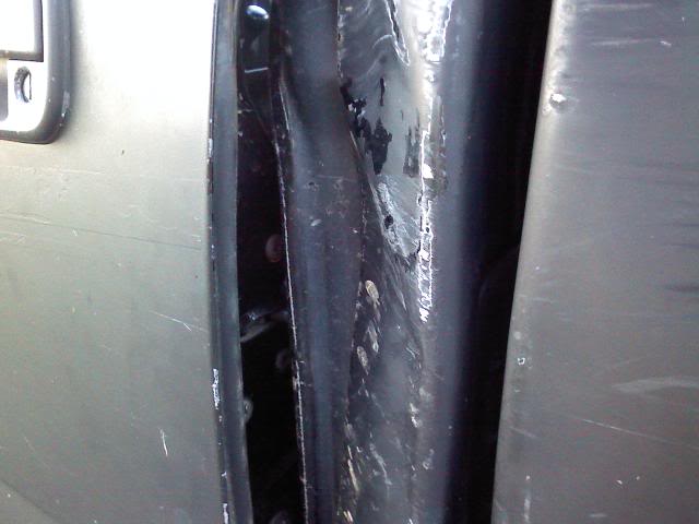

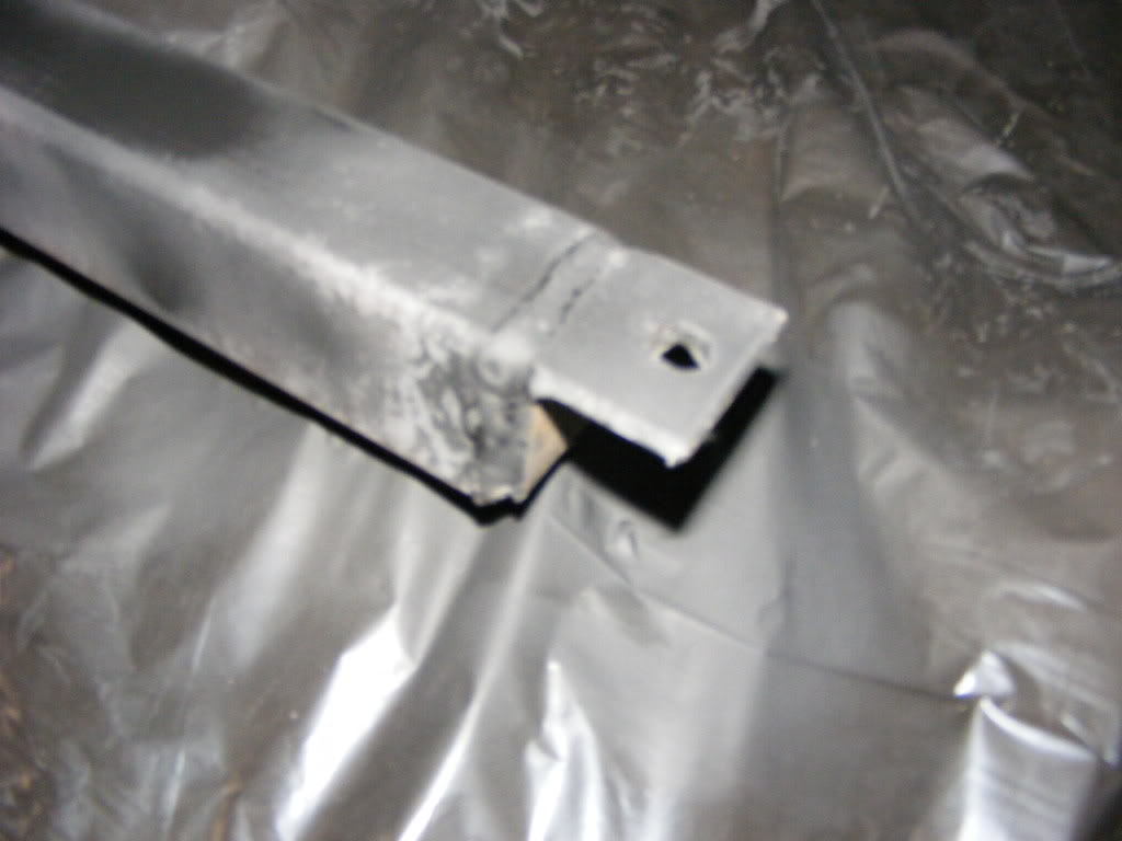

a tree that was cut down somehow smashed the door frame of the drivers side. i was backing back down a trail after i realized it was a dead end. now my door will no latch shut. it pushed the inside of the cab in and back. dunno what i gonna do about this. its my DD so this aint good. i got it zip tied shut now and have to climb out pass side. theres about a 1.5 gap between the door and cab now. im a Little disappointed
also caved my tailgate in after sliding down a bank
cant tell much from this pic. ill post better ones later
Sorry to see that man. Mine has seen the same damage to the cab and my doors don't go back on or even close for that matter.
