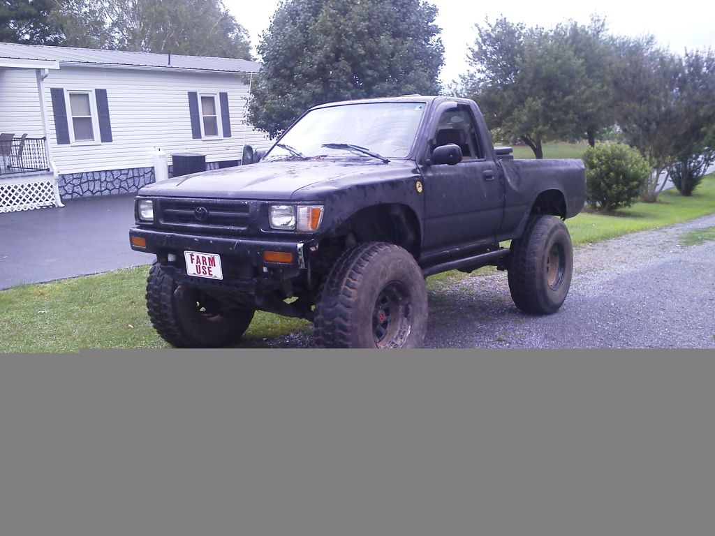

scored some 37 12.50 militaries. still not SASd, still need the arms and dual case adapter, oh yea and shock hoops. me and my wife just bought a house, and we sold our single wide, so looks like well be living with in laws til we close on the house in september. hopefully, fingers crossed, my truck will for sure be swapped by then
should be able to order all the SAS parts this week, or maybe next depending on when my taxes hit tmy bank lol. looking for SAS parts to. let me know what you have. toyota 3rds, dual case adapter, d shaft fro dual cases, shocks, shock hoops, springs, high steer kit, etc
also i would trade the 37 12.50 16.5s on black D window steelies in the pic a few posts back for a good set of 36-40" tires only for a 15in wheels. really want 38x12.50 TSL

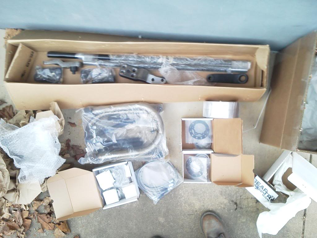

Just ordered TG HySteer, shock hoops, axle rebuild kit, brake lines, and wheel spacers from low range, stay tuned.
haha yea i noticed that. Im glad to see that truck of yours is finally getting what it deserves. seems like it floated around a couple times. I wish I would have bought it!! lol Yours look slike its comin together good
got my parts in the other day from LowRange. They hooked me up with a key chain, windsheild banner, and more stickers. Great company to buy from, and cheaper on TG stuff than TG
