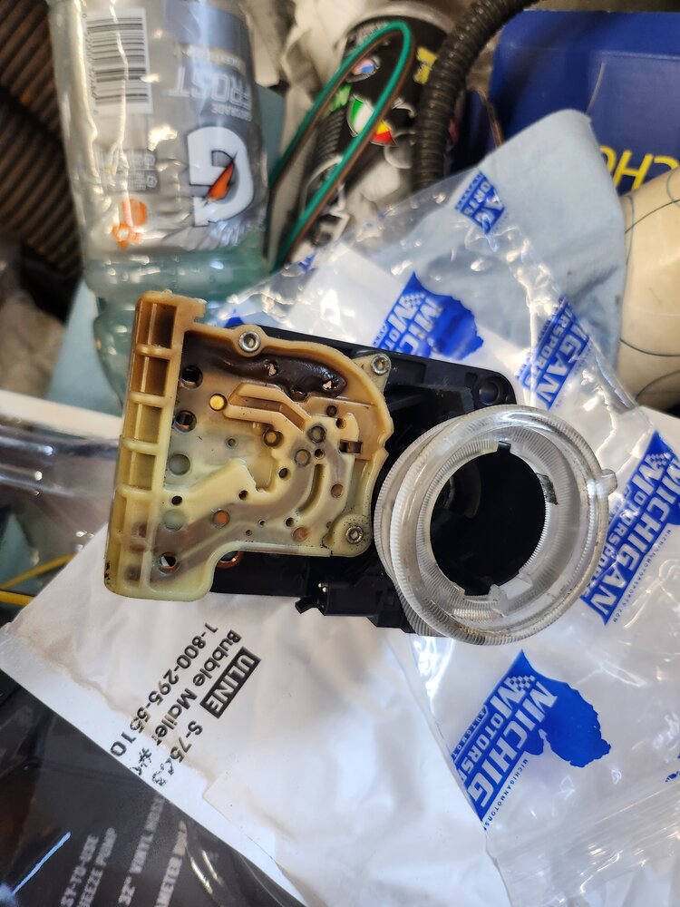

I'm far from an expert but maybe the ignition switch? Maybe it is only getting spark during the 'crank' cycle, but not during 'run' cycle of the key/switch position.
You could use a test light and see if the PCM is losing 12v when you let off the key. It sounds like it is and the only thing that controls that is the ignition switch.
In a pinch, you could jump across the switch and send constant 12v to that wire and verify.
Pic
