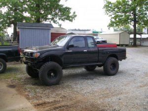

back on my feet a little today, far from done but we had to roll it out to do customer stuff
ride height
got some stuff done this week, thanks foreman for coming over to help
full droop
flex

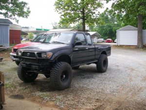

painted
been driving it the past few days, still have a lot of things to finish but at least i dont have to borrow a car any more :lol:

rear just has downey shackles, i might add some leaves to the rear to lift it a little more. front has 5.5" uptravel in the pics, it will drop some with the new coilovers
