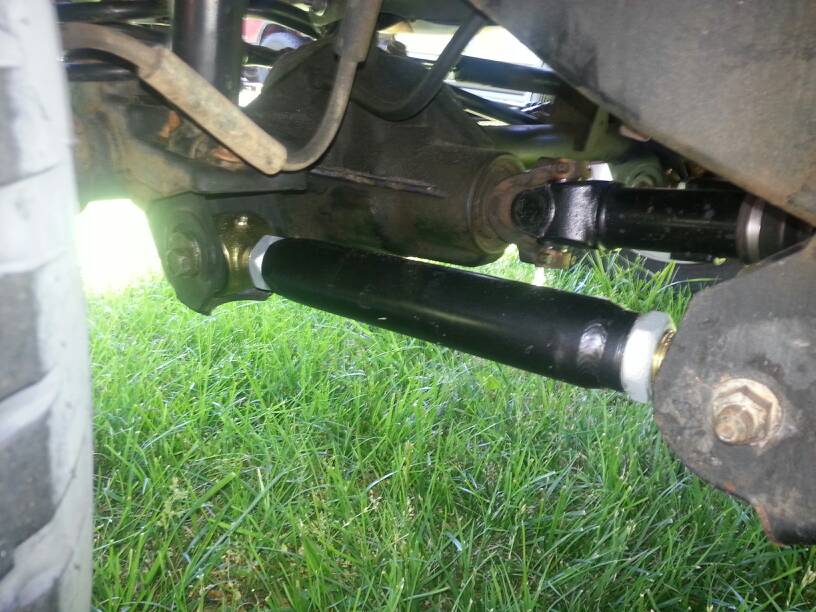

A new set of lowers. Double adjustable with Johnnys and 2" .250 wall link

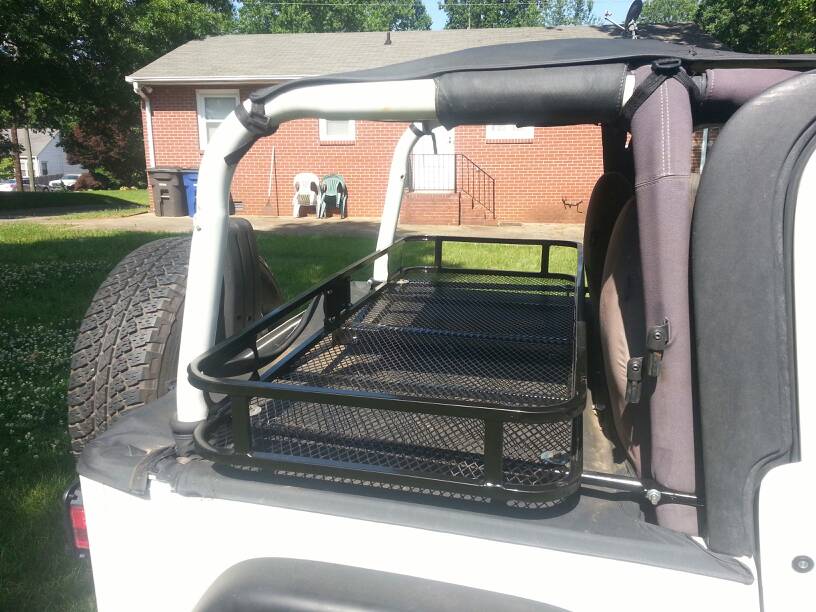

And a 60"x24" cargo rack for the rear

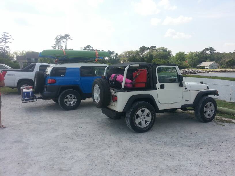

Loaded down for the beach:

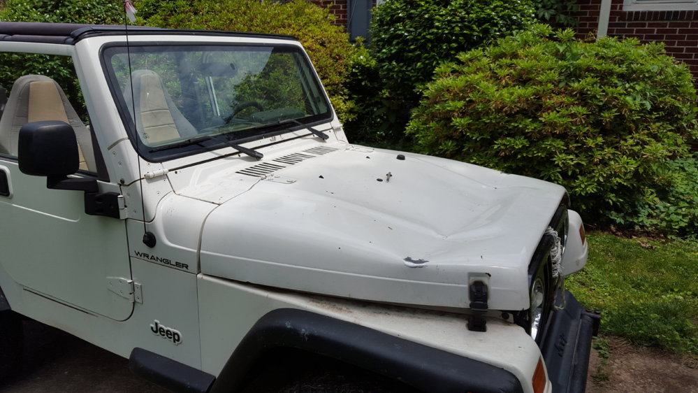

The driver of the project? My hood latches decided to join the entitlement class (and quit working) while I was on the way to work:

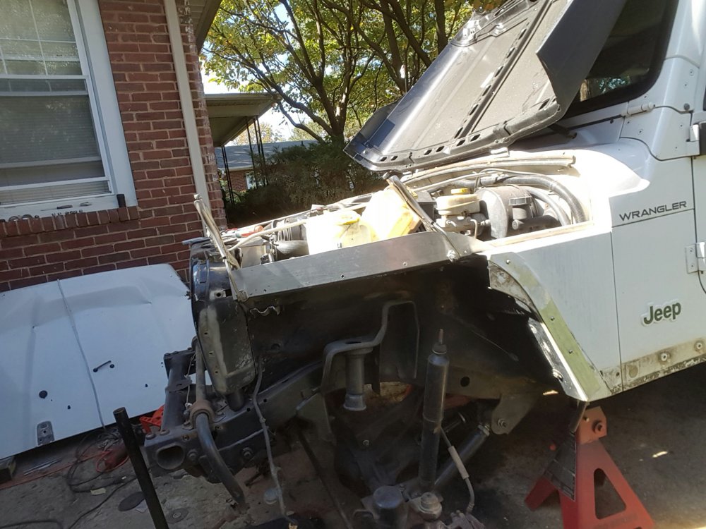

I picked up an unpainted re-pop hood from a member on the board here, but I also had some damage remaining from the bridge excursion so I didn't want to put fresh paint near damaged and dingy fenders:

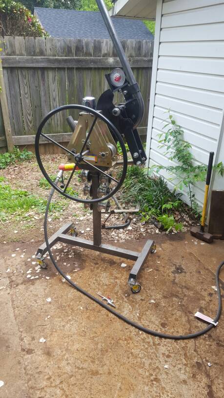

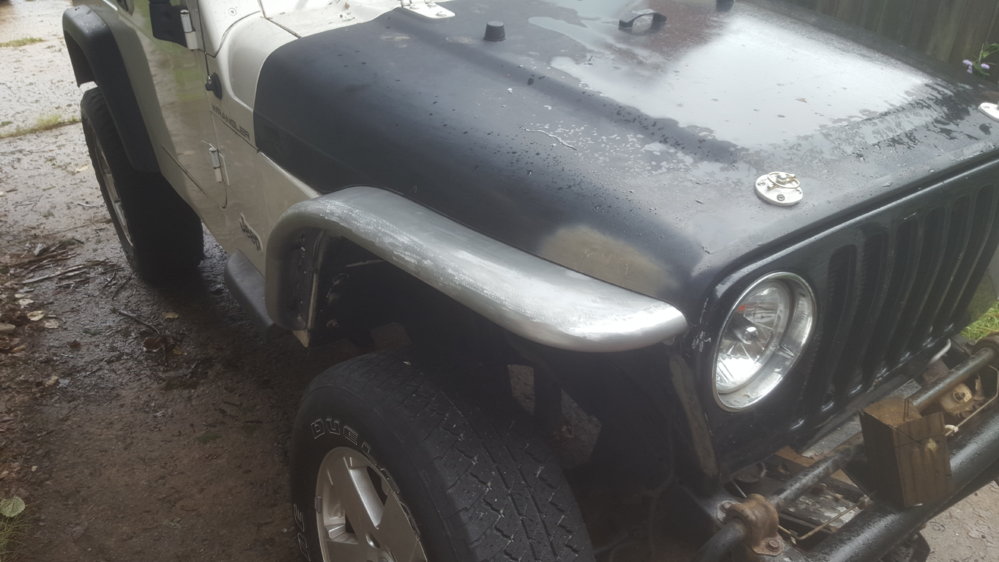

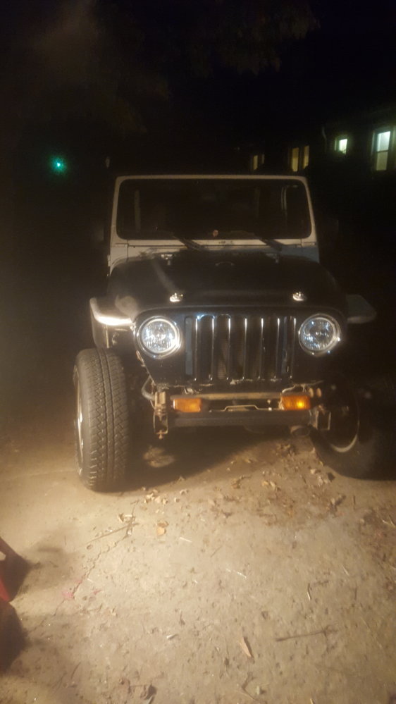

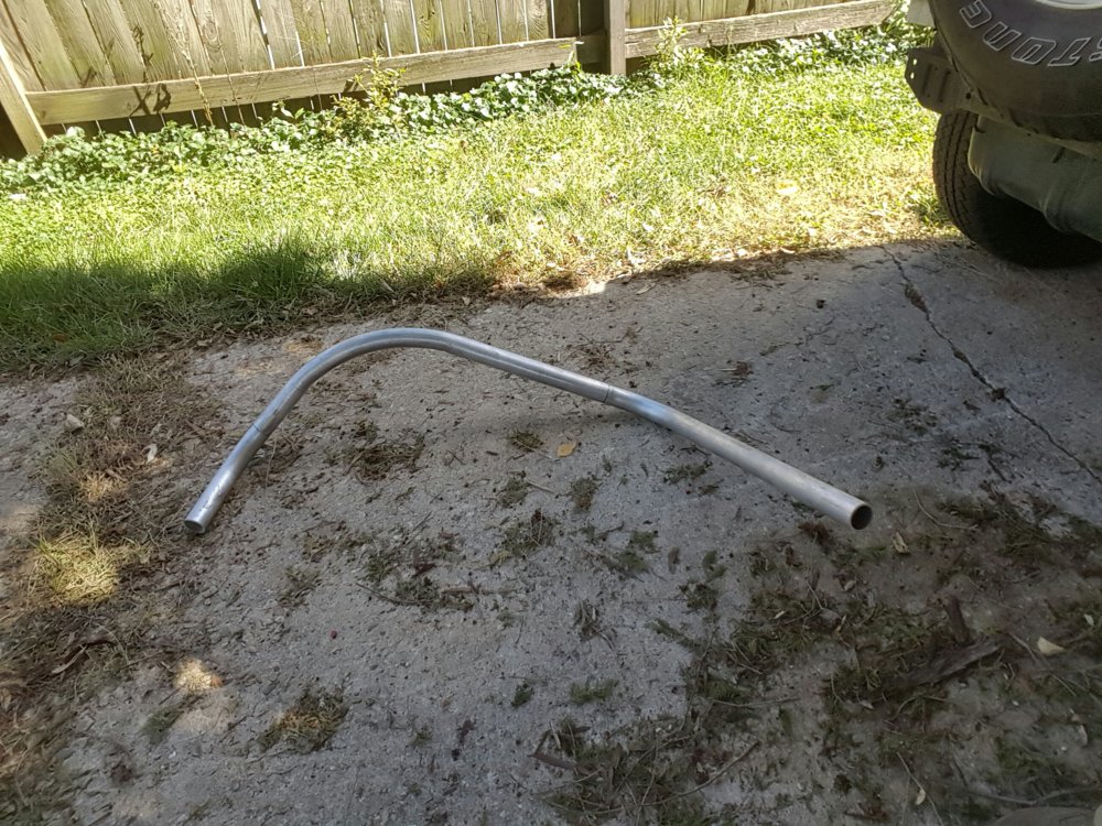

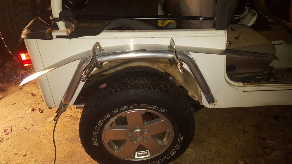

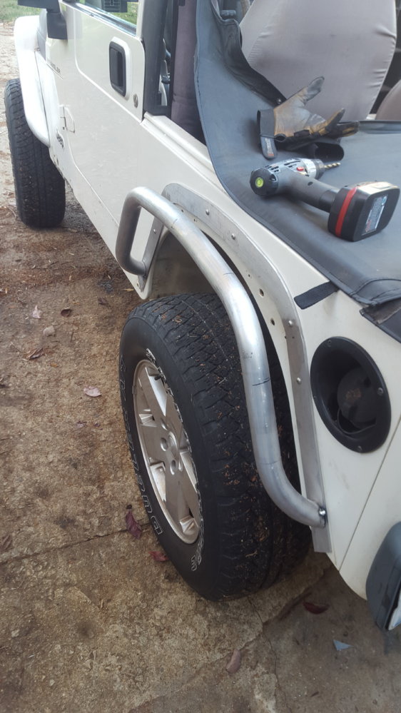

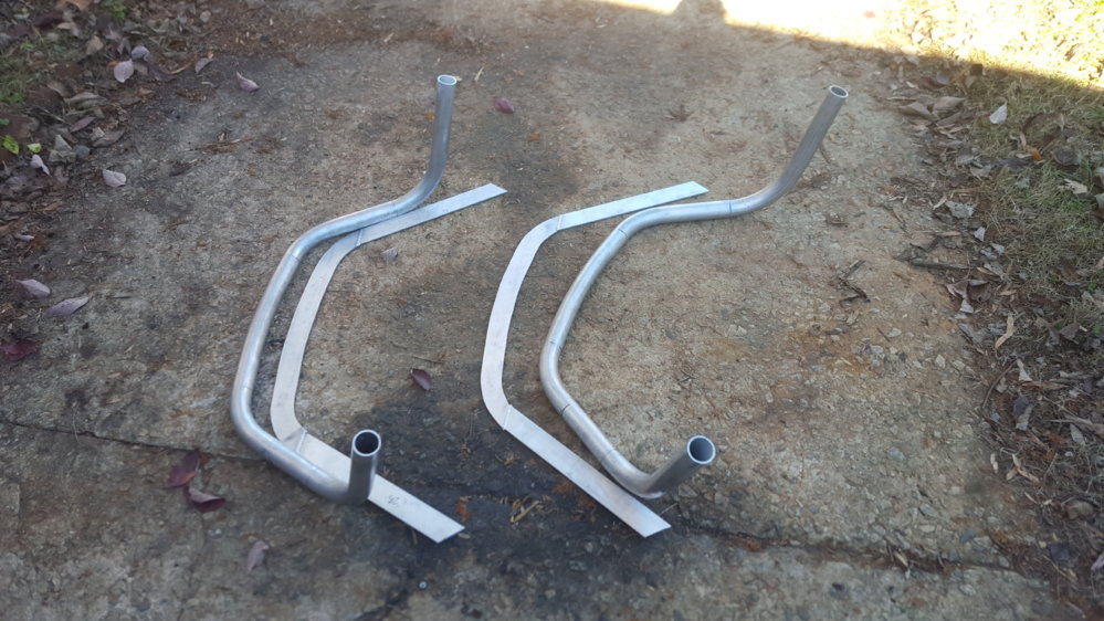

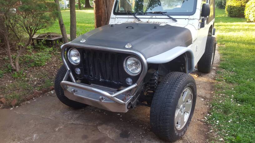

And since the hood wasn't painted yet, why not cut it up? I decided to make some "highline" fender flares, and because i like to make everything difficult I decided to do them out of aluminum. Start out by removing the flares, cutting the fender forward of the wheel arch, and cutting some inner frames:
and add a bit of tube. The large radius is rolled with a HF unit using Swag off-road 1.75 dies. The radius is about 10". The other bends were muuuuch easier with a JD model 32:

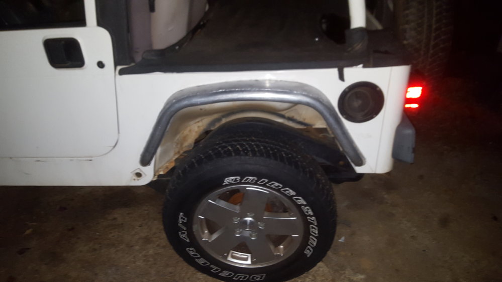

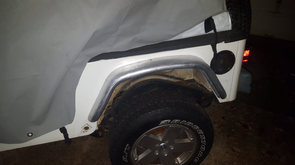

Skipping a bunch of steps (because i have no pictures) abracadabra... tube fender flares, and also hood pins:
And in true 4x4 fashion, they were first both bolted on at 11pm the night before i left for a weekend trip. This time it was only to the Blue Ridge Parkway for a friend's wedding:
This weekend I hope to wrap up the finish work on the front flares, devise some permanent turn signals, and start work on some matching rears.

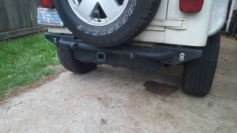

A few weeks back I fabbed up a rear bumper. 1/4" plate outer wings, 1.75" tube, 3/4" clevis mounts, and a receiver for the bike rack:

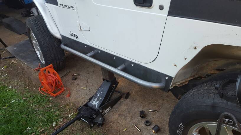

I decided on the Barnes sliders for the wheel to wheel coverage, but wanted some side steps, sooo... Get the bender out.

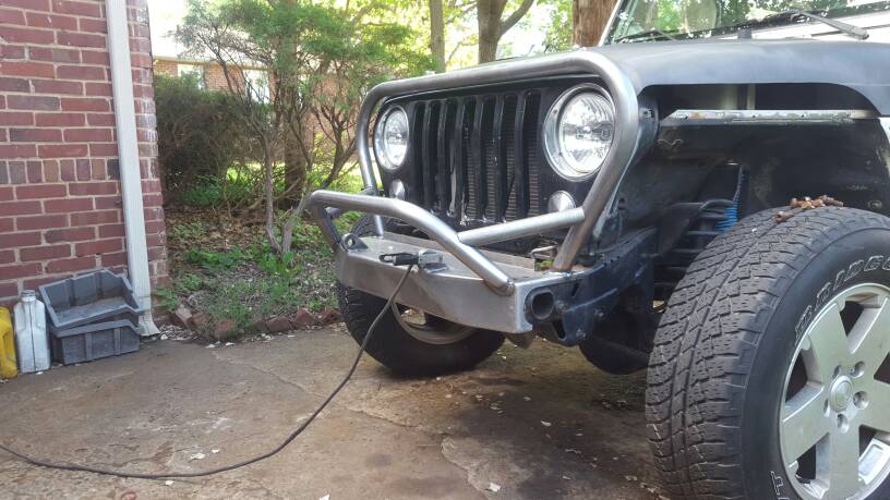

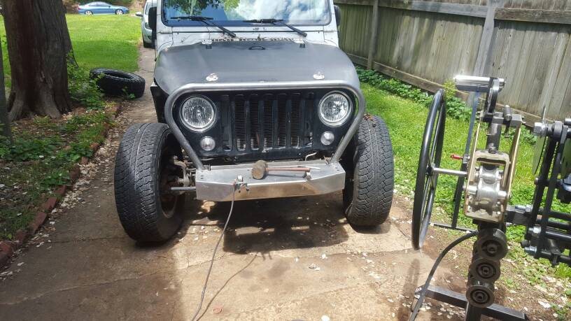

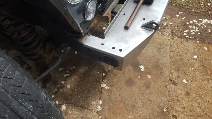

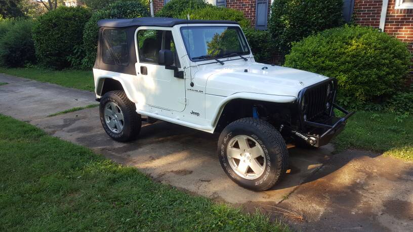

The other Barnes box contained, among other things, a stubby bumper. As long as I've had this thing it's never had a front bumper of any kind. I figure it's time. Main purpose was for the addition of front tow points. I also added some tube work as well.
Slight mod to the bumper to add some tube landing pads:
Bending up the grille hoop:
Grille hoop cut and tacked:
Pre-runner and supports:
Complete, with the fenders back on:

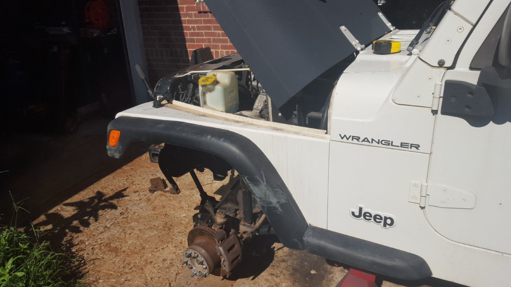

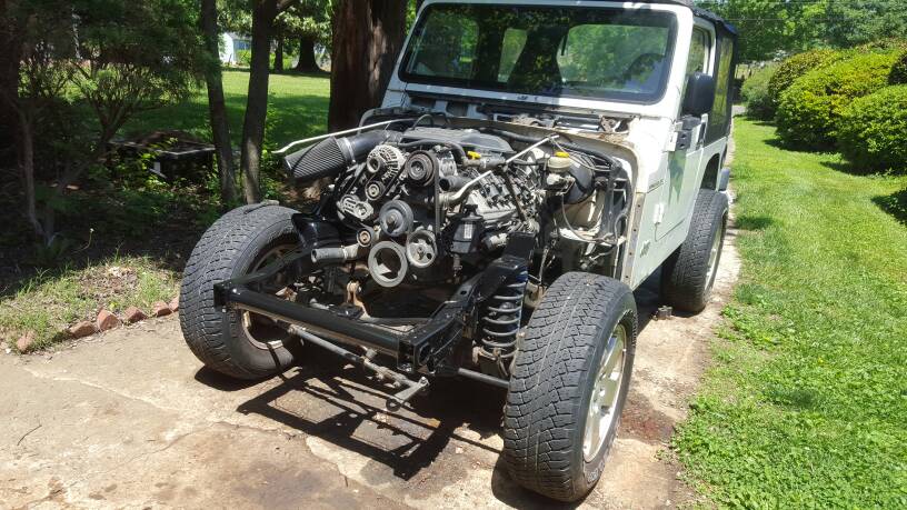

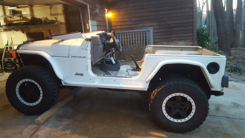

So this is how it's been sitting for a few weeks. Everything on the front end came apart for paint.
I took the opportunity to use the easy access to R&R the steering box because of a leaking sector shaft and rerouted my pressure hose to cure a leak cause by tension on the hose.
I also coated the front of the frame with chassissaver paint.
I just went to get the last of the parts from paint. Time for assembly.

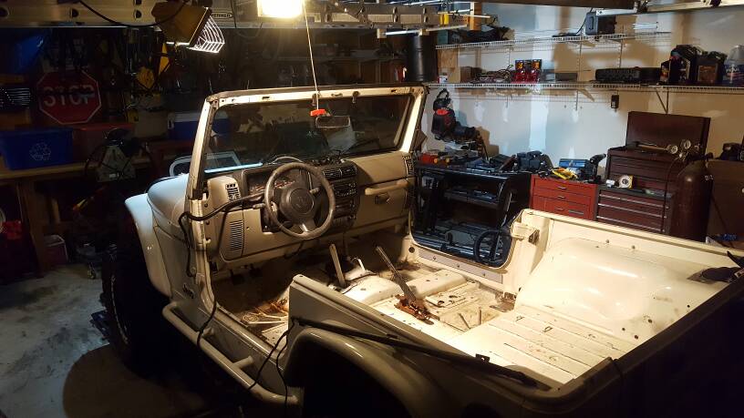

Here's what was accomplished over the holidays. Shout out to my friend Matt for the garage space to do the work, and most of the photos.
"Sportbar", old seats, and a bunch of dirt came out.

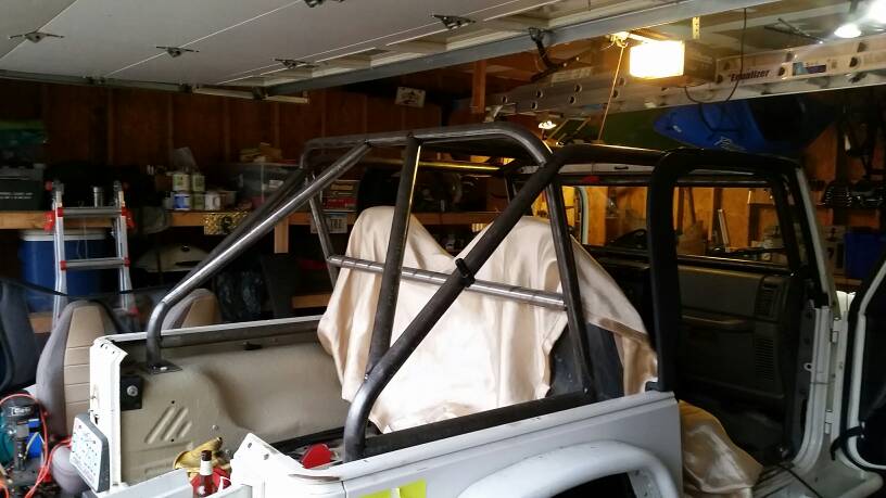

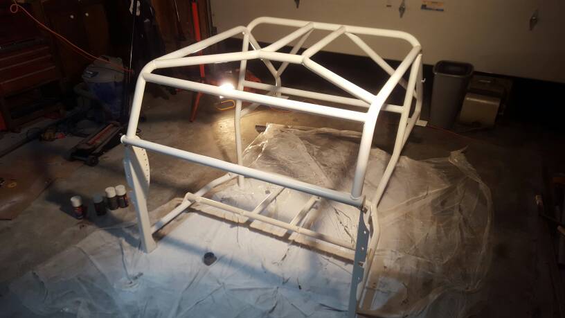

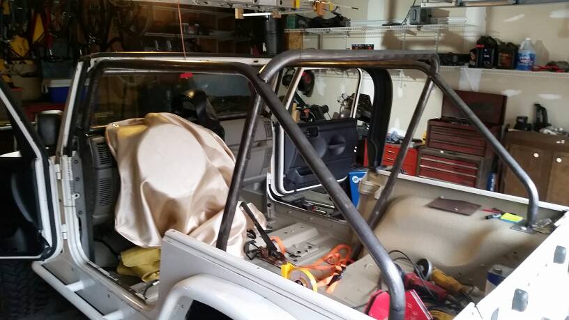

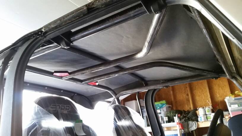

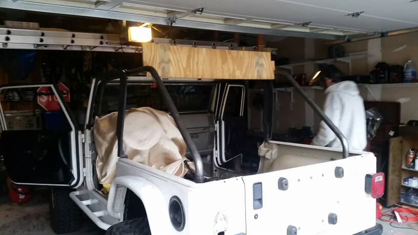

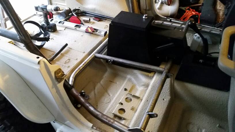

Started the cage with A to C pillar hoops, .120 DOM; fastback style.
B pillers dropped to above the frame rail for tie-ins

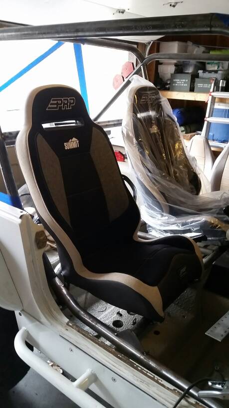

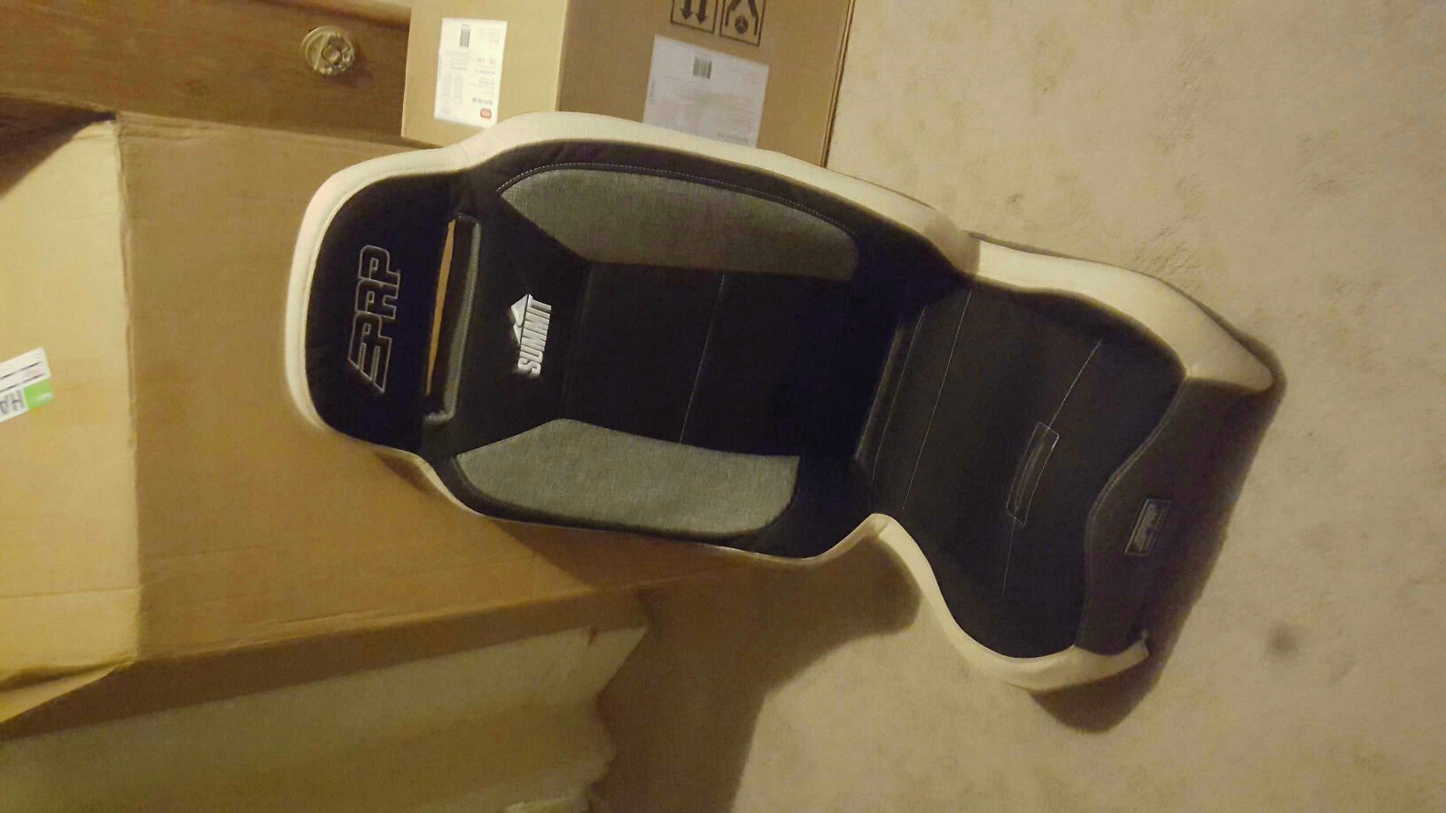

Seat mounts for the new PRPs. You'll notice in this pic that the tub has been lined with Monstaliner
A look with the seats and harnesses bar

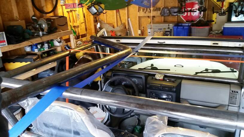

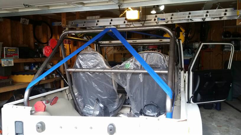

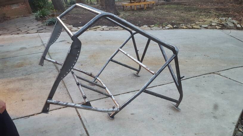

Blue tape in the last one was for laying out the triangulation tubes. You can see in this one (hardly) that I had laid out straight tubes meeting at the centerline for both the rear plane and top plane
After sitting in it with that layout, I wasn't happy with the head clearance, so we devised a new top plane tube arrangement.
Soft top still fits.
Then routed the rear plane braces to match
Still needs to be removed for final welding and paint; will hopefully get to that this week.

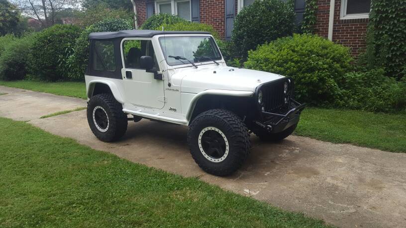

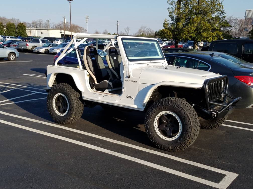

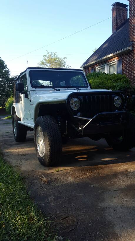

I spent the better part of February out of town... Hammers, Japan, and Texas slowed progress, but the heep made it back to the road today.
(Hardcore work parking lot pic)
Theres still some details to wrap up; I'll post some better pictures this weekend.

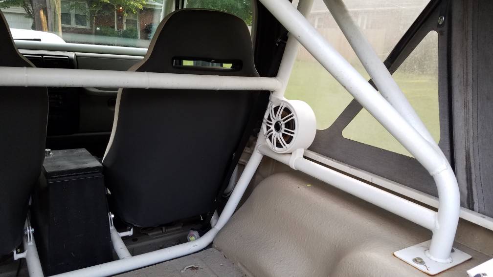

Not much going on with this thing as I've been messing with beater-deluxe Derelicte recently, but I did finally add rear speakers back this past week.

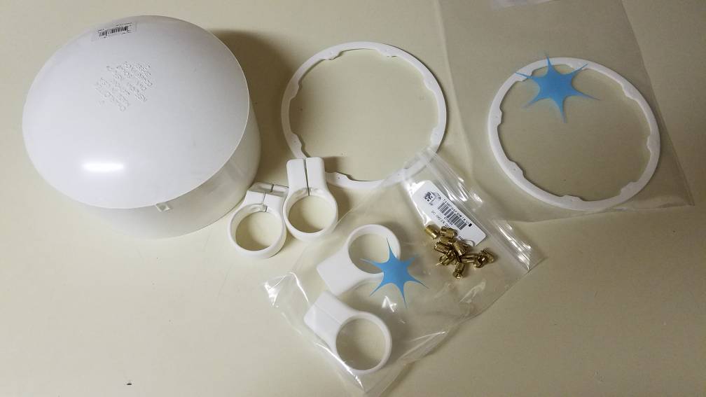

The sound bar obviously wouldn't fit with the cage so I made some custom pods. Thanks to the internet for the idea of using PVC caps and I designed up some roll cage clamps and had them 3D printed:
And yes, white speakers do look as douchy as I expected:

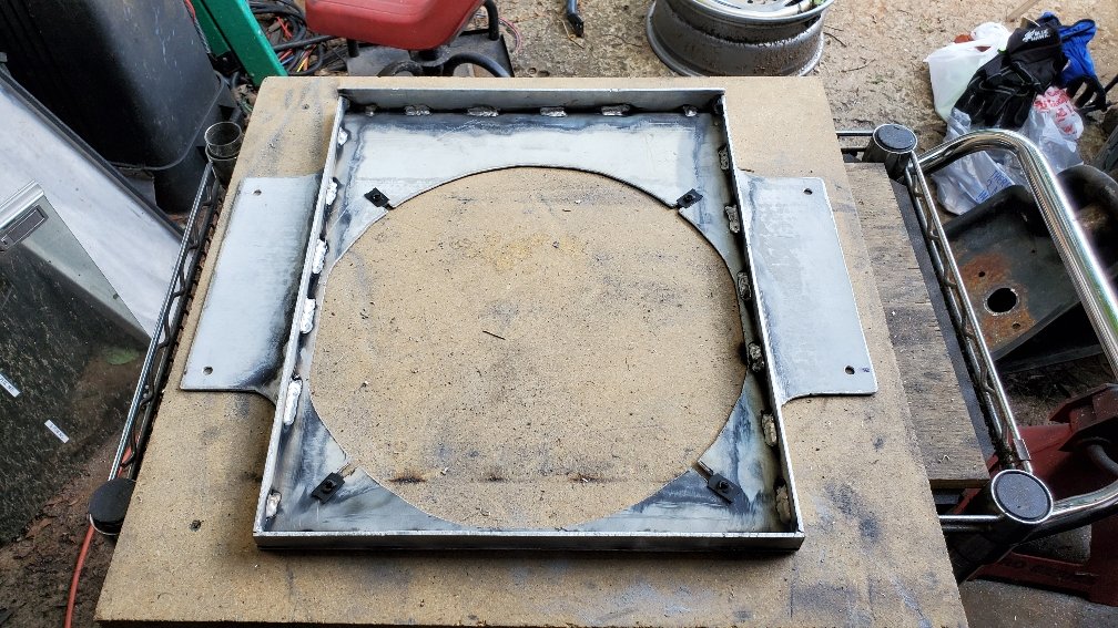

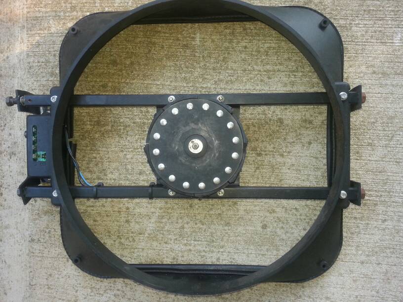

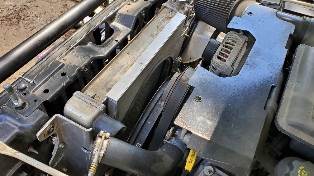

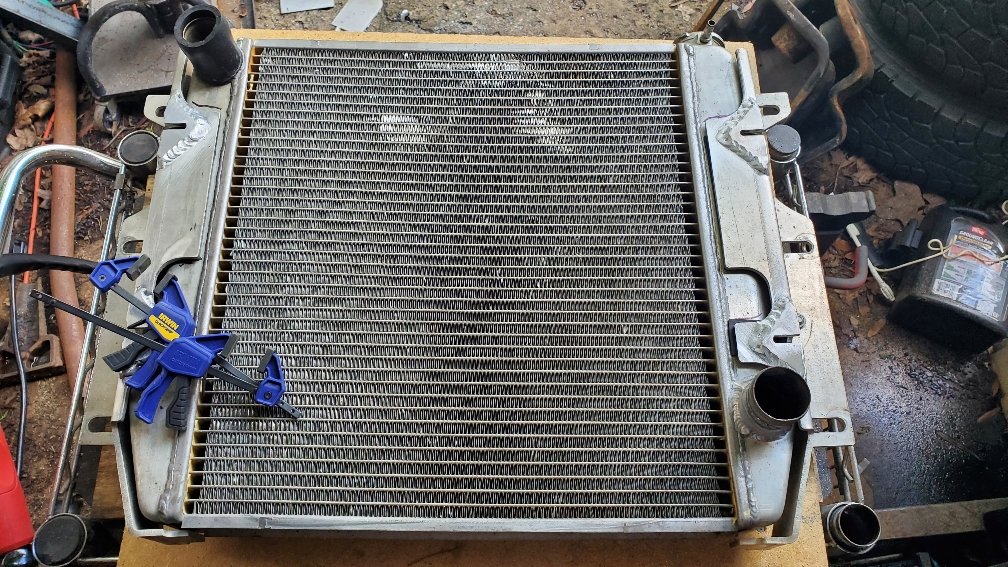

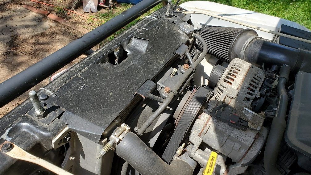

Back in June of 2014 was the first time the radiator fan let go, and last week was the 5th or 6th time it put the Jeep out of commission. It was always capable of keeping the motor cool, but the control and electrical were kinda half assed.
Here's what was there:

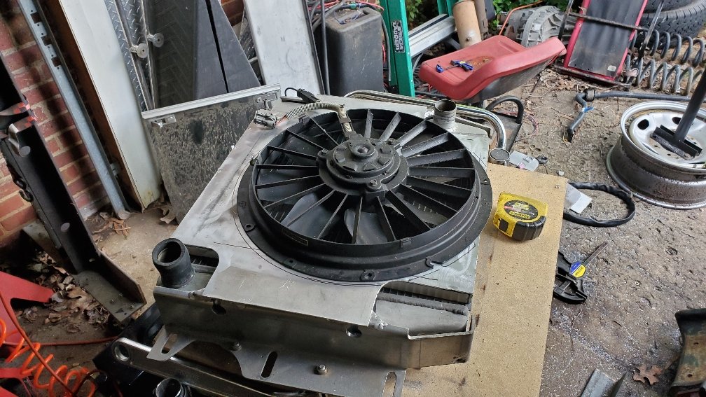

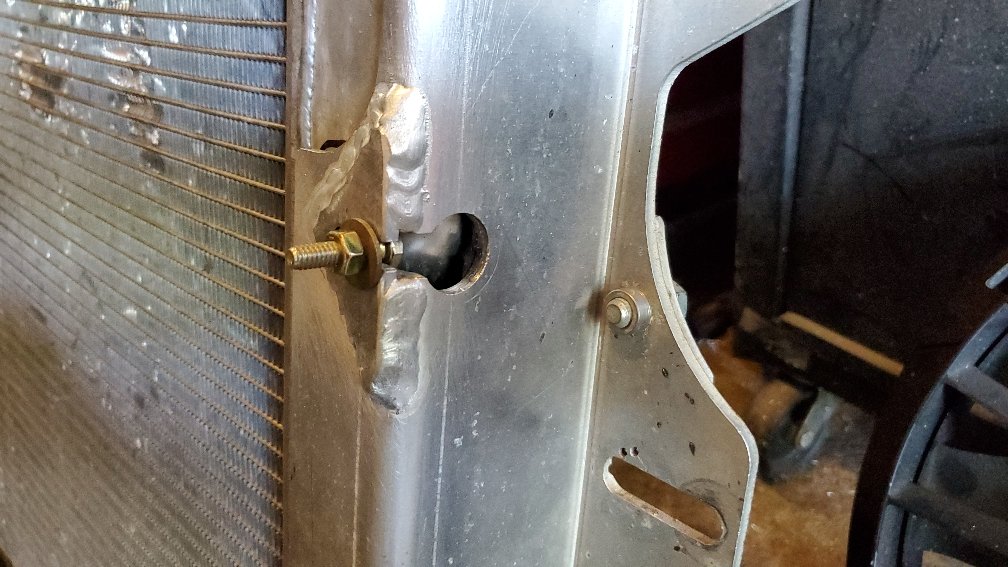

That box on the top with the knob housed the electronics. That's where it liked to short out and blow fuses about once a year. I decided to switch it out for a Taurus/Volvo unit with the OEM style electrical.
Mounting was kinda a trick with limited space. Added fastening locations to the radiator mounts to accept and constrain mounting bolts
That made the shrowd simple and flat.
Back in the Jeep... the fan has to go into the engine bay first, but not bolted to the shrowd, to get everything together.
