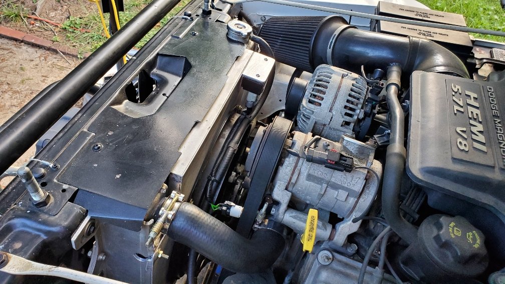

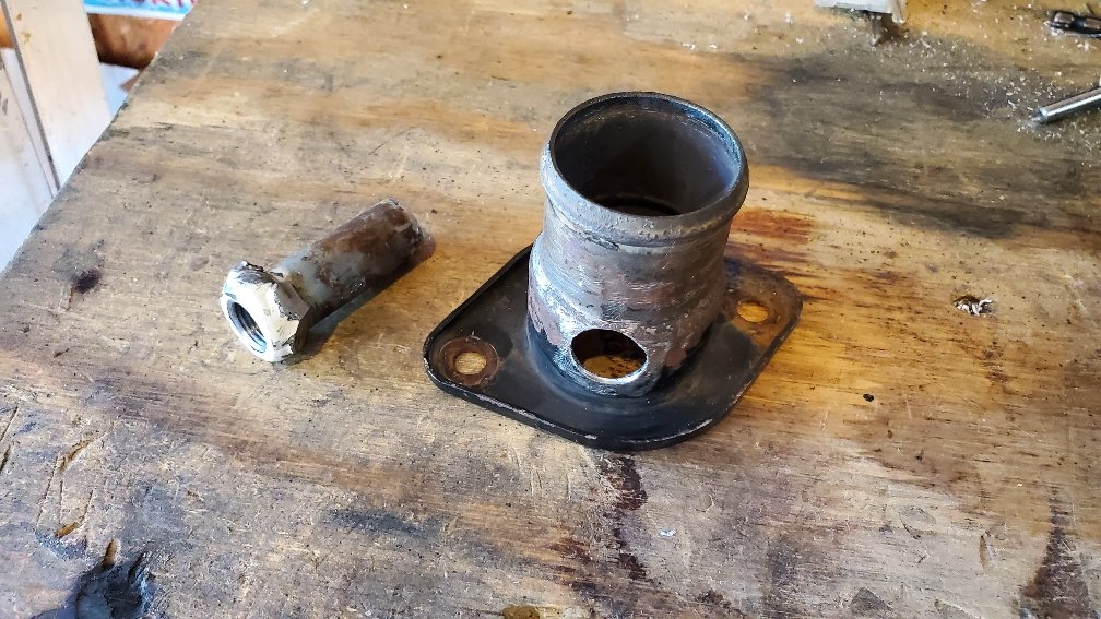

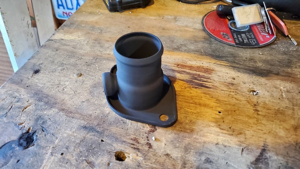

For control I used the BMW dual temperature switch. Luckily the thermostat cover on the Hemi is steel so it was easy enough to weld in a port.
You might recognize the port as a redrilled and tapped seat belt bung from the original cage - welded from the inside for lack of space on the outside because of the flange.

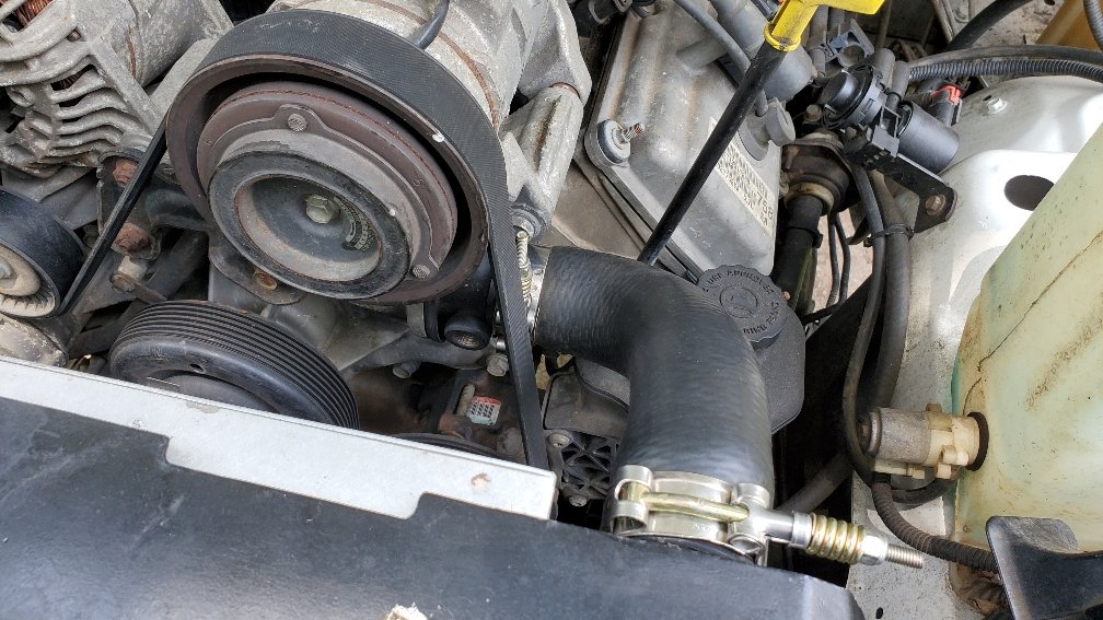

That puts the senor right out front of the block
Add some wires, and a bracket for the relay pack...
And its done.
