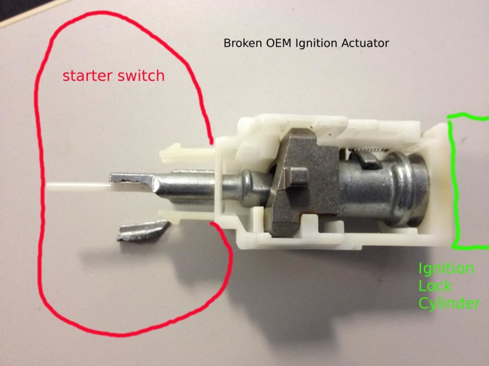

I had that issue a while back on mine and behind the key cylinder is a square plastic rod that goes into the ignition switch, mine had broke/wallered the slot out and was slipping when I was trying to turn it over to start, when you pull it the key cylinder and stuff out, you’ll see a little square switch, stick a screwdriver or something in it and cycle it through the positions and see if it’ll start.

Yeah I looked it and it was moving when I turn the ignition but I don’t know if worked good enough it’s orange right
That red circled piece is what’s usually broke. It goes into a square hole/switch that as the key turns it makes stuff turn on, engine start etc.

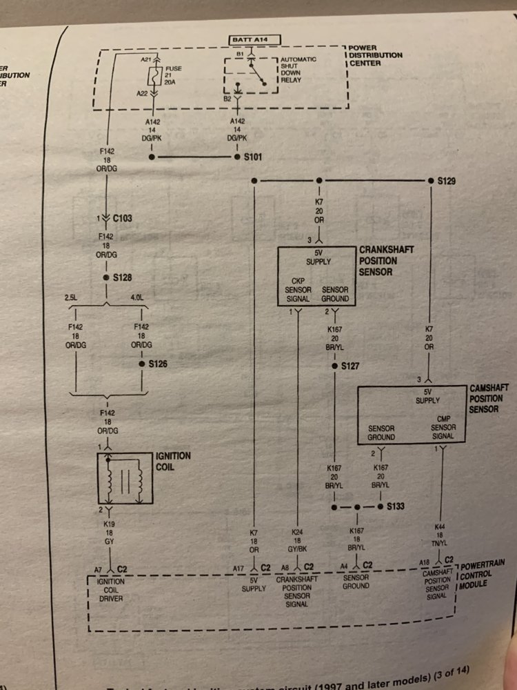

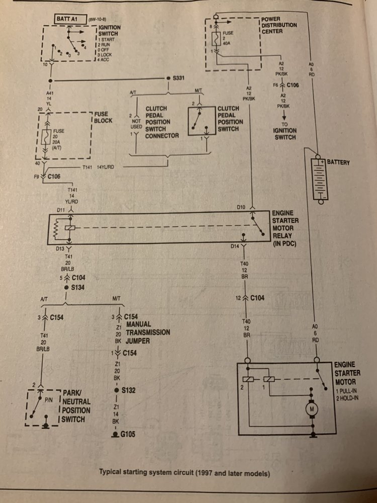

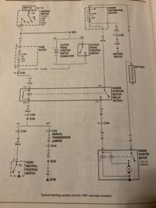

Switch is top left, that’s a wiring diagram. Idk if it’ll help you or not but it might give you an idea.

When you first turn the key on the ASD (automatic shutdown) relay should close & send 12v power to the coil & injectors. After 2-3 seconds the ASD should open & kill power to the coil & injectors. When you turn the key to start & the engine starts cranking you should get the ASD closing & 12v power back to the coil & injectors if the PCM gets a signal from the crank position sensor.
No signal, ASD stays open.
Also when the PCM sees a crank signal it should start pulsing a ground signal to the coil & injectors & it should start.
Check for each of these conditions & that’ll give you some kind of idea on what’s up.
