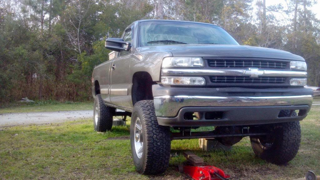

I started off with a stock 99 Silverado. 4.8, 5 speed, 4x4. Reg cab, long bed. Pretty sweet setup, really.
I added some aluminum rims from an 04 Silverado, intake, exhaust, dual e-fans from an 05+ truck, and a few other odds and ends. That got me to this.
I rocked that until this past January when I decided it needed a solid axle. Since I'm always up for over building stuff, I decided 1-tons were in order. I scrounged up a '79 Ford 60 to rebuild, gear, and lock. I got WFO to send me some crossover stuff, brake lines, and u-bolts. Out back, I sourced an AAM 11.5 from an 8.1 powered 2500HD, so it had 4.10s. I turned the rotors and bolted it to a set of 2500 springs that I got from the same truck. Then I slapped on some H2s I had with a set of Craigs Listed BFG ATs in the 315/70-17 flavor. Eventually I found some 2500HD aluminum rim center caps, but I still need to drill/cut the front ones to fit over the hubs and screw on the conversion lug nuts I bought.
Here's my rigs. Loaded up the Silverado to go get some pipes run under it :D
Here's how it sat shortly after I finished it up:
